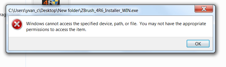

I downloaded the full installer (twice) and tried to install. I disabled my antivirus software, deactivated and uninstalled ZB4R5. I deleted all previous ZB folders. I also tried to run the *exe as administrator, but I keep getting the same error message in Win 7 Pro. Any ideas?
Thanks.
Please submit a Support ticket for that. Be sure to include your system info, including which version of Windows you’re running. Also, does your computer have a C drive?
