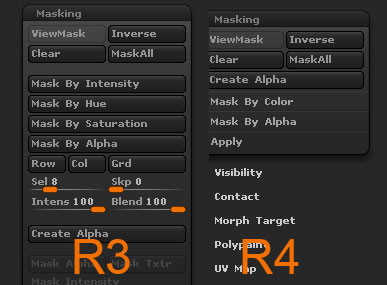

I´m missing the very useful masking options for parametric models in 4R4. Is the mask row and col funktion removed?

Click on Tool > Masking > Mask By Alpha and those options will appear.
Thanks zber2!
