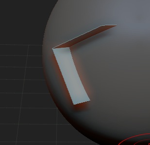

When I use Alt with an insert brush to subtract with dynamesh, the inserted object comes in with its faces flipped
