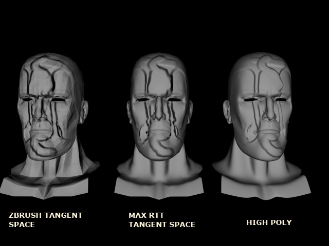

Check the attachment. If your beasts are hungry, you might want a test case - let me know what they digest best.
Hey speedym - Not sure I understand the first thing. Is there a question about the attachment that you have or jus showing. :slight_smile: Why is the zbrush one faceted?
Sorry for being unclear - I can provide a test case where zmapper tangent space normal maps are bad (often with lots of seams) when rendered in MAX 8, using the profile from the 1st post in this thread. I wonder how that profile worked at all for people who tested it because mathematics, MAX code, and my fiddlings with it say it cant work well, assuming that zmapper produces maps with orthogonal tangent space basis only, which was ok for MAX 7.x, but is simply wrong for MAX 8.
ps. Object space normal maps are cool, ofcourse.
ZMapper works in several studios using Max 8. I have worked with several of them on this. By profile I assume you mean the zmapper configuration. If you are not getting that to work I would love to see the problem. Chances are it is being applied to the wrong material in Max as i believe there are several ways to deal with normal maps in it or some steps are being missed in Max. I would really like to get a normal map guide going along the lines of zmapper but we haven’t had a chance yet.
As to the math of it all. ZMapper is an OpenGL application with its own normal map generation routines. It is quite separate from ZBrush 2’s routines. While the math of ZMapper is beyond me I believe your assumptions are not quite correct. I believe we should look for any problems you are having in the configuration and the steps that are taken in Max. :slight_smile:
