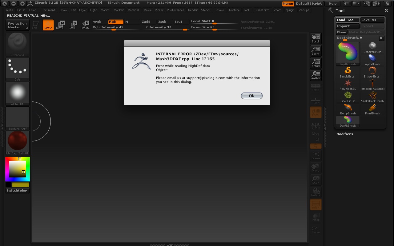

I am crashing too, anytime I open a current project I get
"INTERNAL ERROR /ZDev/Fdev/sources/Mash3DDXF.cpp Line:12165
Error wjile reading HighDef Data Object."
After getting this a couple of times it will crash like if it was reading a million polygon model with no highdef polys.
here’s a screenshot:
The same thing is happening to me…
