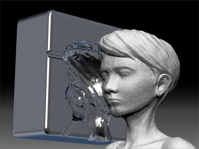

For Geert Melis, subeject: Think positive? Try Negative!
Can you make a fool proof guide on how to do those awesome negative “molds”??
Thanks a lot, you rock

Hi there,
Geert Melis showed an image of a Mold at the end of his tips. I tried to reproduce that.
I have a cube in the first layer and the demo head in the second layer set to subtract. When i hit the remesh button i always get my original Cube, as if ZB doesn’t see the second layer (yes the layer’s visibility is switched on).
Any ideas?
Thanks in advance for any help.

You need to make sure the subtool remesh icons are set correctly. If you don’t want a symmetrical remesh, turn off the options on the Remesh button. Also, the order of the subtools can affect the result.
A tutorial on this will be posted as soon as possible.

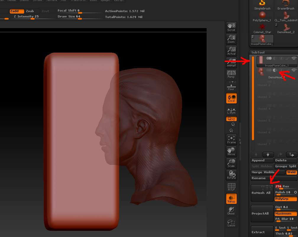

Tips and Tricks. Geert Melis doesn’t explain how this is done. Just pictures of it. I did it before, but now I’m back in zbrush I seem to be missing some step cause I have tried masking, yet the subtool mesh goes right through it instead of forming to it.
http://www.pixologic.com/docs/index.php/Geert_Melis
This uses the Remesh All button.
In my example:
  1. The polycube is the top & selected subtool.
  2. The head subtool has the ‘Subtraction’ operator selected.
  3. The Remesh All button has symmetry turned off.
A higher Res slider value, say 512, will mean more detail is captured.
