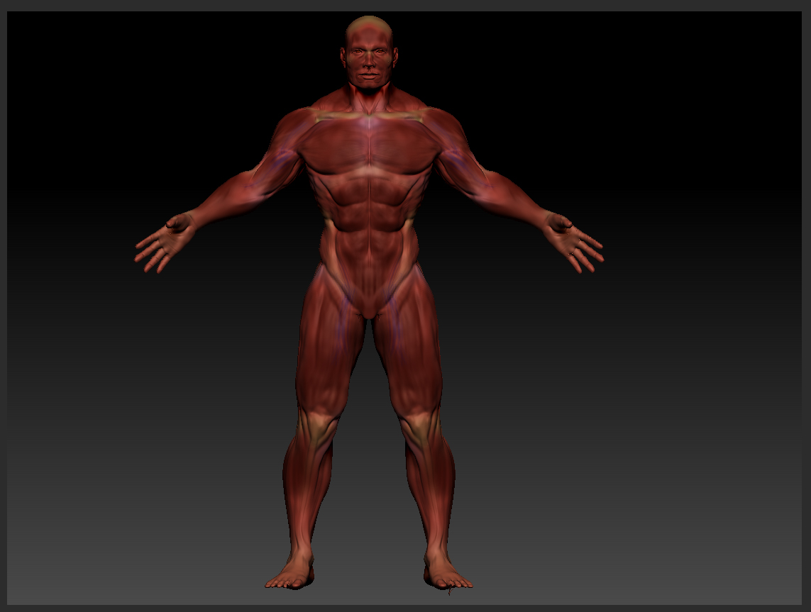

I done my poly paint in subdiv 7 and when i click the button new from polypaint under the texture pallete, i got this texture with box around which is not smooth.
How do i solve this kind of problems ? :o

it still doesn’t work even i increase the texture resolution… i using 2048 x 2048 and i have 2.201 mil activepoints there~~even i have tried on the 4096 x 4096~ it still come out the same result~
is that i did something wrong on setting ? cos the texture keep come out like having boxes. i can’t figure out how to solve this~

i just reimport my model, and i reopen UVs and also check back the normal~
i guess it’s like what u said about the normal stuff~
because this time i was doing a model start from zbrush everything and i not get use to zbrush normal so i think i accidently click it while also first time using uv master~!
thanks alot for ur reply~! it helps me fixed my problems. thanks~! :lol:
