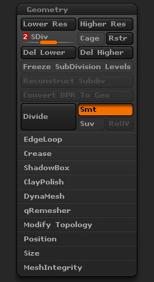

I’m currently learning how to use Zbrush and am watching tutorial videos however their layout under geometry is different from mine. I have the divide tool but no subdivision slider, and I cannot undo division by pressing control + D. Is there a way to undo division without control + Z? Also this is what I’m seeing.
This is what I’m supposed to be seeing, right? It even shows up that way under the Zbrush documentation reference guide on website.
You don´t see the SubD slider because you have a parametric object on your canvas, click Tool>MakePolyMesh3D.
You have a ZBrush primitive selected in the tool palette. Most of the default 3D objects in the Tool palette are primitives. The primitives are parametric objects that are not ‘fixed’ in shape - you can change them by altering the settings in the Tool>Initialize sub-palette. You can’t sculpt a primitive which is why the palette options are not the same. To make a primitive sculptable press the Tool>Make Polymesh3D button (at the top of the Tool palette).
To get started with sculpting just load the DefaultSphere project from Lightbox. The palette arrangement will then be as you are expecting.

Because you had the smooth modifier on when you have subdivided the mesh. If you turn Smt off and do the same operation it does not change its form.
Right sorry had a brain fart. After you said that I just realized I learned that not too long ago but didn’t see much point in it other than having a really soft looking cube or something like that. And then dividing without Smt on then turning it back on to divide gives interesting results but Sorry to bother you and thanks for the response! =)
