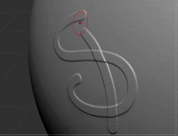

Any help, tips or tricks to help accomplish this would be greatly appreciated!Capture13.PNGCapture11.PNGInkedCapture12_LI.jpg

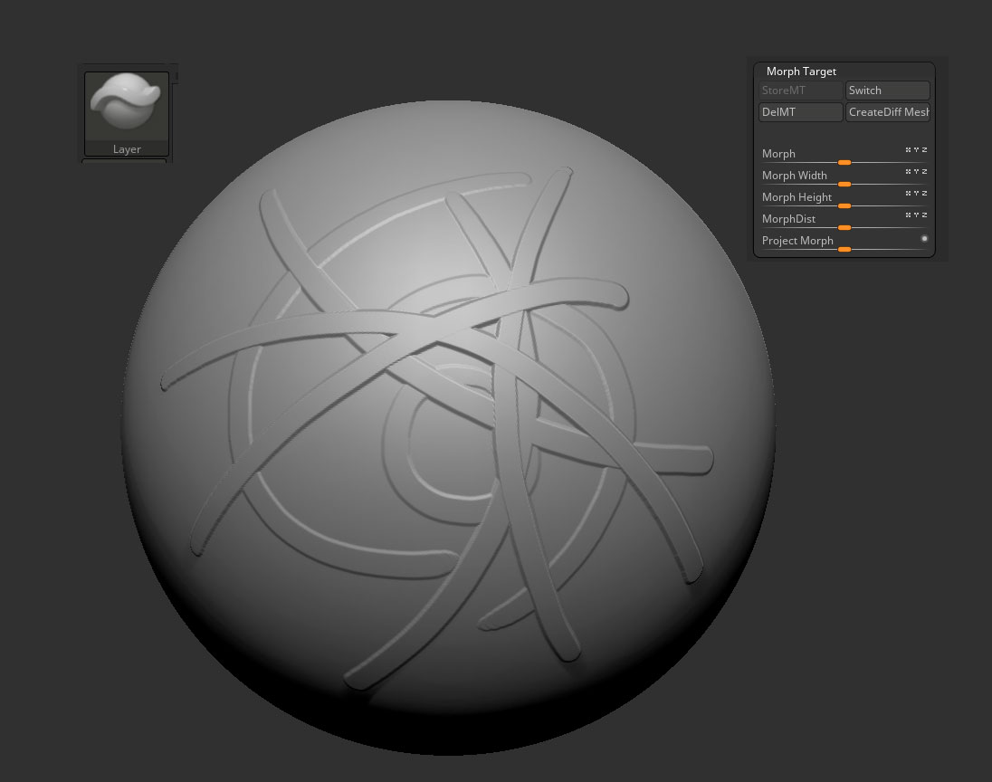

For something like this, try the Layer brush with a Morph Target stored:
  1. Press Tool>Morph Target>Store MT.
  2. Select the Layer brush and draw part of the design.
  3. Before drawing more of the design, try changing the Z Intensity so the lines are higher or lower.Layer_brush.jpg
