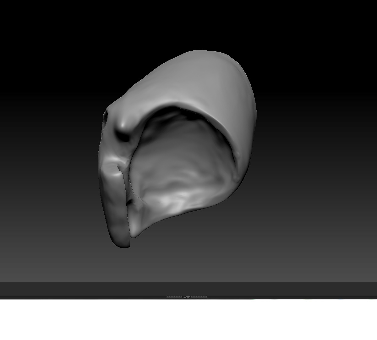

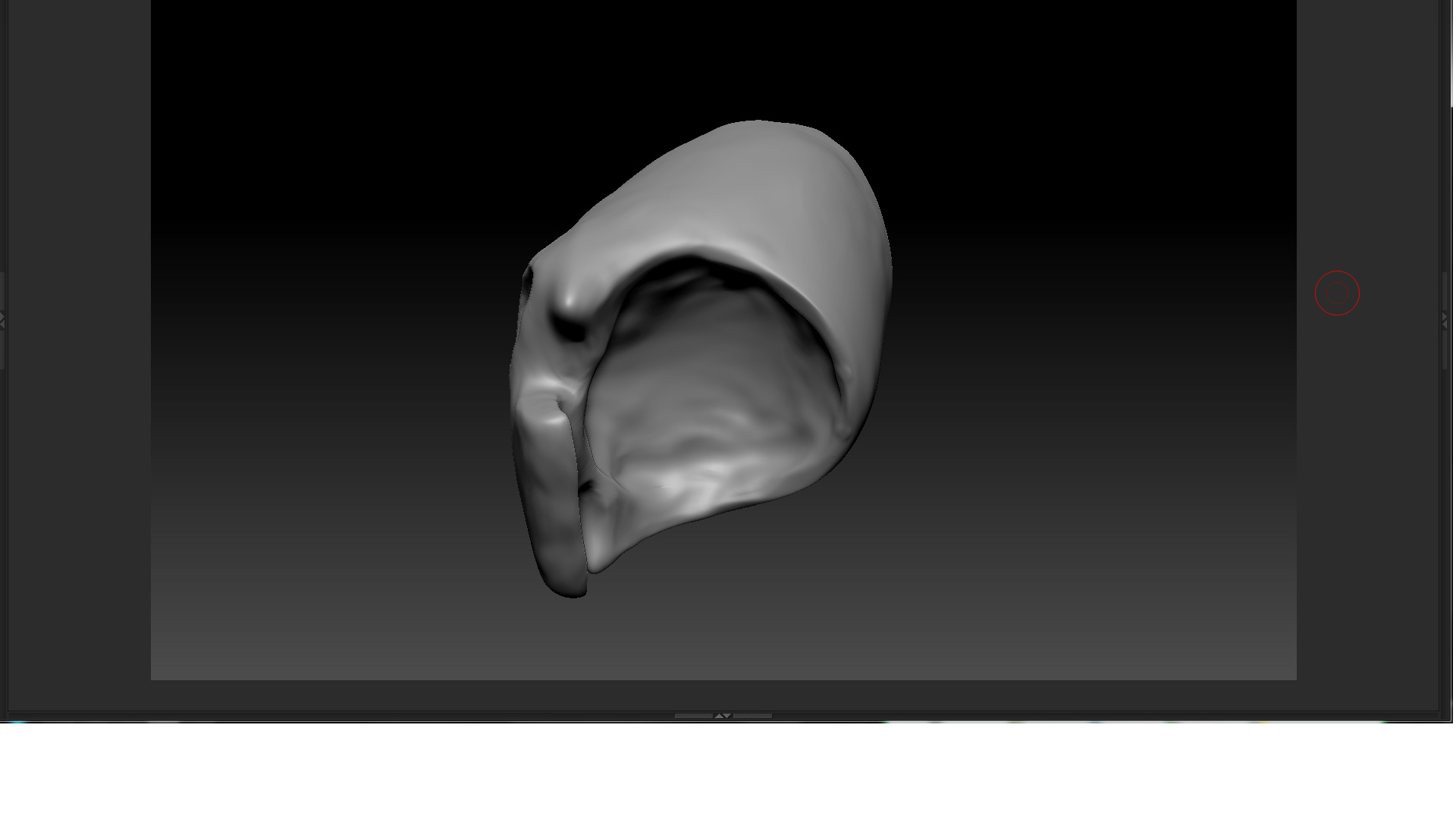

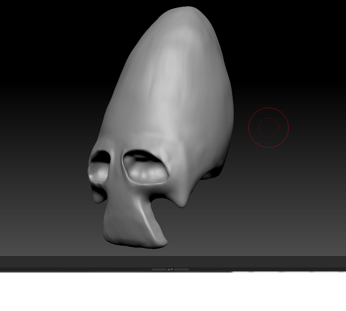

Here are 2 pics of what im working on. I realized that the skull doesn’t have to be completely hollow but just enough to get by the eye sockets. Also is there a brush that will allow me to completely remove polys from inside the eye socket to allow visibility through the eye socket.

Hi Xaero,
Now I see what you are accomplishing. You want the skull to be hollow so there is no mesh blocking the eye sockets thus allowing the view of a more authentic skull.
I have two methods or suggestions:
To get rid of the mesh which is the back of the eyes, use subtractive dynamesh again like I described above. Use a sphere as a new sub tool as if they were eyeballs placing them in the sockets and resizing them to only take out the back portion of the mesh.
You may need to use the move tool reshape the sphere to the overall eye socket shape.
Check out YouTube for subtractive dynamesh. You can keep the project button turned on in order to preserve any detail on your model just make sure you use a decent polycount number to accommodate the detail.
Another method is too use the select rectangle (control+shift and sometimes alt) to isolate the eyes so that you can see all around eyes with nothing blocking the back.
Switch to slice curve and slice off the thin back portion of the mesh. This will create a polygroup(s): one of the skull and the thin back portion of the eye(s).
Next go sub tool sub menu, under split, click groups split. This will turn all polygroups into their own sub tools. Delete thin portion of the eye sub tool and then you will be left with your skull without the backs of the eyes.
A warning here… if you have existing polygroups, they will be subtools too. If its convenient you can control + w and make your entire skull a single polygroup so that after the slice you are dealing with the skull and the thin eye backs
OR you go ahead with operation and just merge all the subtools back together however the caveat is that once you merge them back, you loose your polygroups.
Not sure how your model is being developed, so the warning may not even apply.
Experiment on the duplicate subtool to see how things work out.
Hope this helps!
