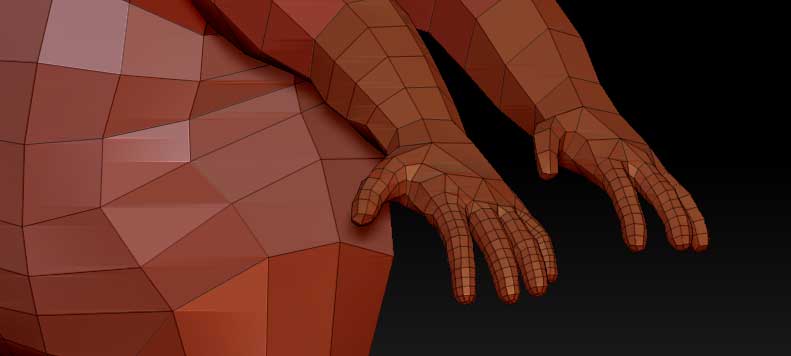

I have a character where the mesh is too dense at the head the hands and the feet. I´m using Qremesher to get a more accurate mesh density for sculpting the details. That worked fine, but now I dont´t have a mesh with lower subd levels for posing. Can somebody give me a hint what I could do?

I tried that but it does not work with the same polycount. Even with masking the head and hands. I get good results with higher polycount and reproject but than I don´t have a lowpoly model for posing.

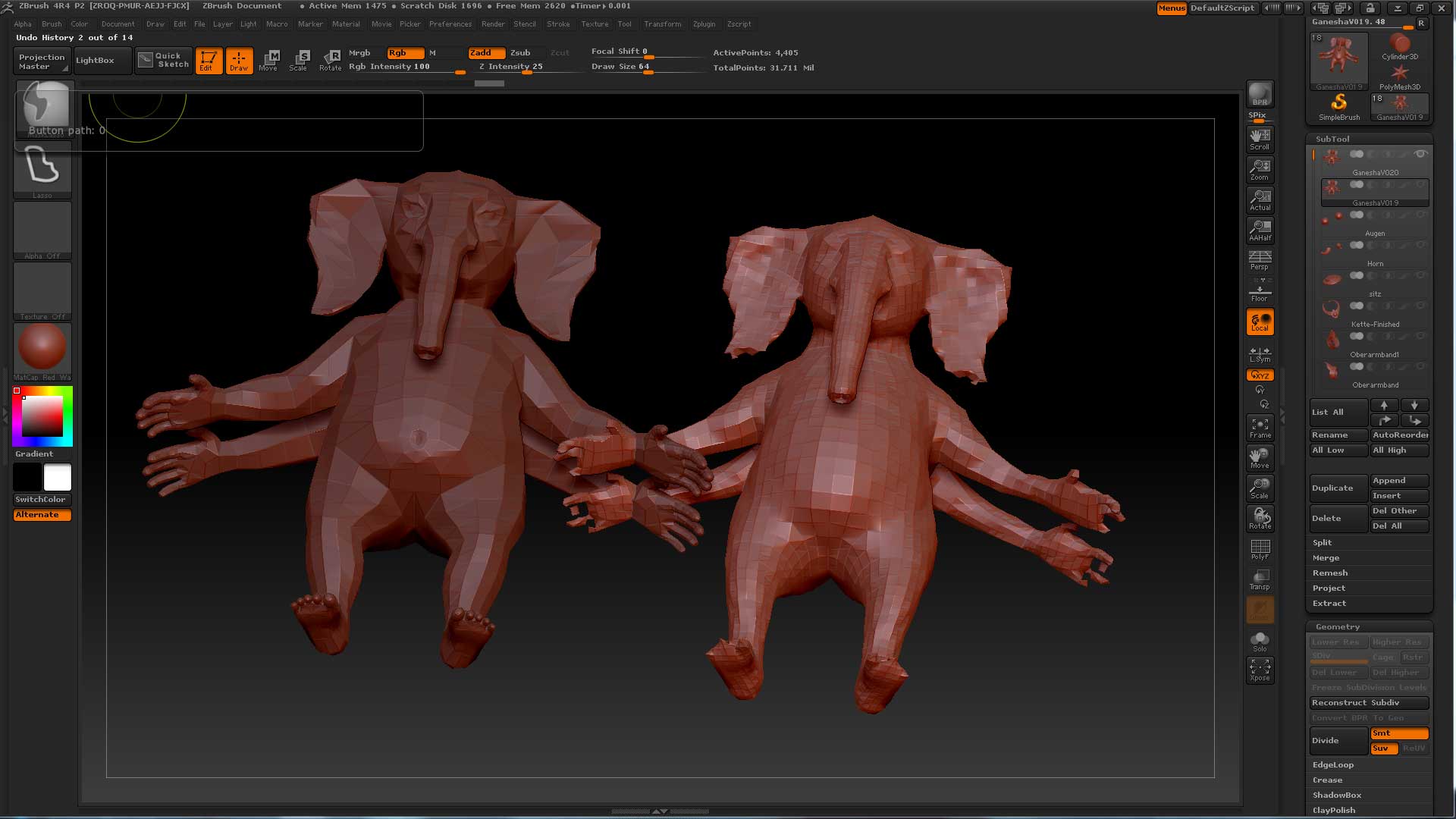

Both meshes look pretty much fit to pose and sculpt to me?
Qremesher is supposed to create a new base mesh, which you’ll probably want left at a lower polygon count if you like being able to make broad changes. If you keep it low while using subdivide and project like Andre suggested, you should be able to step back down to the lower subdivision levels afterwards in order to pose the mesh.
If you’re not getting a good result with qRemesher on lower polygon settings, make sure Automasking is on (even if you’re using manual masks), and if that doesn’t help, adjust the mdensity slider. You could also try adding guide curves to help control the flow in trickier areas in order to get a better result.

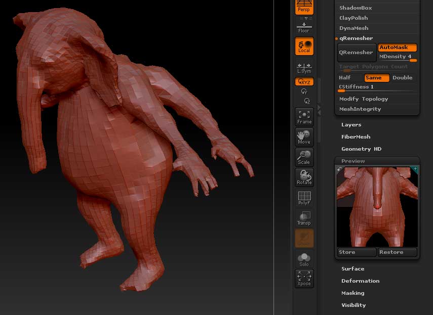

I tried masking but it looks like Qremesher can not handel the difference between my very dense mesh at the hands and the lower mesh resolution at the body.
I don´t know what you mean that both meshes look fit to sculpt. I think the remesh on the right looks like trash.
It could use a bit more density around the fingers, but other than that it is sculptable and posable. What is your density slider set to?
If the result on the left is the original mesh I’m not even sure why retoplogy is even needed? If you feel an area is too dense, have to tried removing the extra edges the old fashioned way? (zspheres)
Density was set to 4. I want to remesh it to get some more geometry on the body to sculpt the details. The model has 14 million polys so I can not subd again. But I think I can go with it because I don´t plan to render closeups. It´s my first Zbrush character model and I´m not sure how much mesh resolution I need for my renderings.

MAH, I tried what you have suggested.
  1. changed subd level under 2 million points (somebody told me Qremesher can not handel models with over 2 million points)
  2. increased the model size to 200 %
  3. freezed subdivision levels
  4. masked hands, feed and face
  5. Qremesh-keep same poly count
The result is still a mess.
It looks like Qremsher can not handle such a huge difference of low poly and high poly in a single mesh. At least it can not handel it on a low subd level.
I was successful on a medium subd level but than I don´t have my low poly mesh for posing.
