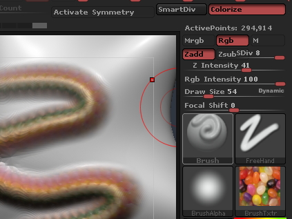

It doesn’t seem to be a problem:
OK. Thanks Altea. I’ll have to re-initialise and try again. Maybe I was trying to run before walking here (loading
up my transparet texture). I’ll try what you did and stick to basic brush and tex (to start with).
