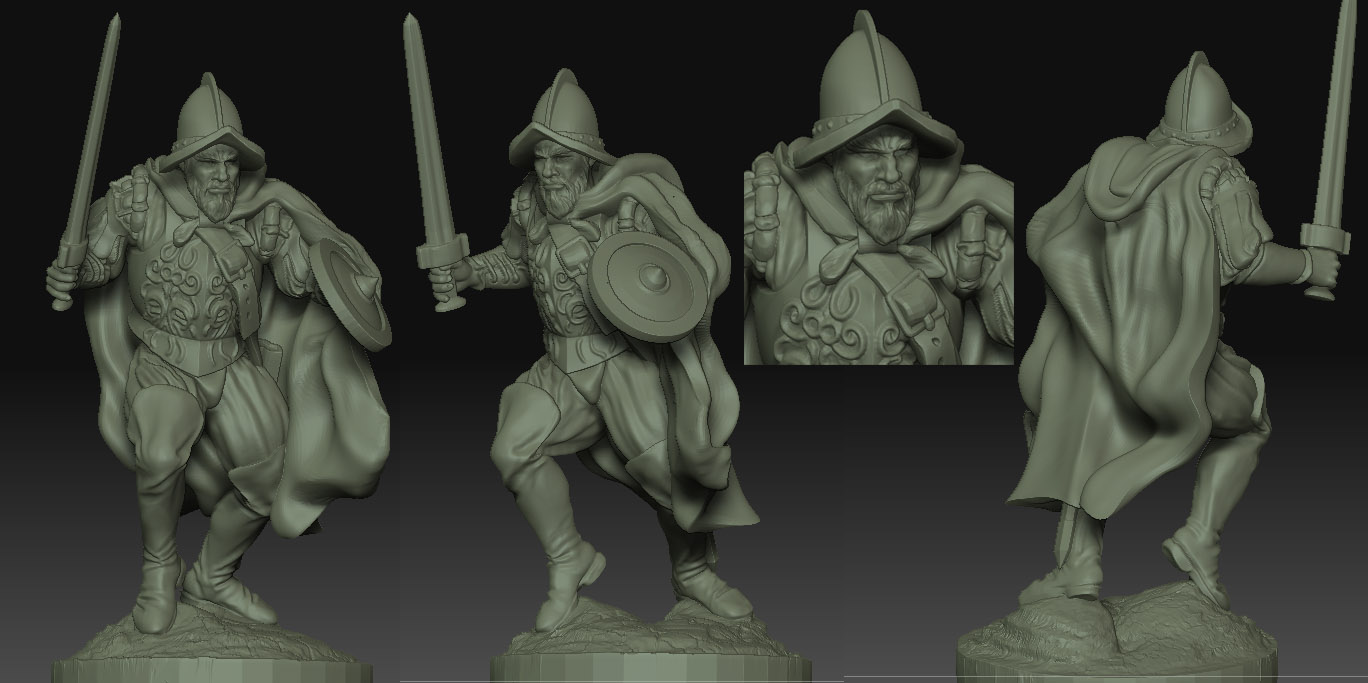

[[attach=199307]tn_reaver2.jpg[/attach]](javascript:zb_insimg(‘199307’,‘tn_reaver2.jpg’,1,0))
the reaver
[[attach=199308]reaver.jpg[/attach]]reaver.jpg
Rogue
[[attach=199309]rogue.jpg[/attach]]rogue.jpg
The Cleric
](javascript:zb_insimg(‘199310’,‘cleric.jpg’,1,0))
thats all for now.
