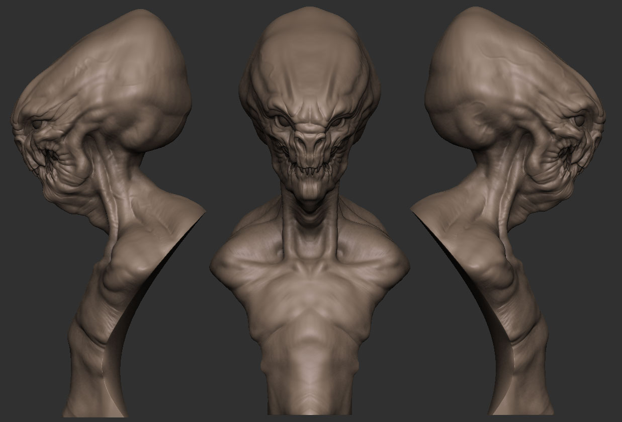

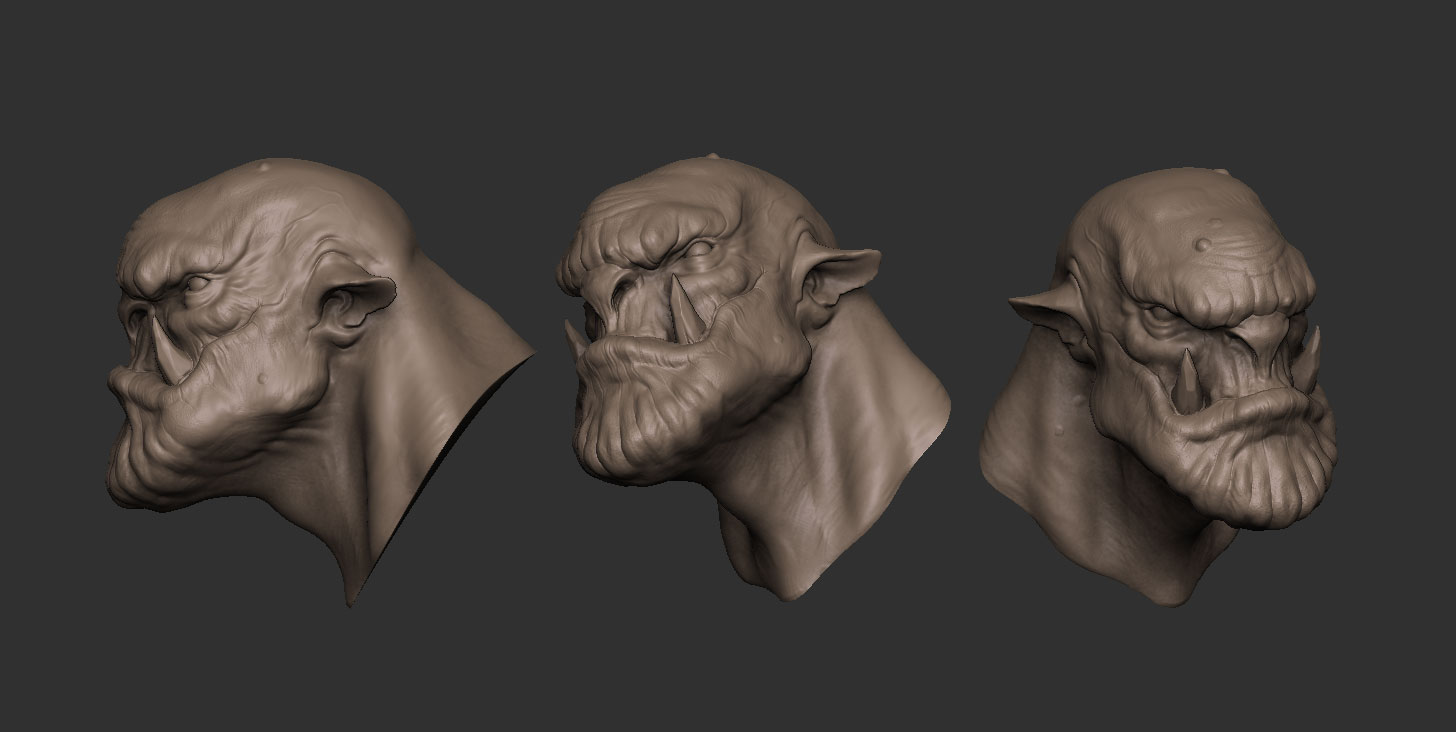

Some of my fumbling so far:

This was all dynamesh, then the last iteration was fairly high before i turned dynamesh off and divided twice i think. The mesh is astronimcally huge…26 mil huge; however when I try to decimate, Zbrush crashes every time.
Did I go too far with the divisions? the resolution on Dynamesh? otherwise somewhere?
