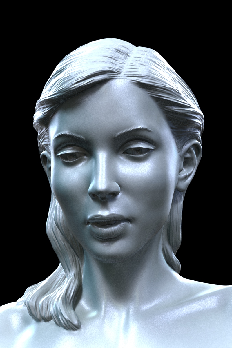

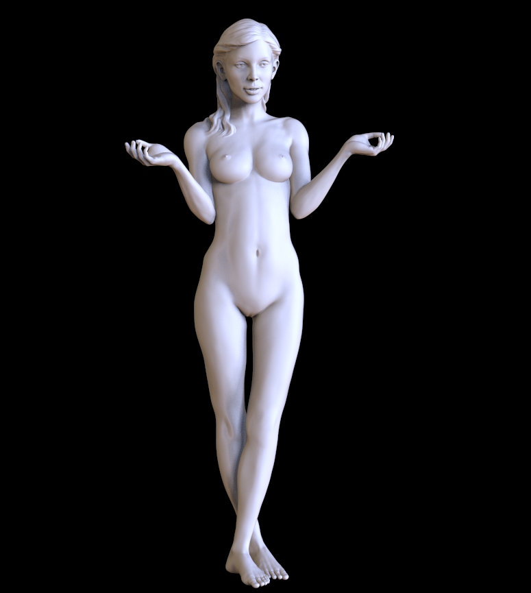

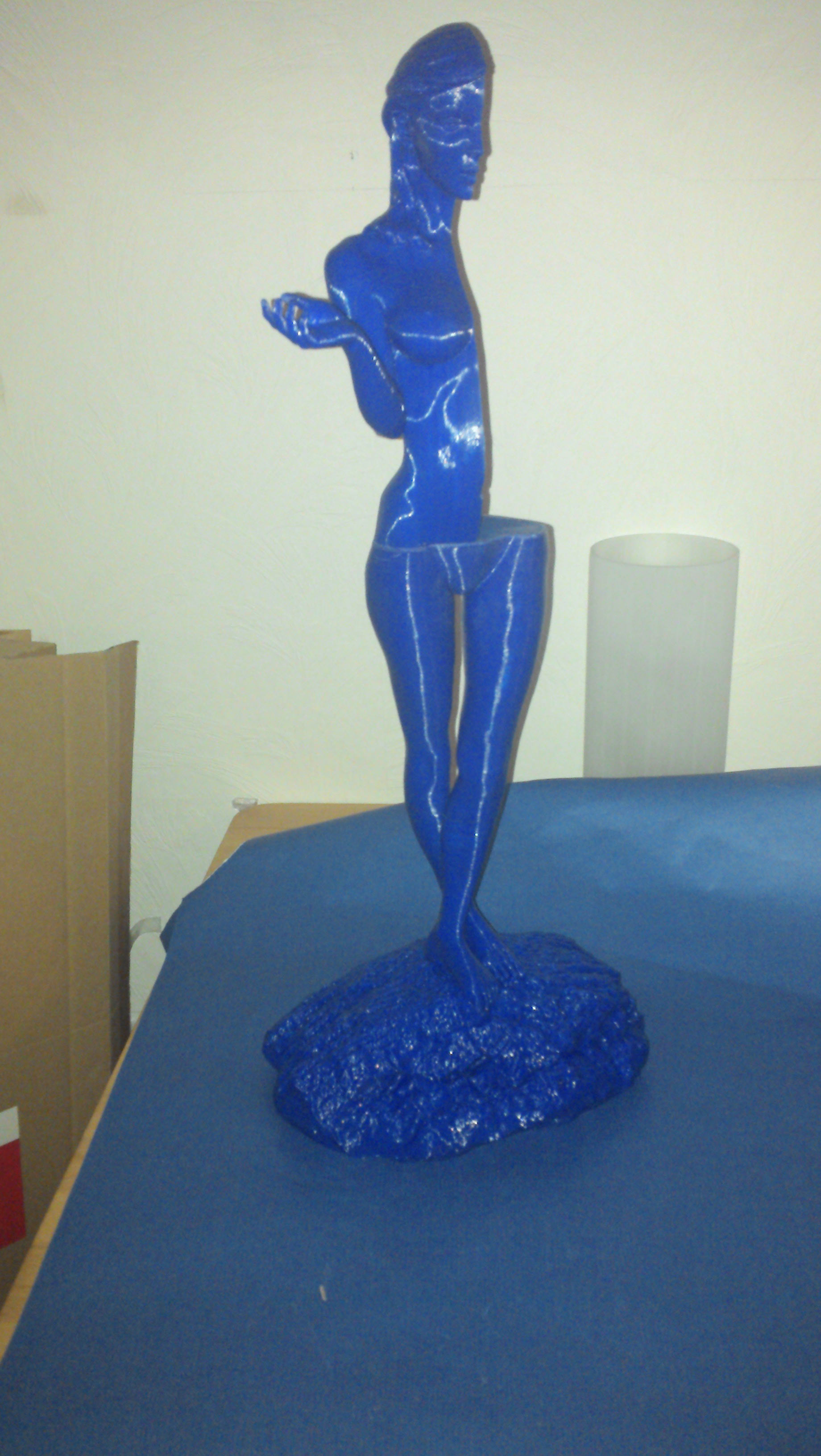

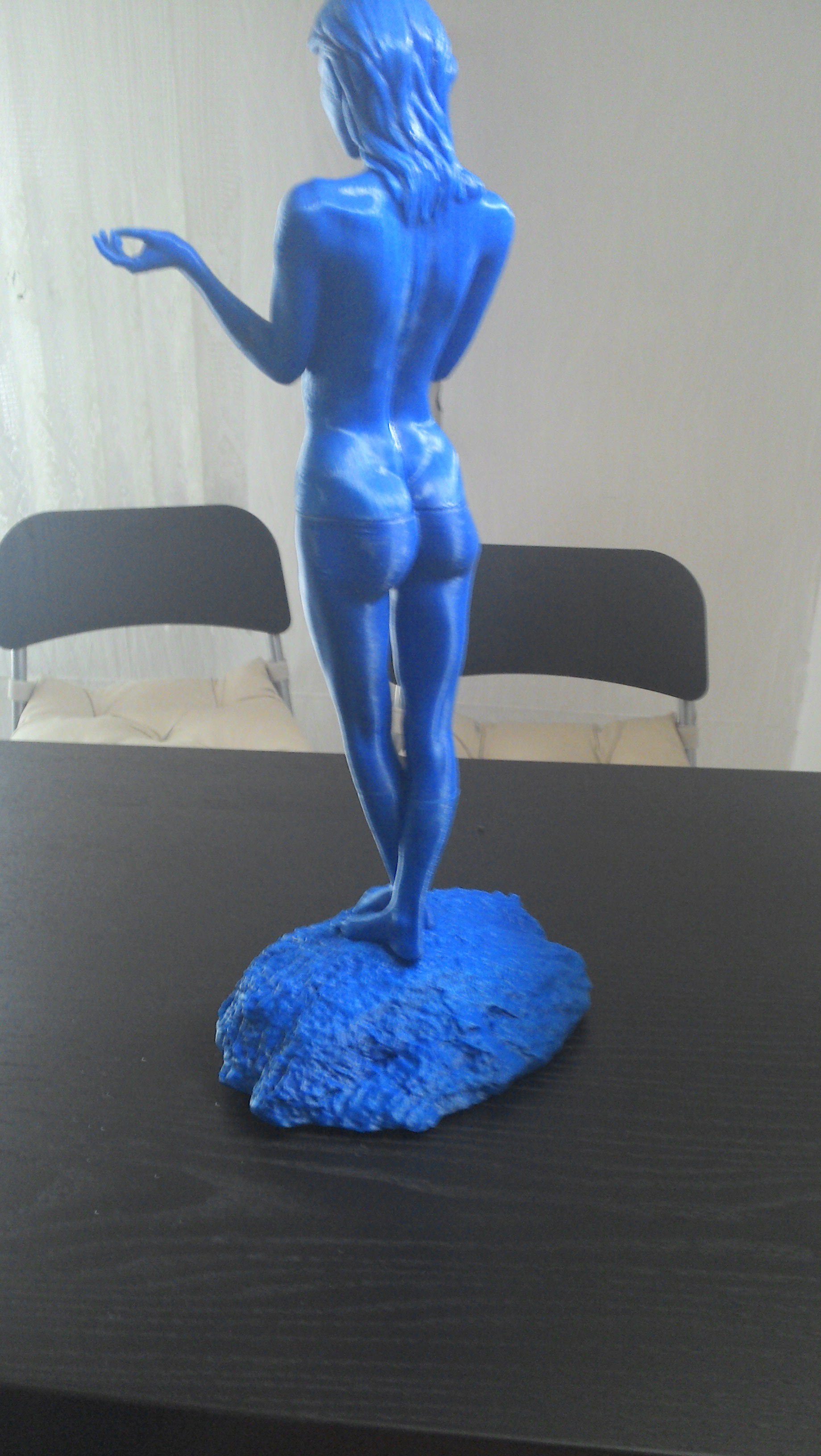

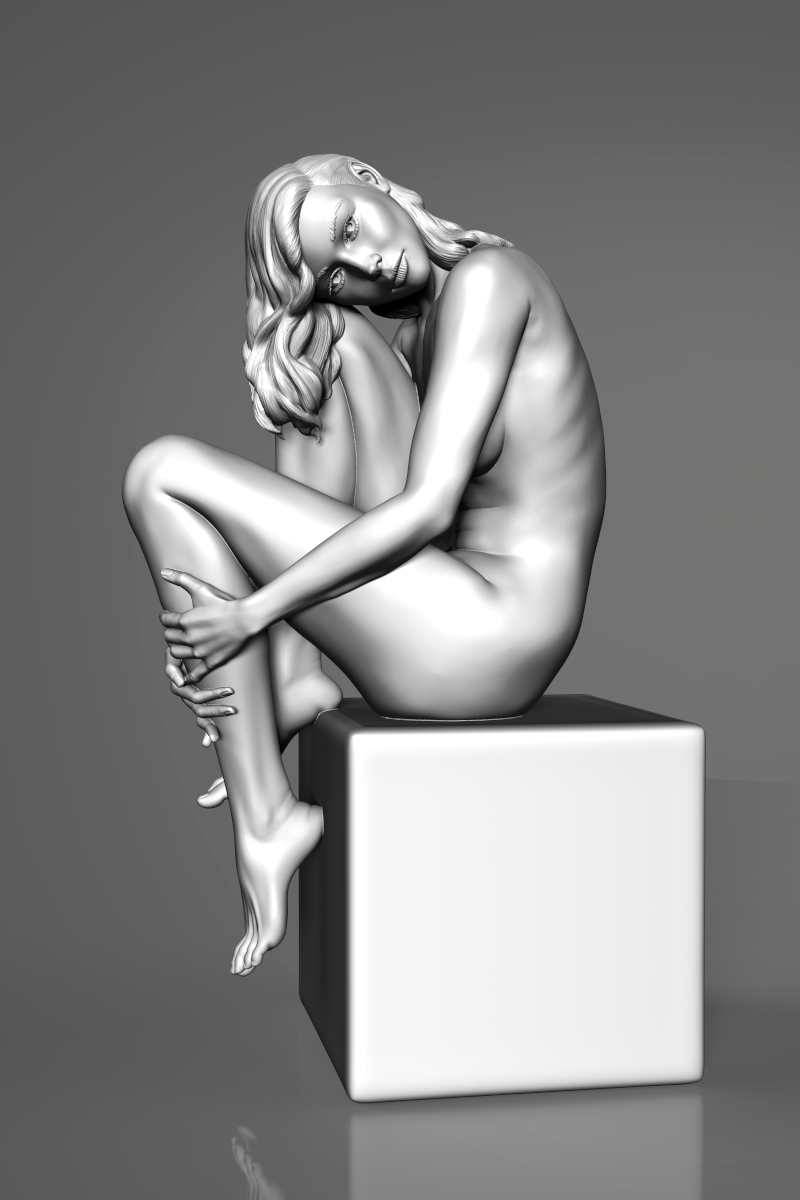

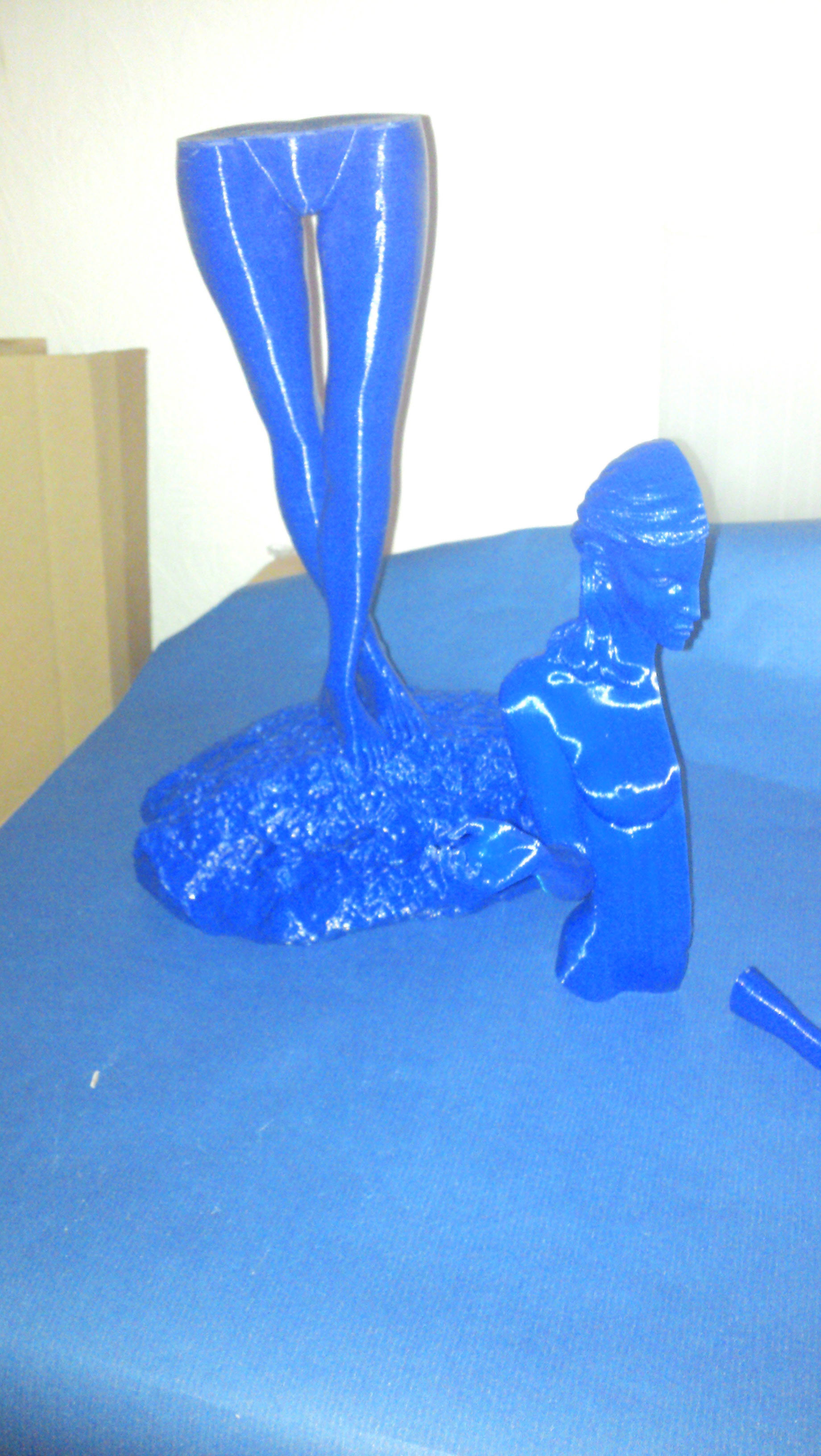

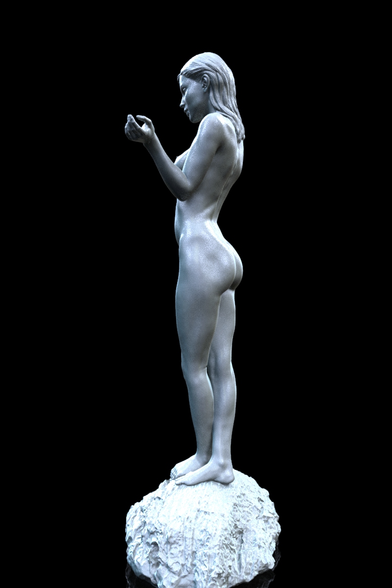

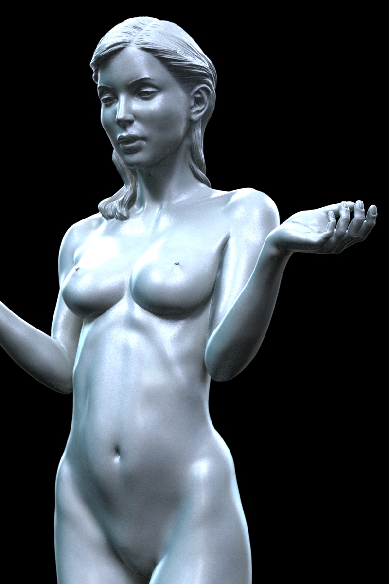

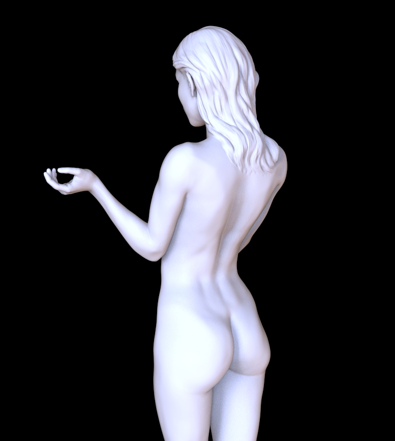

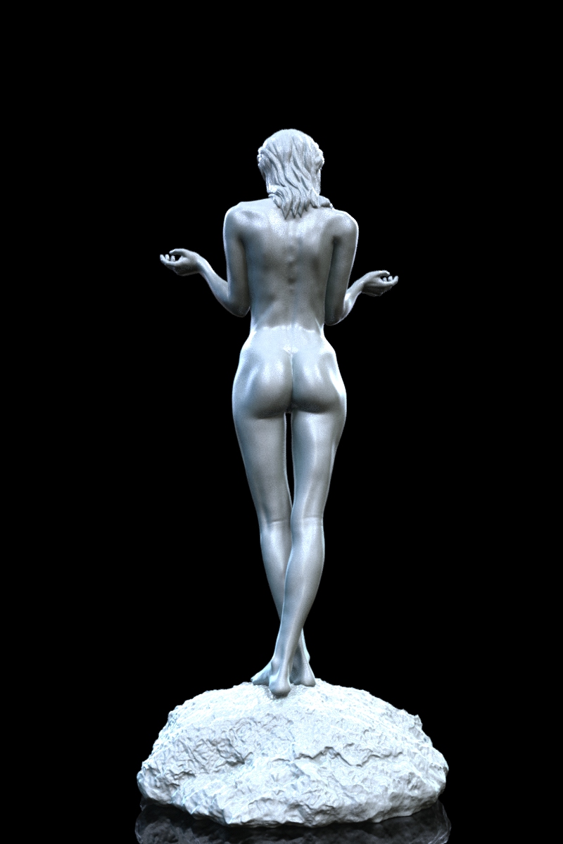

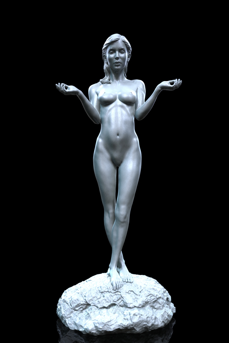

Hi guys, I work on this Project since a few weeks. When I think its right and ready, I will print it out with my 3D printer. The tricky thing about it is, that I want print out this sculpture with 80 cm height, but my printer can make only 20 cm pieces. So I will cut this sculpture in different pieces and put them together after printing. In a view weeks I will show you the pics from the ready project! I hope you like it.

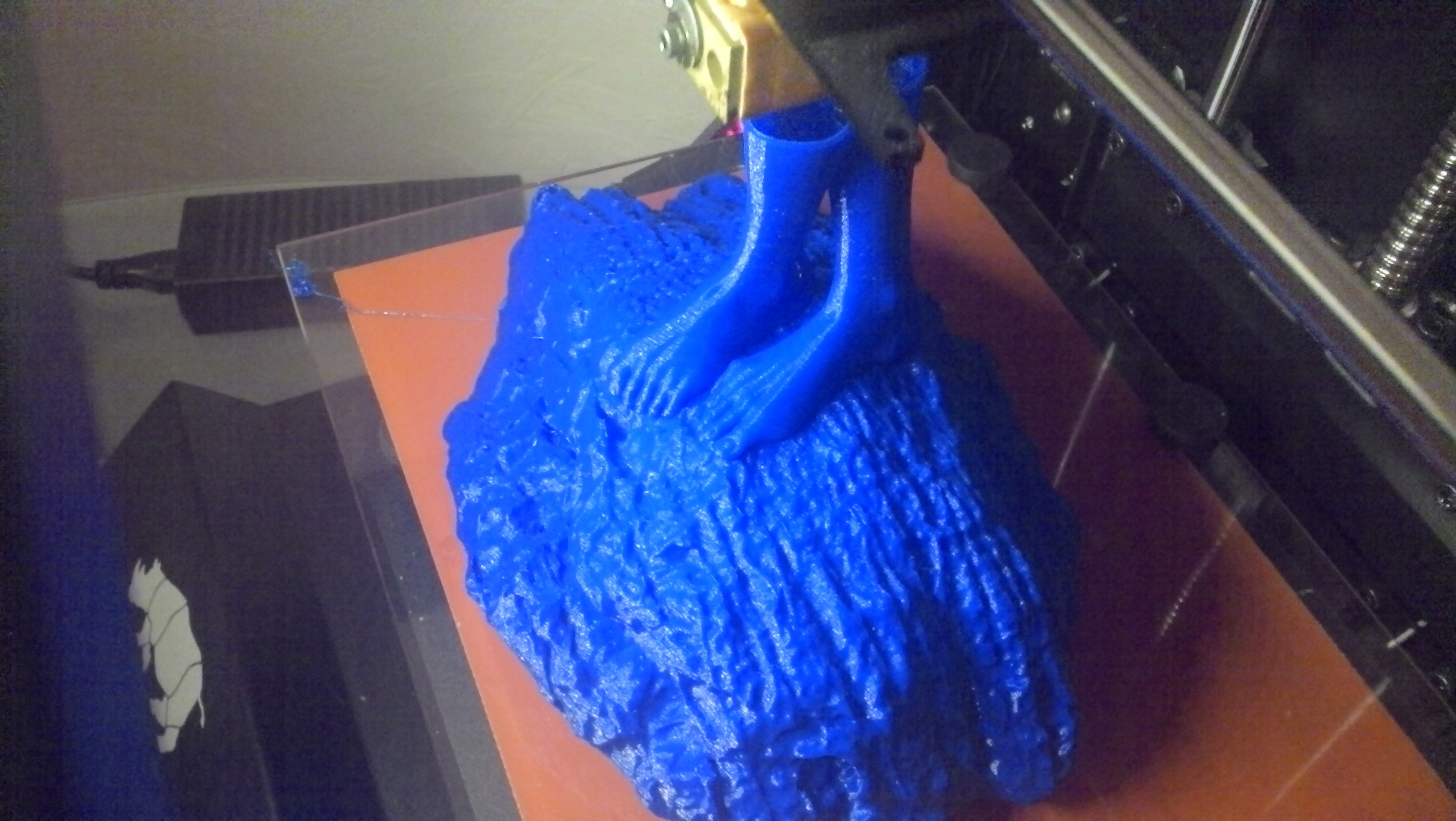

Finished Modeling and now its printing on my 3D printer.untitled.111.jpguntitled.120.jpguntitled.121.jpguntitled.122.jpguntitled.123.jpg

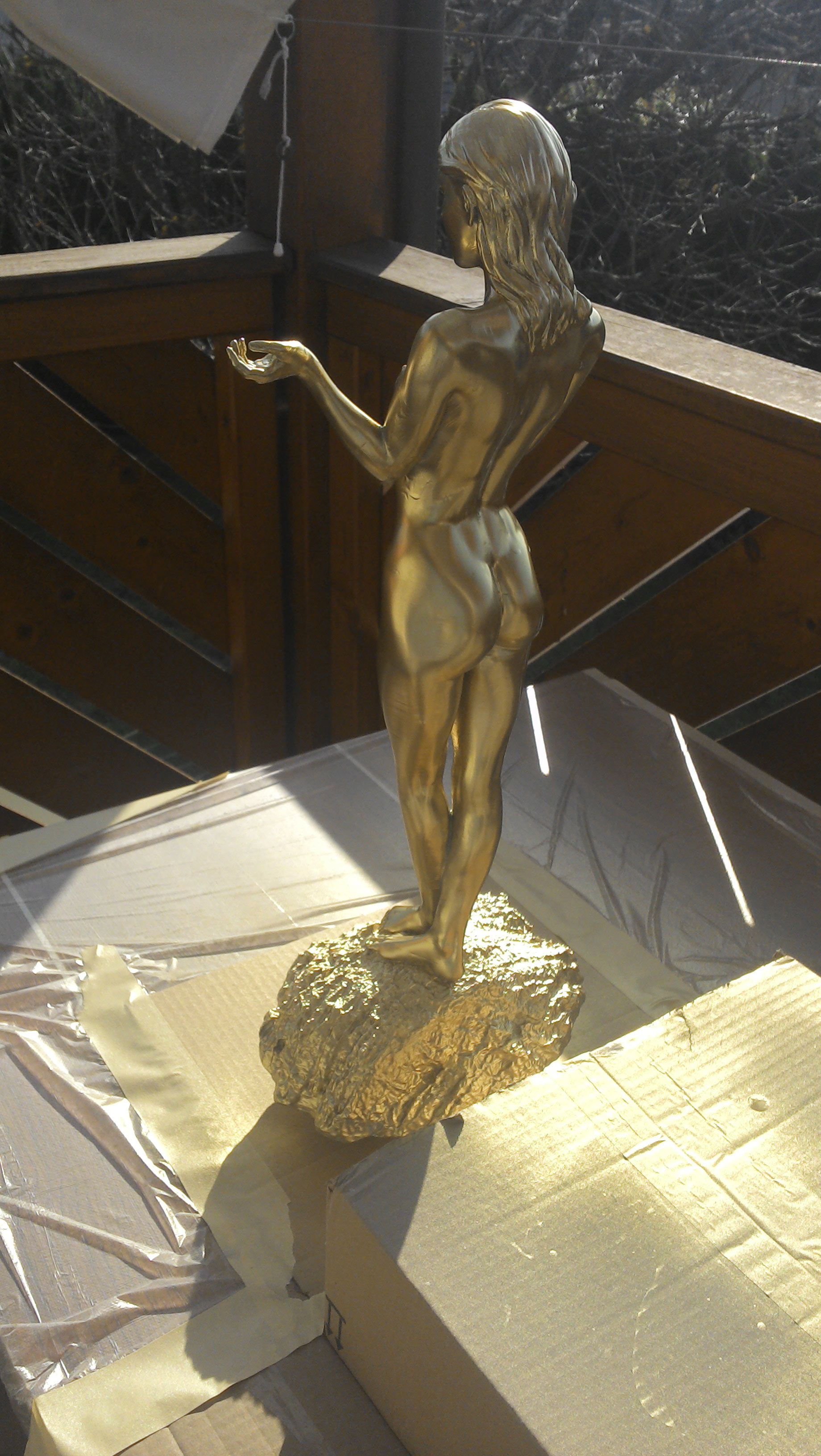

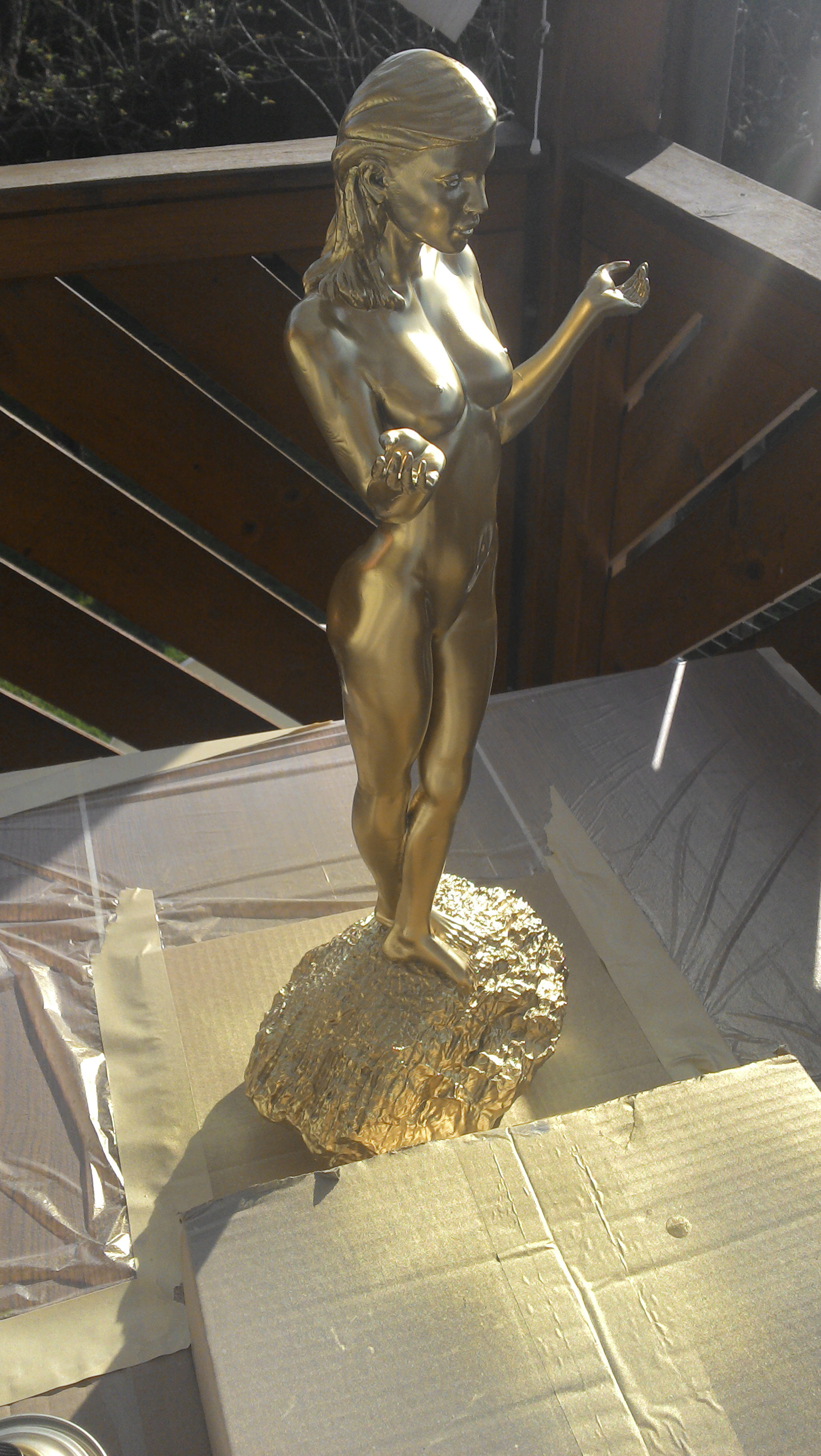

3D figure designed by me. Printed with 3D printer (FDM) and reworked.

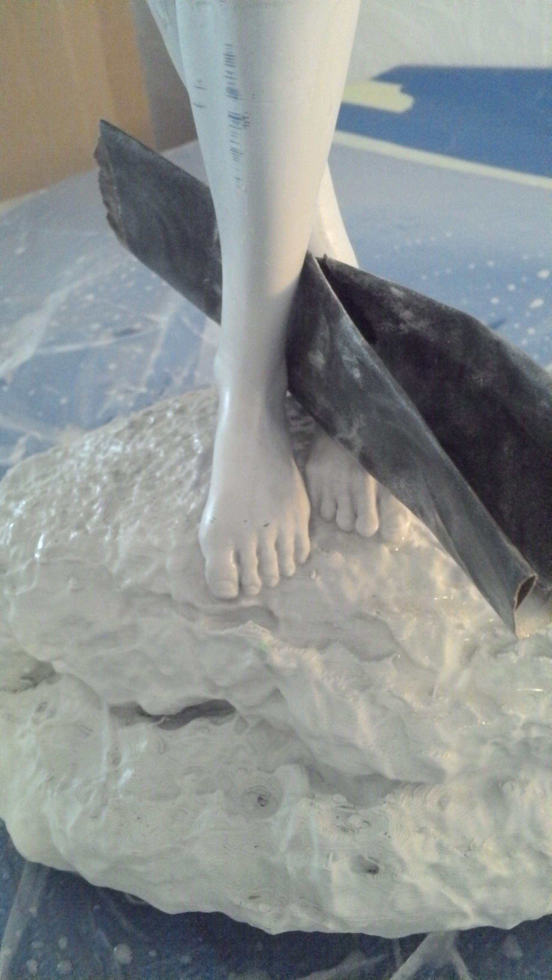

What type of printer are you using ? (looks to be a Wanhao ?.. if so what model and do you have any problems with it)
What were you printing in? PLA or ABS
What did you glue our pieces together with ?
What did you spray your model with and apply finish sanding to?

Here are a bit more information about my 3d printings:

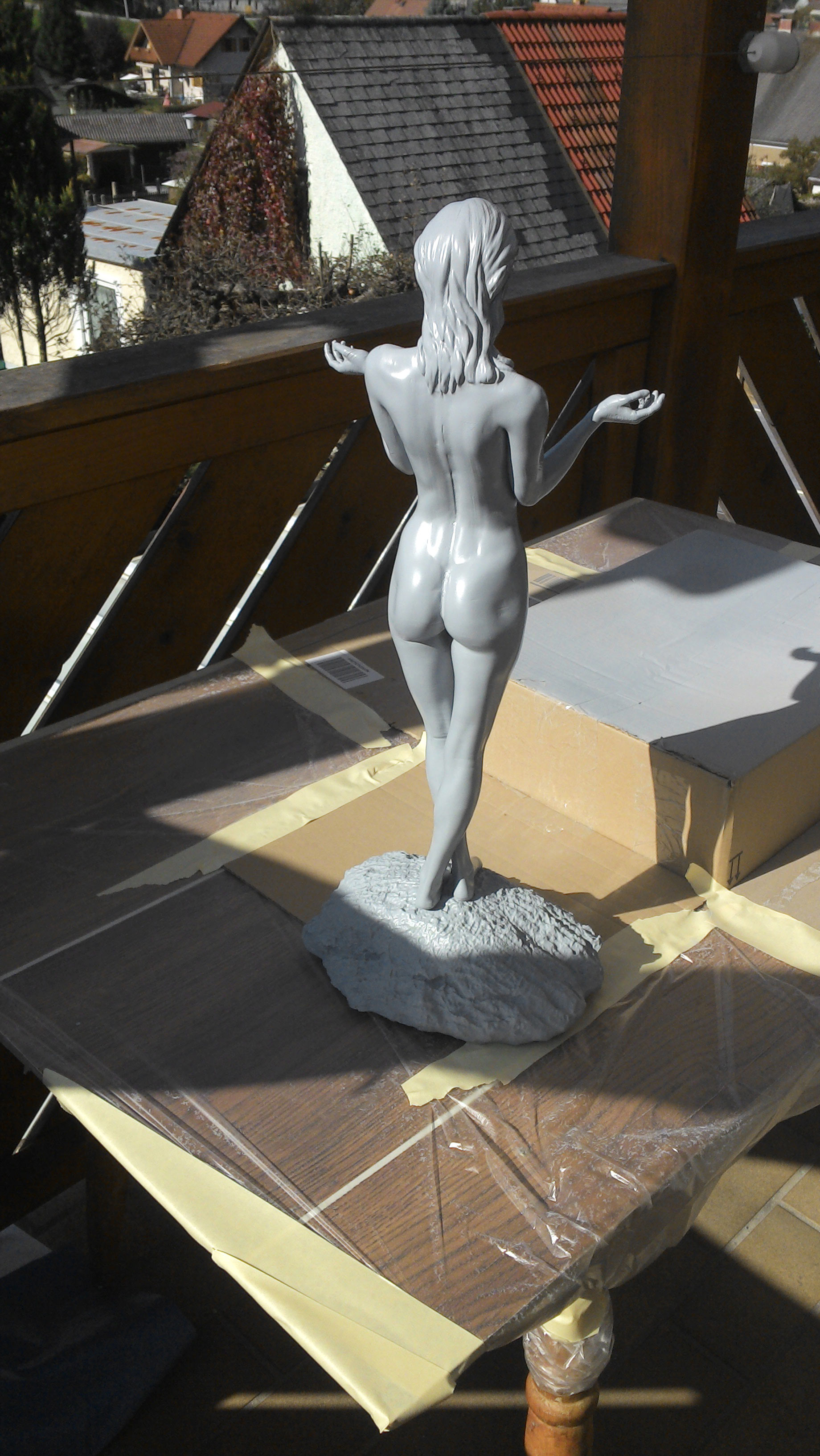

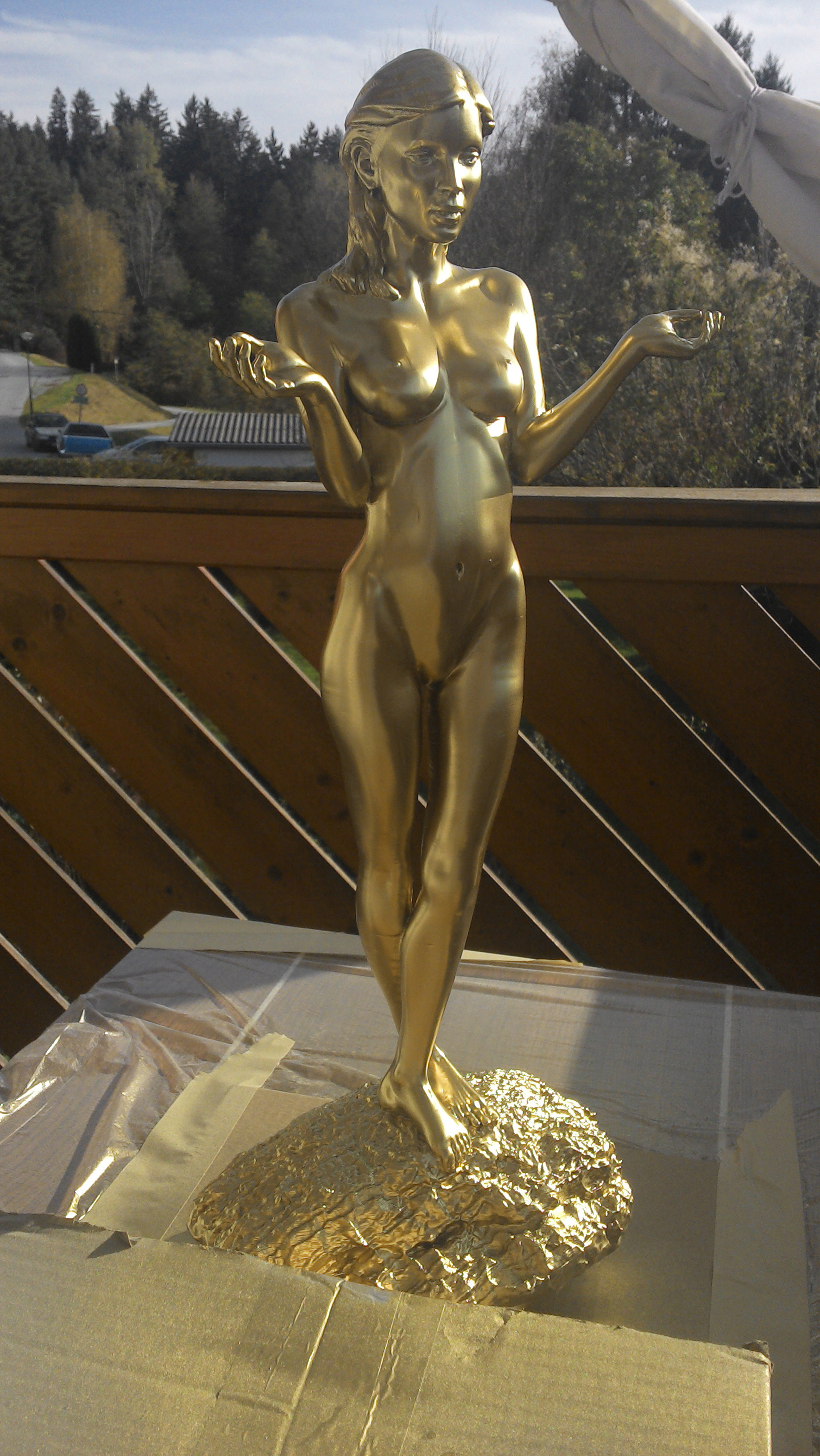

My printer is a Wanhao 5s mini, and I always print with PLA.

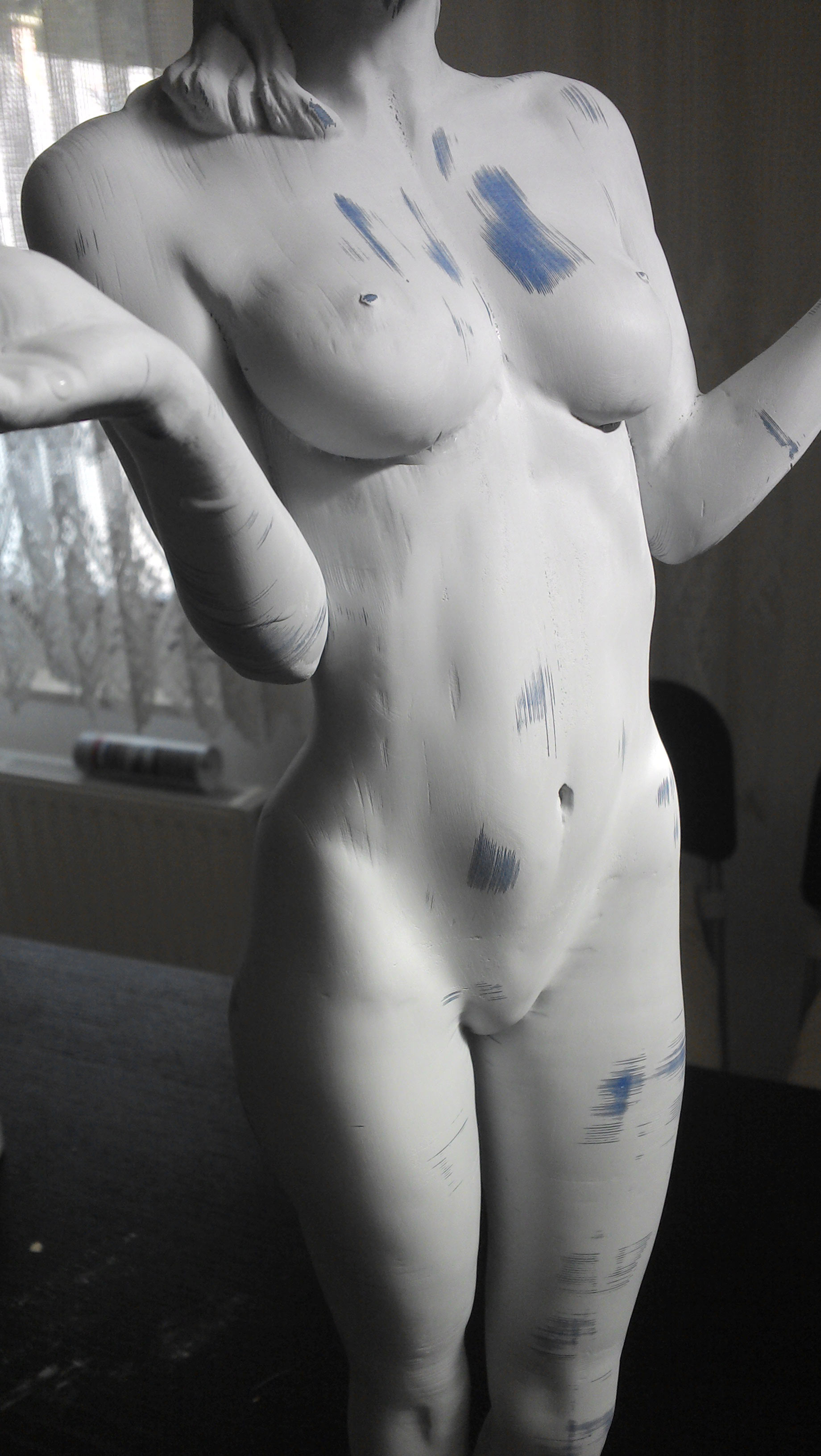

My glue for the pieces is from beko it names Hpbrid POP. It is very good because you can adjust the pieces a couple of minutes before it is to strong. After that I start it with a filler. If its dry I grind it with an abrasive paper (wet 230).
The next step is to spray a plastic primer. After that a sprayfiller to fill the small stripes from 3d printing. Than I grind it again (wet 230). When the surface is pretty smooth I spray a Bronze effect lacquer. And finally, I seal the whole thing with a clear lacquer.
I hope you can take advantage of it. Here is now my next project pictured. This figure is also modeled by me and becomes 50 cm high.
