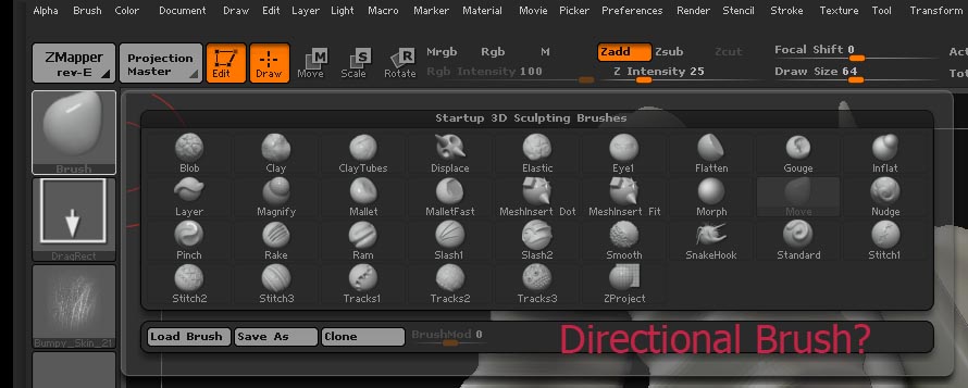

Which brush would that be? I have @ 20 listed, but not a directional brush. The website says there’s over 30? Am I missing something?

These ae the brushes I have:

Directional Brush can be found in the 2.5D brushes section of the Tool panel.
Let us know if you still struggle to find it and I’ll post a pic.
You stated that you’re using Projection Master.
The Brush palette is used when working with a model in Edit mode.
When you have dropped a model with PM, it is no longer in Edit mode. Therefore, you can’t use the contents of the Brush palette. Instead, you use the various features in the Tool palette, which includes the Directional Brush.

Confusing, huh? Aurick is not talking about the brushes in the Brush Palette, he’s referring to the 2.5d brushes in the Tool Palette.
After you enter Projection Master, you are working in 2D so the tool turns into the Simplebrush, by default, which is non-directional (the blue thing in the Tool Palette on the upper right of your screengrab) Click on the Simplebrush and then on the rollout select DirectionalBrush… which will do what you want.

Sweeeeeeeeet!
Thanks Svengali, you just saved me a ton of work.
