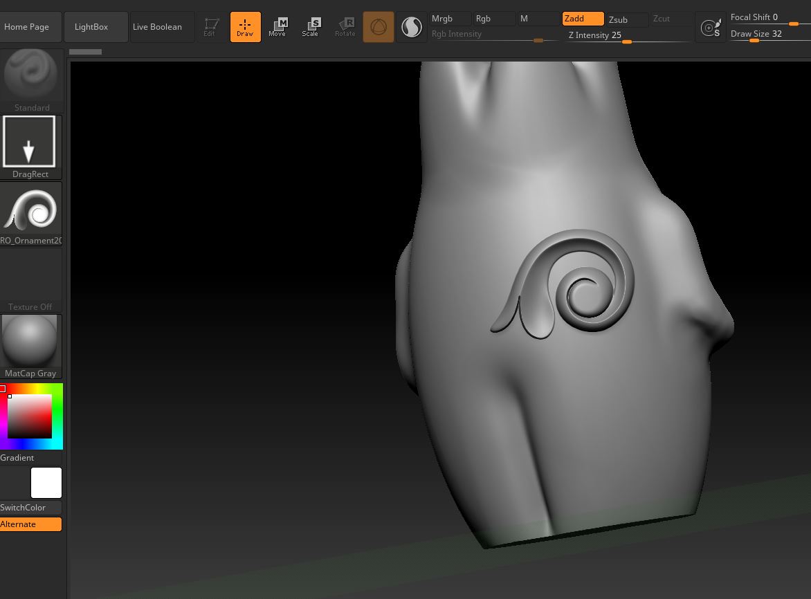

My goal is to be able to make low reliefs (see attached image)on an already “finished” base model. It is important that I can edit (rotate/move/scale) the individual items of reliefs and it still is on the surface off the model.
What is the best way to do this?
The image attached is just made with Standard brush, DragRect and an alpha
Hi perolalars , for this kind of flexibilty of design I might be inclined to create such forms as an actual mesh then create insert mesh brushes from your created meshes.
You can set the zdepth intensity of the insert mesh brush to create a lower relief form as well as set the amount of penetration of the insert mesh by going to Brush Menu >Depth and set the imbed. To help with the insert mesh form fitting to the mesh you are drawing it on to you can >Brush Menu>Modifiers >Projection strength
Once you have placed/drawn out your insert meshes on a target mesh this way you can edit and move them later by using their polygroups to isolate them by masking etc and or split them to a new subtool layer should you wish.
NB:You can transfer an alpha to a mesh by going to alpha menu>‘To Mesh’ or using the ‘Make 3D’ button with the alpha selected in the alpha menu.
A suggestion - to lower your polygon count if using insert mesh brushes - try running decimation master on a the mesh before you convert it to a insert mesh brush (keeping a copy of your master for saftey before you proceed)
Finally should you wish to go with your original route (whether in Projection Master or using the standard brush with an alpha for relief as in your example) then storing a morph target before you project your alphas in projection master will allow you to paint out areas you feel you wish to adjust and reapply back in projection master by using the morph brush to paint back to a stored morph target state i.e before you applied your displacement projections. For this research working with morph target and using layers. NB: incase you were unaware you can also project with actual mesh geometry from within your Tool Menu selections as well as painted information and/or alpha depth.
Hope this helps some and/or gives further food for thought and experimentation.

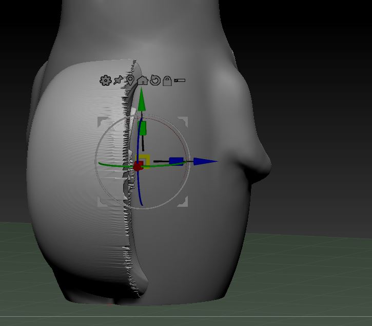

@Boozy help!
When insert or append subtools, trying to move rotate or scale it rips apart the subtool and I dont understand what´s wrong!?
turn off symmetry by pressing “x”
Thanks Lukasso, but it still rips it apart…
Its like some polygons/points on the subtool is locked in space and rest is not…
The odds are that it’s a mask. Go to Tool > Masking and clear the mask.
@zber2 Thank you soooo much! That did the trick! Happy weekend to you and all that have help me so far!!!
