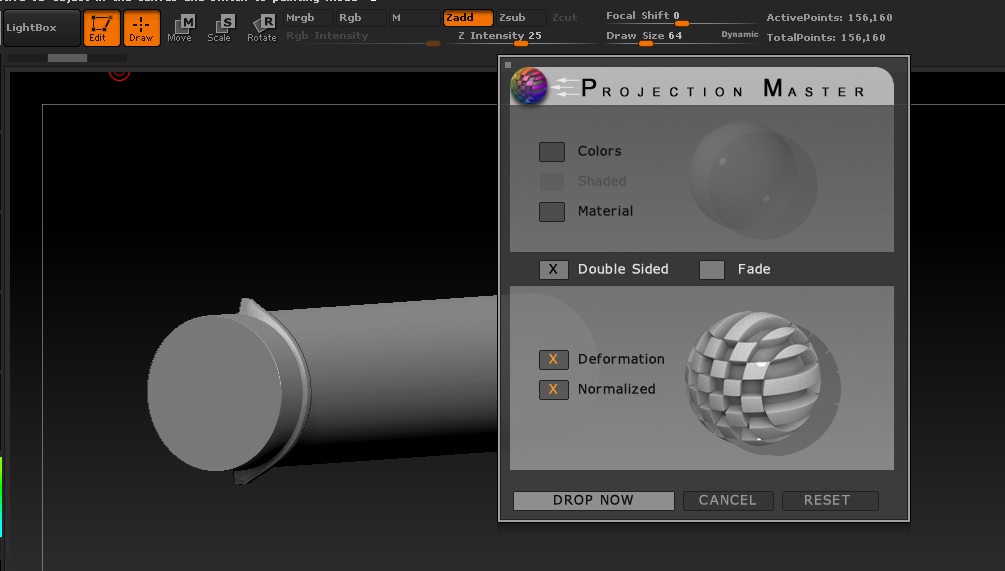

Good afternoon! I have a problem in Projection Master. Even putting it on DEFORMATION and DOUBLE SIDE it just textured on one side of the object. Has anyone seen this?
This is a known issue. As a workaround, turn on ‘Double’ in ‘Tool > Display Properties’ before you go into Projection Master.

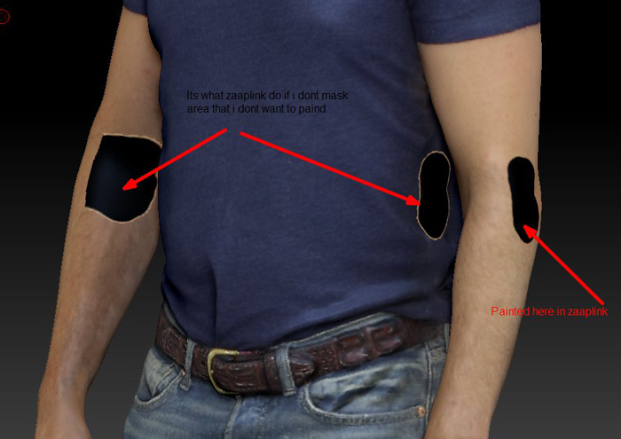

To get it work i have to mask area that i want to paint and hide unmasked then export to zapplink
Otherway i get result like on picture above

Piosio,
That’s a limitation of ZAppLink (and Projection Master) and nothing to do with the Double-sided feature. The reason that happens is that both ZAppLink and Projection Master work on a 2D version of your model. If your model has parts that overlap (such as the arms overlapping the body) the plugins have no way of distinguishing between the surfaces.
