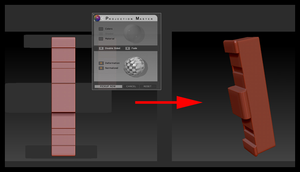

Hey guys! I’m using 4R4 and I’m having an issue with Projection Master. I’ve tried to follow the tutorial here step by step, but when it comes to the Pickup part, it only projects on one side of the geometry. What am I doing wrong?

In the tutorial he’s using ver 3.1. The only thing I see that is different in this is that in the Unified Skin where he says to set it down to 8, 4R4(5) only lets you go to 16. I don’t think this has anything to do with the problem though.
This is a known issue. As a workaround for now, go to ‘Tool>Display Properties’ and turn on ‘Double’ before you go into Projection Master.
That did it! Thanks!
