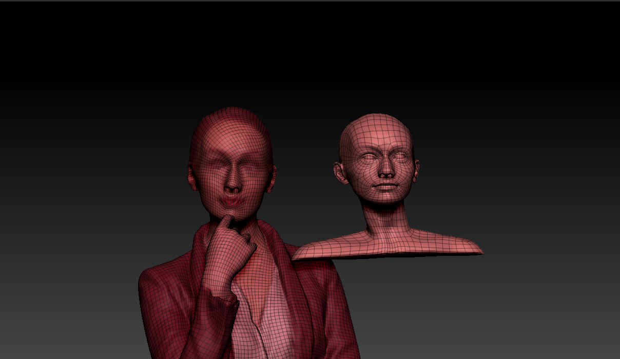

Is it possible to transfer one topology onto another different mesh but similar ?
I try use a projection but it only transfer mesh detail from the base head :rolleyes:
Picture :
( Transfer Topo from right to left )
Thanks for help !

project all is what you need to project one topology to another.
you need to make sure that your “diffuse” is polypaint to transfer it as well.
Thanks ! But then I will have two seperate pieces right ? I can project detail onto topology on the right but than I have to switch new mesh with the model on the left, am I correct ?
If so… What is the best way to connect one mesh to another ? Do it in another software or is there some good method for it ?
You actually don’t want a single mesh would be my guess. You’ll want one for the each “piece” the clothes, head, hair, hands, etc.
