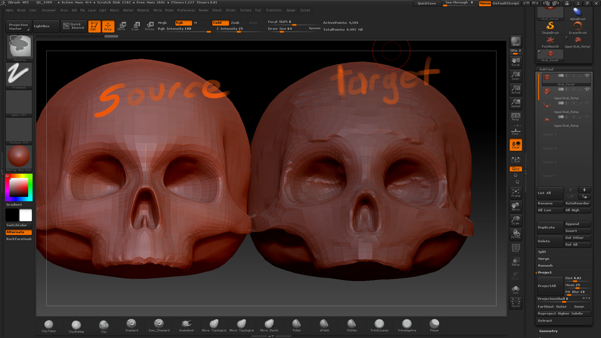

Can anybody tell me what I´m doing wrong when using the Project All function? I have that problem on lower and higher subd level.
Assuming you have them lined up in the same place, you could try increasing the projection distance and projection shell a bit
Changing the dist slider did the trick, thanks man.
