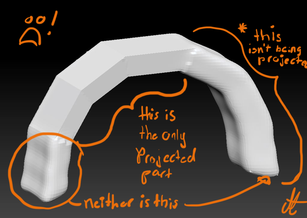

Project All issues after remeshing HELP
After Remeshing part of my (Very) low poly model, for texturing purposes, I was trying to Project the detail, since I still want the hard surface look. I then ran into this problem: It only projects parts of the mesh?
I’ve checked:
Resolution: To see if bumping up subdivisions helped (It didn’t)
Normals facing the proper way: They were
I’ve also restarted ZBrush and reloaded the model from an earlier state; didn’t work either, sadly.
So that’s why I’m asking you guys for help!
Check for masks, and try increasing the distance used on the projection (maybe give it a bigger projection shell as well)
This Doesn’t seem to work either :frowning: It only distorts the projection alot more, sadly… But thanks for your help anyways!
I found out what was wrong. You’ll need to subdivide the original subtool you’re trying to project to a new mesh!
