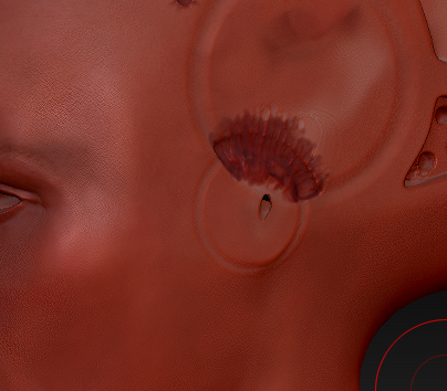

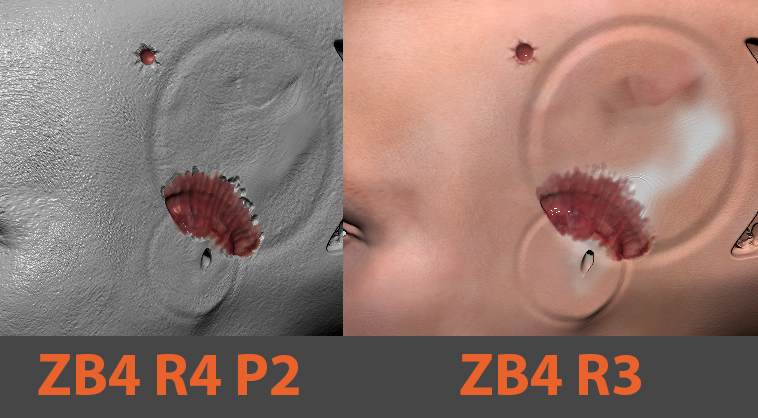

I’ve been working on a long-term project in R3.
When I went to load my files from R4P2 I was shocked to see my files were not compatible.
The photo I have below illustrates the issues at hand.
My project is close to completion and I would like to render it in R4P2.
What is the problem here?
Do you have a texture map on your model? It looks to me as though the texture map has embedded materials and the Bump Viewer Material is occupying the slot in 4R4 that was occupied by your skin material in R3.
Hi, No texture map…
It does look like the newer ZB is seeing the spotlight / polypaint as a texture though.
thx.
If it’s polypaint then my idea still holds. That looks like the Bump Viewer Material. As an experiment, try this (make sure your model is backed up first):
  1. With your model in Edit mode, select the Flat Color material in the Materials palette.
  2. Turn on the ‘M’ (material) button in the Draw palette.
  3. In the Color palette, press Fill Object.
  4. Select the SkinShade4 material.
Hi Marcus,
That worked!
HOWEVER, It is still MatCap Red in color, but I can see the paint in there…
THANKS!
Marcus…
I got to work…
I loaded my original Material and the correct polypaint came up!
Can you tell me why ZB4 R4 P2 is having this problem?
Thanks again for your help! :slight_smile:
