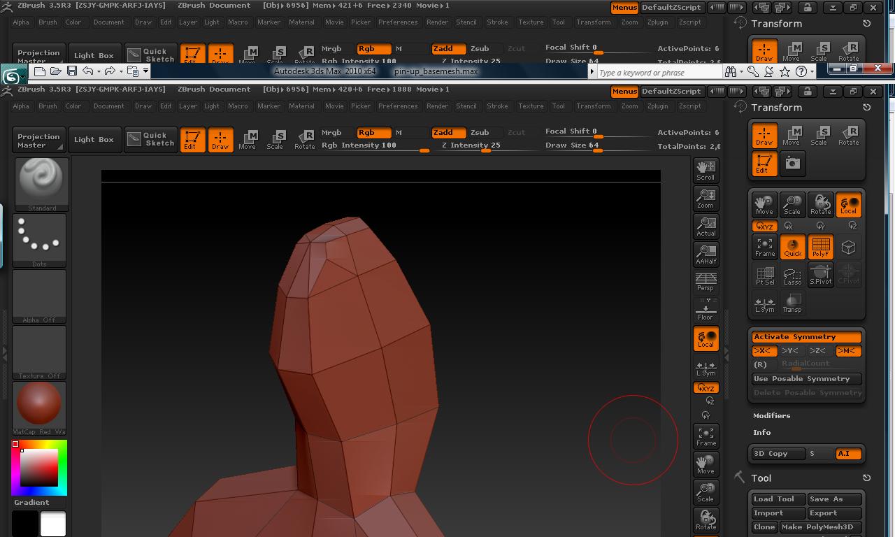

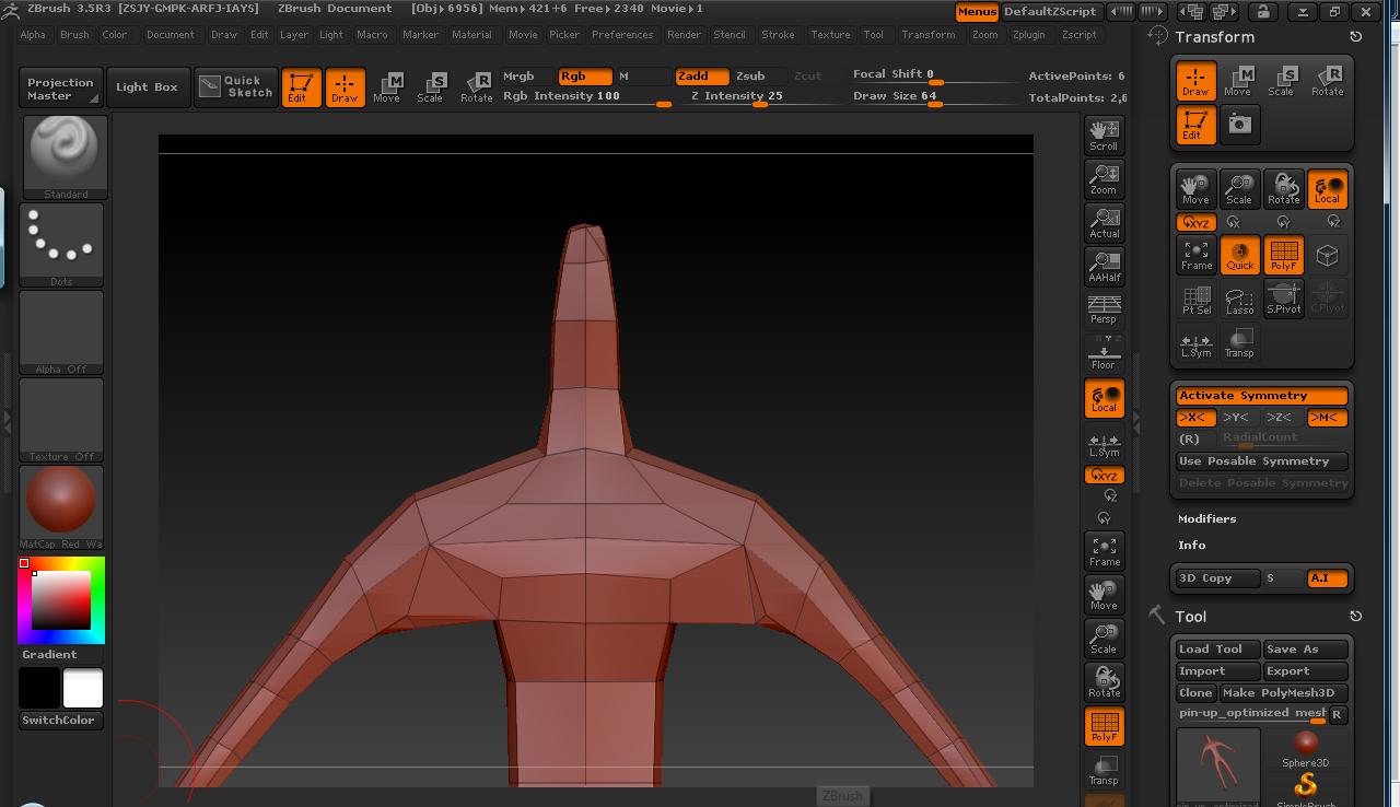

So this is what i did: i made a mesh in zbrush from zspheres, exported it to 3dsmax to change some of the topology, spent a lot of time making sure to have only quads, and when i import it into zbrush zbrush alters my mesh in strange ways.
i tried deleting half of the mesh and remirroring it in 3dsmax, but the mesh gets messed up in the exact same ways when i import it in zbrush again.

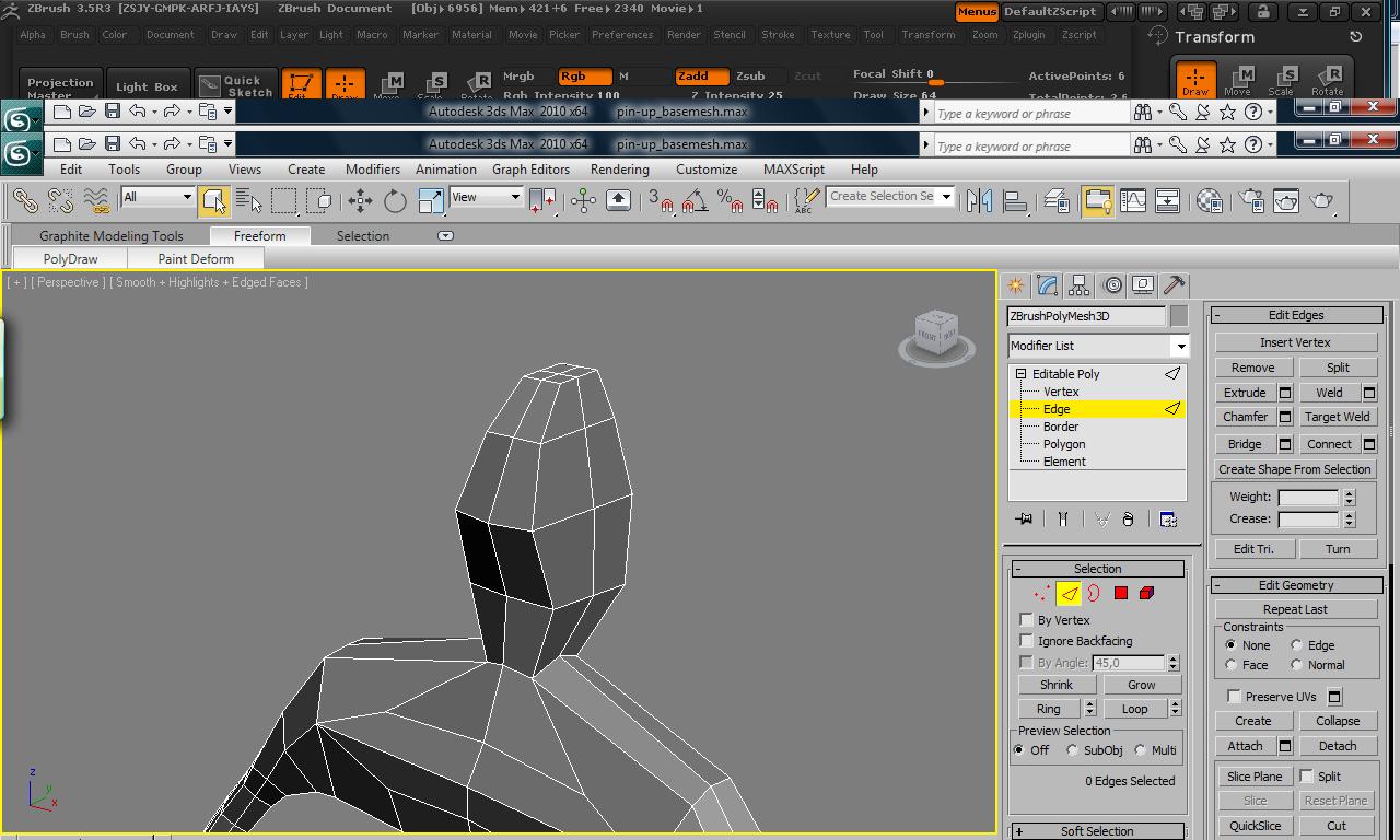

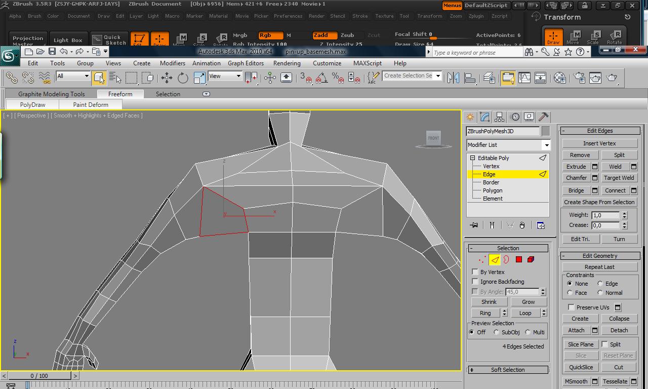

this is my editable poly mesh in 3dsmax

1st one is because it has 5 edges. You either import tris or quads. Anything more is bad. Though tris isn’t very good either.
Anything that has more than 4 edges will be triangualted/quadrified.
Thanks for the tip, i thought i only had 4 edges on his back, aparently not, anyway i changed the topology and it flows better now. the other problem at the head was because i had two verteces overlapping witch were nt connected to each other, welded them together and i now have a clean basemesh.
