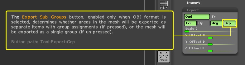

Hi this is my first post I was hoping someone could help me I recently tried to export a simple stone wall sculpt into unity as an obj but when I opened it in unity it had been split into a load of different groups I’m using V 4R6. I may or may not have attached a picture to show this it’s unclear.
Turn “Grp” off in “Tool > Export”.
Hi thanks for the help I still have the same problem though I should have mentioned that I had turned groups of in the exporter panel. The model is a single subtool with no groups so for some reason the exporter or unity must be creating these groups. I did use merge once. Do you need to delete lower subs to export?
