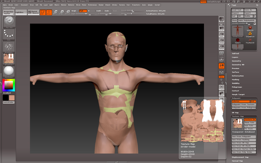

I have the following issue:
I am posing some characters in Poser. But before that, I export the Poser model and
import it in ZBrush in an attempt to create a texture to add later again in Poser.
This is how my polypaint looks:
However, here is what happens when I press “Make texture from Polypaint”:
What am I doing wrong?
P.S.: I use ZBrush 4.0
are you using layers?
did you bake them down before producing a texture?
what do your UVs look like?
It kind of looks like the model was made to either have multiple UV sets, or multiple materials/clusters. One texture meant for the head, the other for the body, both in the same 1:1 UV space. The latter would be the more likely/easiest scenario.
A simple fix if you’re allowed to redo the UVs. Otherwise you’ll have to split your mesh into two subtools, one for each texture.
