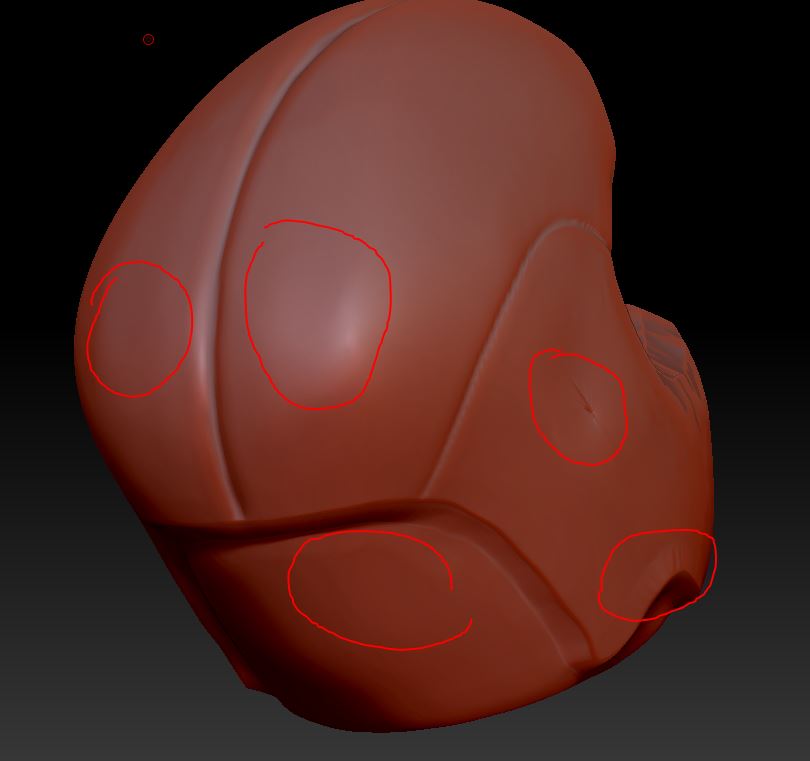

Hi guys!! I have a small problem with the smooth … I’m a noob to ZBrush and my problem is to make the surface of my helmet in the picture perfectly smooth … there are proofs that I can not delete … can someone give me some trick?
Thank you!!
For the lines you have an alternative smooth that works releasing the shift key while dragging the stylus. This problem can appear because the geometry has artifacts (triangles etc) and this smooth type deal better with them. Obviously another solution is using zremesher to get a cleaner topology. It is nearly impossible to get surfaces smooth enough if the topology is bad. I guess triangles and irregular density of polys in the bottom right area.
For the subtle uneven surface the solution is tricky. Having a good topology helps. Also having subdivisions where you can smooth in a more efficient way to create more regular curved surfaces. Sometimes you simply need to use the move brush a bit to correct curvatures.
Ok thank you very much!! I’ll try!! Thanks
