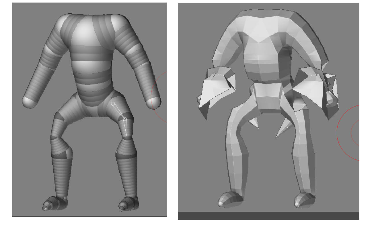

After tweaking a bit on z spheres I end up with a preview of the model shown here. What is going on, how do I fix this? The mesh is all whacked out? HUM
What was your workflow? Did you increase the Density slider and then decrease it again?
This is a common problem. Before you edit the mesh in ZSphere-Preview mode you should set the density slider in your Adaptiv Settings to at least 3-4. You can now switch to a lower level under your geometry rollout and the problem should be gone.
