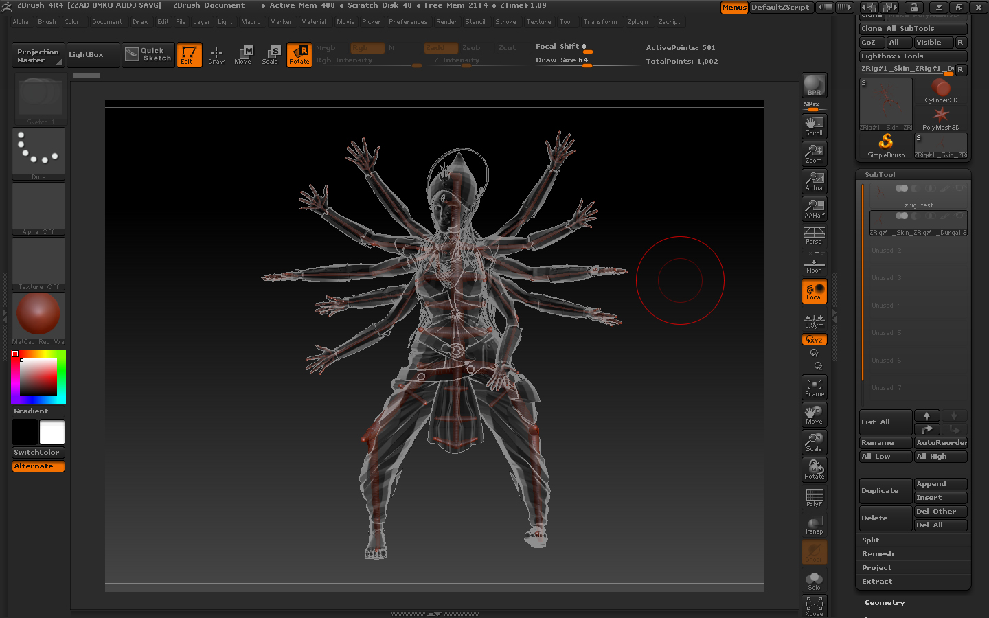

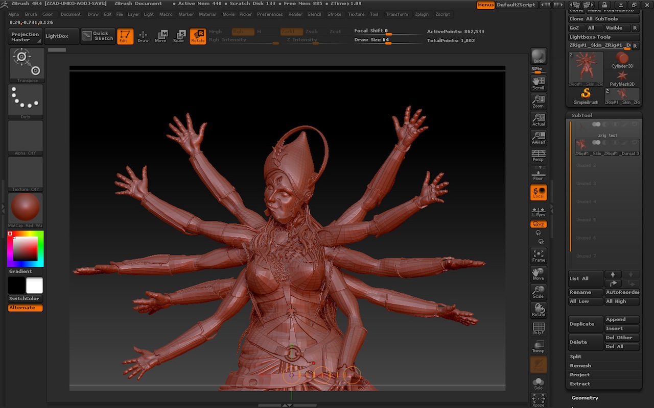

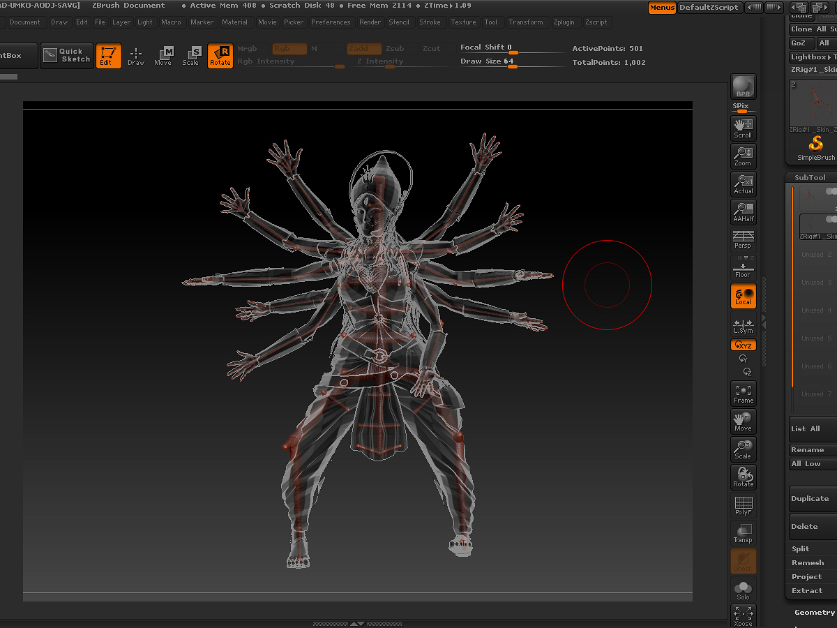

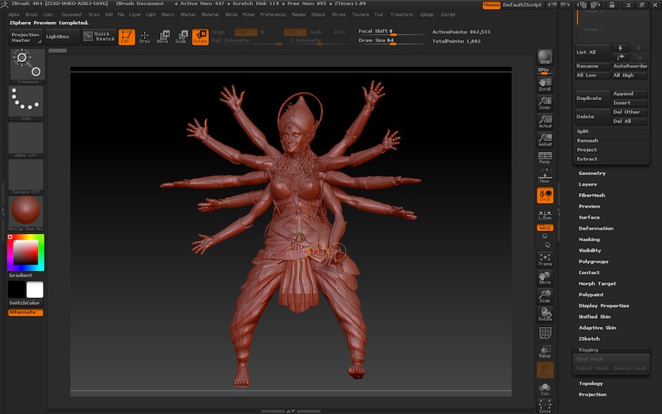

Please find the images for the same
1 and 2 Rig of the pasted model
3. Original rig of the model
4. Preview of the rig of original model
The problem is that whenever I am trying to rotate or scale or move the mesh of the face is being disturbed.
Thanks. The mesh has a lot of polygons for posing with a zsphere rig. Anyway, I think if you add some extra zspheres in the neck area you are less likely to get the distortion.

I think that is not the problem because that rig is working fine with the model. After pasting it to another model it starts creating problems.
