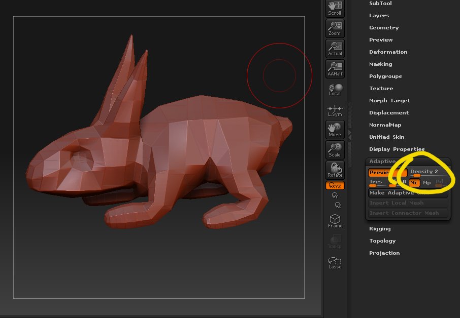

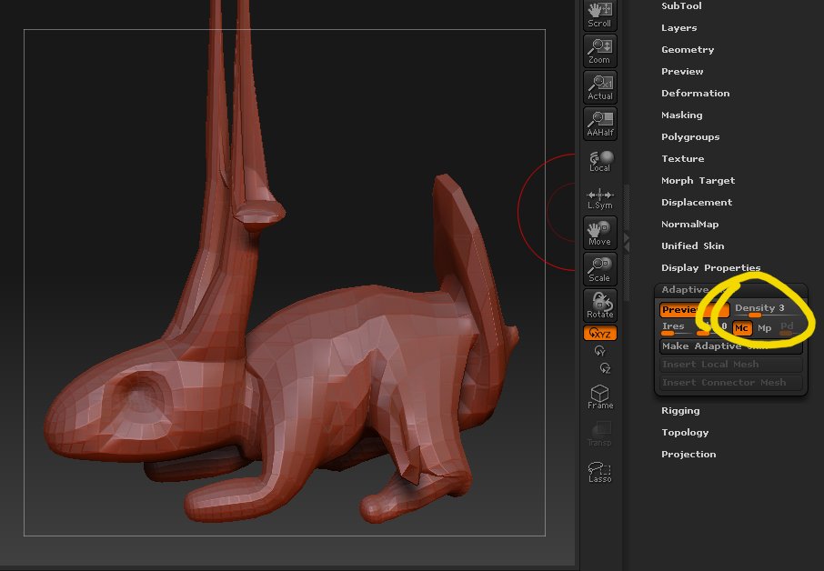

i have this lingering problem with Zbrush that has unforunately discouraged me from learning the package for years. I get the base mesh inside or create itusing Zspheres. Then i tweak it for a long time to get the topology right before going to the next subdividion level. But i find that once i hit the divide button the model gets all stretched and goes haywire and i can’t account for all the time i spent tweaking the damn thing.

i see noone has replied to my question. Please, i beg you to reply and solve my problem. Here i post sample images for better understanding.

What happens when you hit the Make Adaptive Skin button at the lowest resolution and then Divide the mesh in the Geometry menu? You could try messing with the Intersection Resolution and Membrane Curvature settings in the Adaptive Skin menu to see if that fixes it. Also, try turning the Minimal Skin to Child and Parent buttons on and off to see if that corrects it.

FIX YOUR TOPOLOGY. YOU HAVE TRIANGLES AT THESE AREAS THAT MESS UP.WHAEN YOU HAVE A TRIANGLE IN THE AREA THAT STIKS OUTWARDS OR INWARDS THAN WHEN YOU SUBDIVIDE IT ENDS LIKE IN YOUR CASE.

antisymmtry- I did check the settings you are reffering to, atleast the last 2 ones. But, i don’t remember getting favourable results. I mean, if i hit MC or MP then i would have tp go back and do the same sculpting that i did earlier.
paulius-st - I think you a right. I will go back and look at my topology. thanks buddy :slight_smile:

I think your problem is not coming from the topology, but rather from the matter of fact that you`ve started sculpting in Preview Mode.
You need to make a skin (adaptive skin or unified skin) and then you can start sculpting. Or you need to store a morph target first.
See here (post no.2)
http://www.zbrushcentral.com/showthread.php?t=64788&highlight=zsphere+point+order
