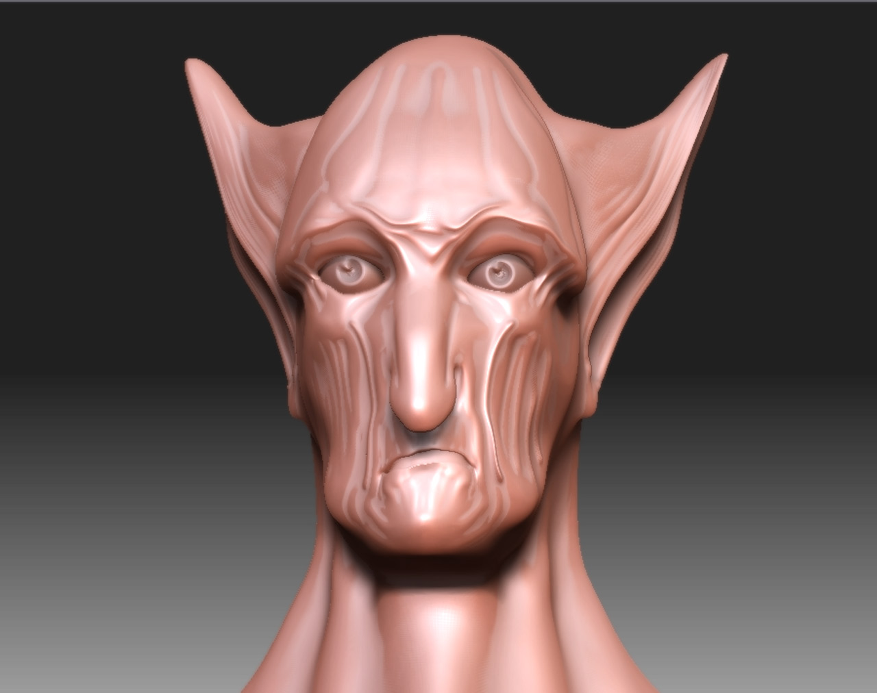

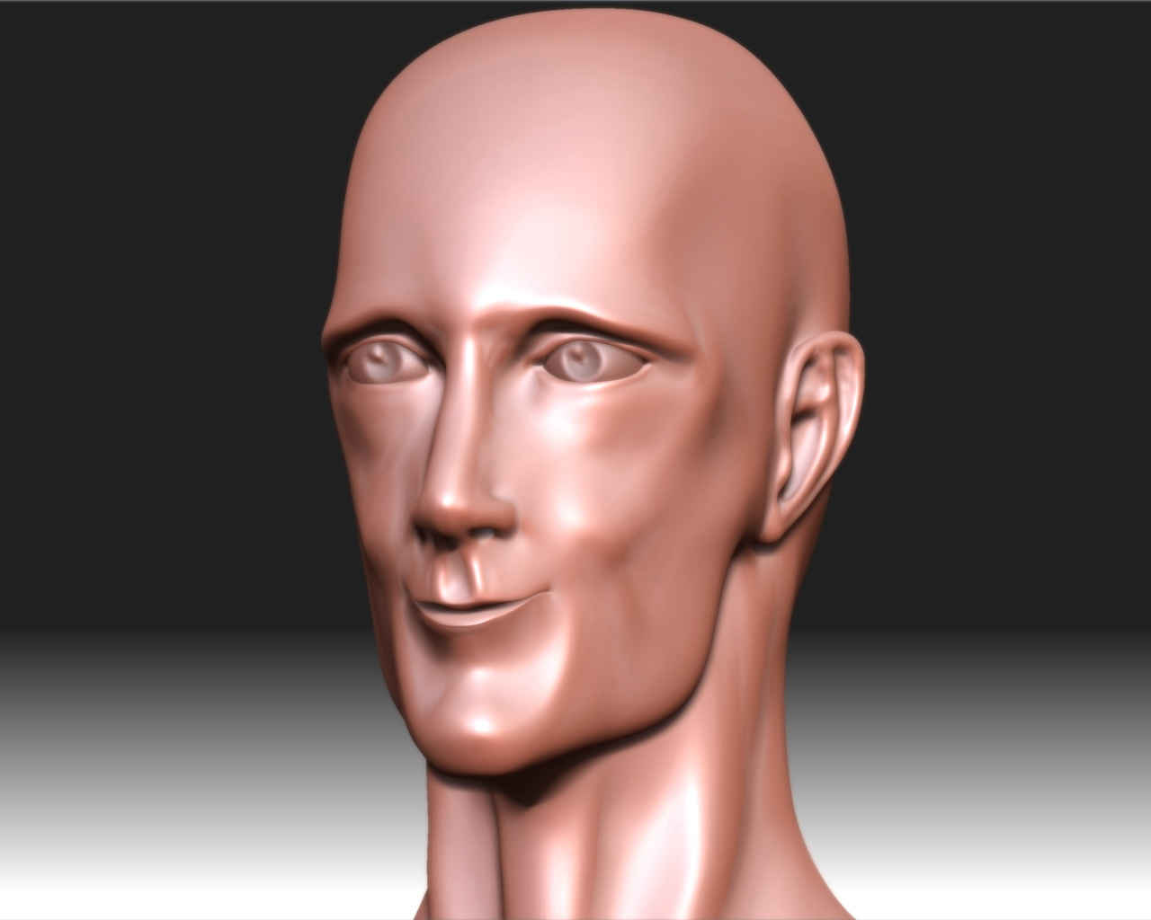

Hey guys I tried something new I hope you all like it
Santis:. thanks man I really hope to see my work on the top row, but i think i must keep on practising I am faaaaar away in quality and art from these guys on the top row :lol: :lol:
Ohh, so you moved on to creatures now :slight_smile:
Looks nice, keep em coming :+1:

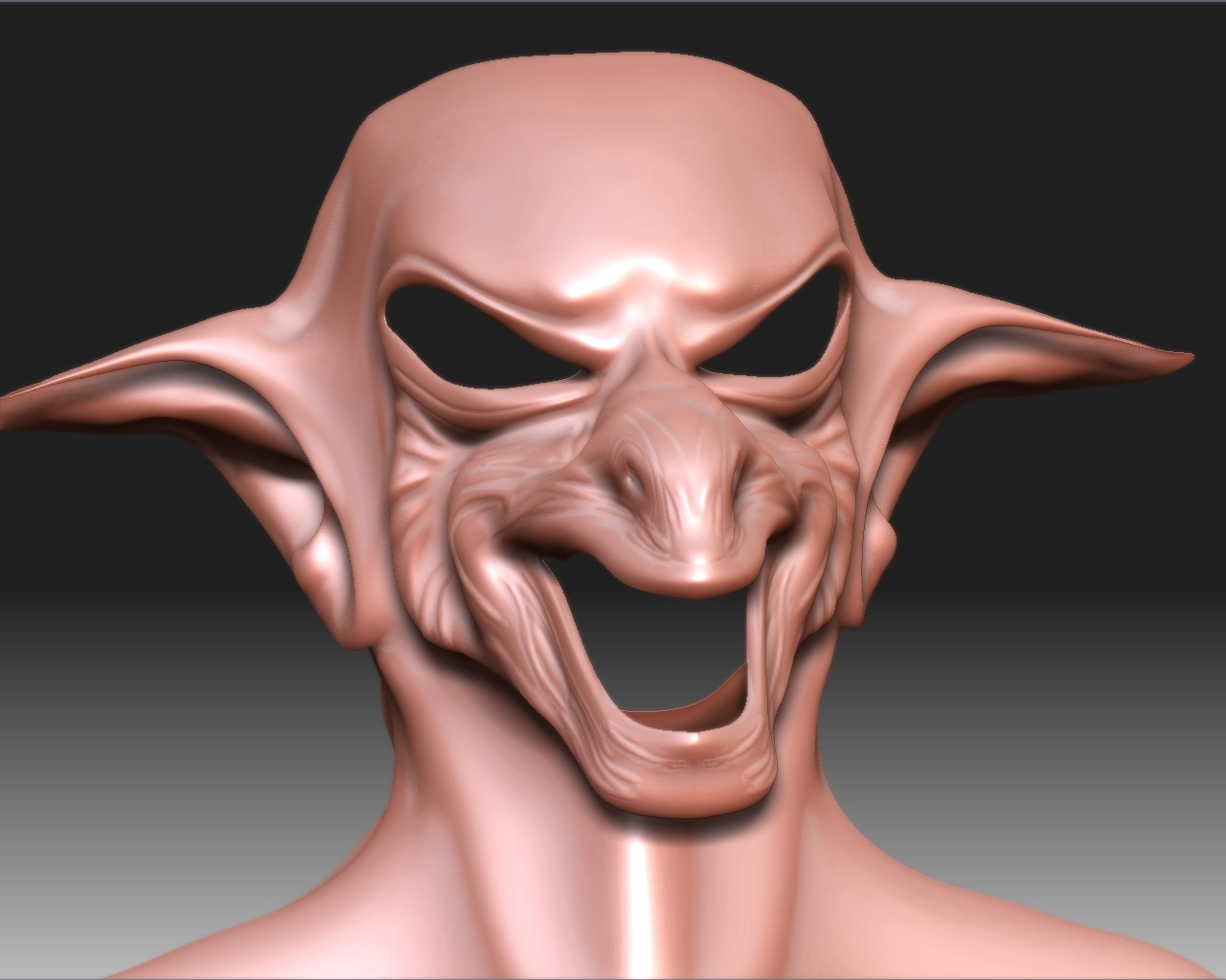

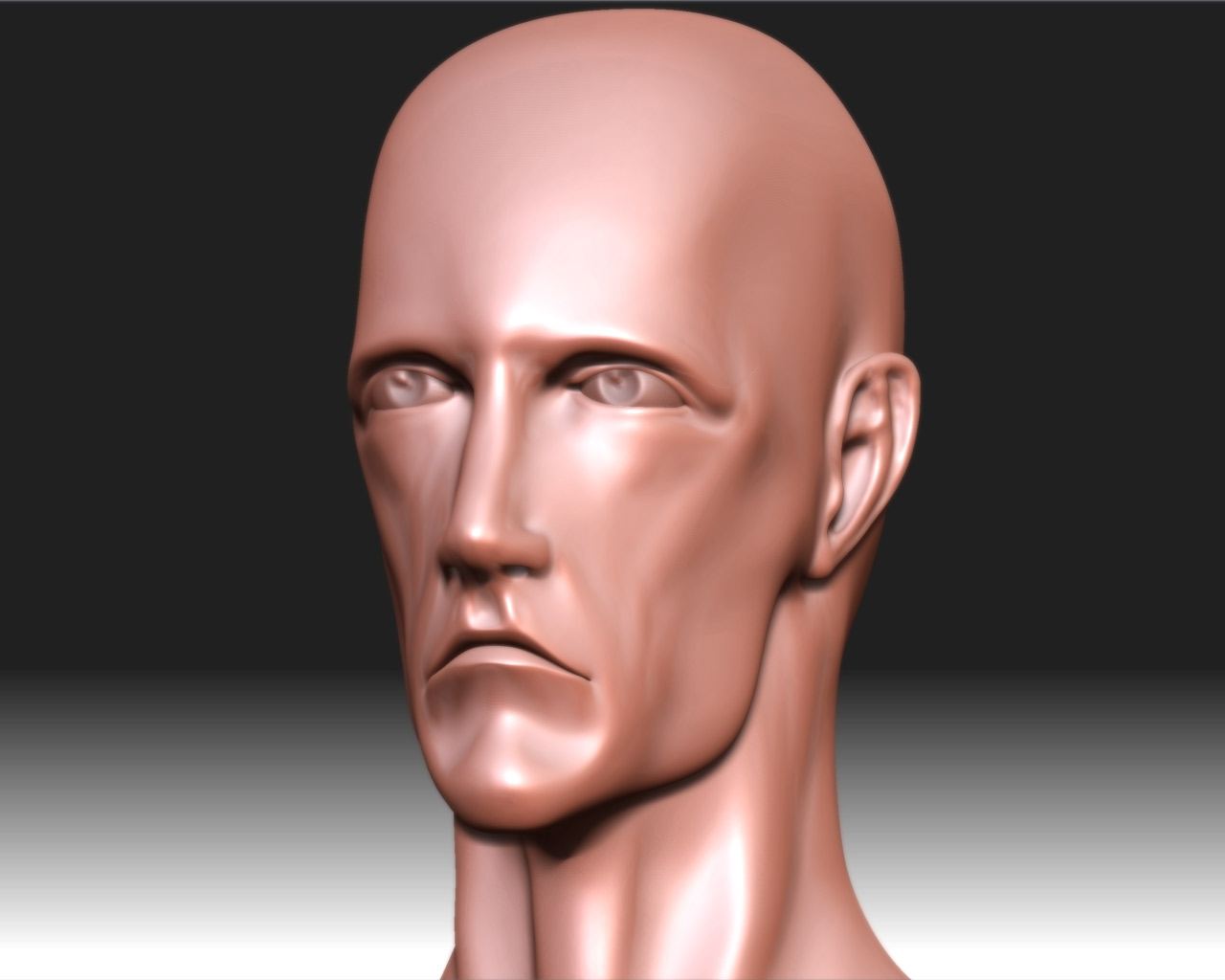

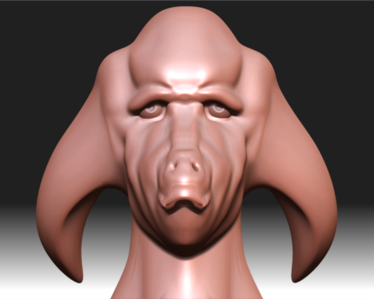

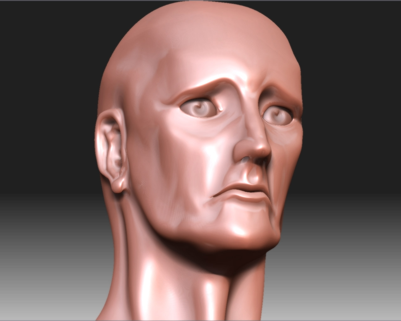

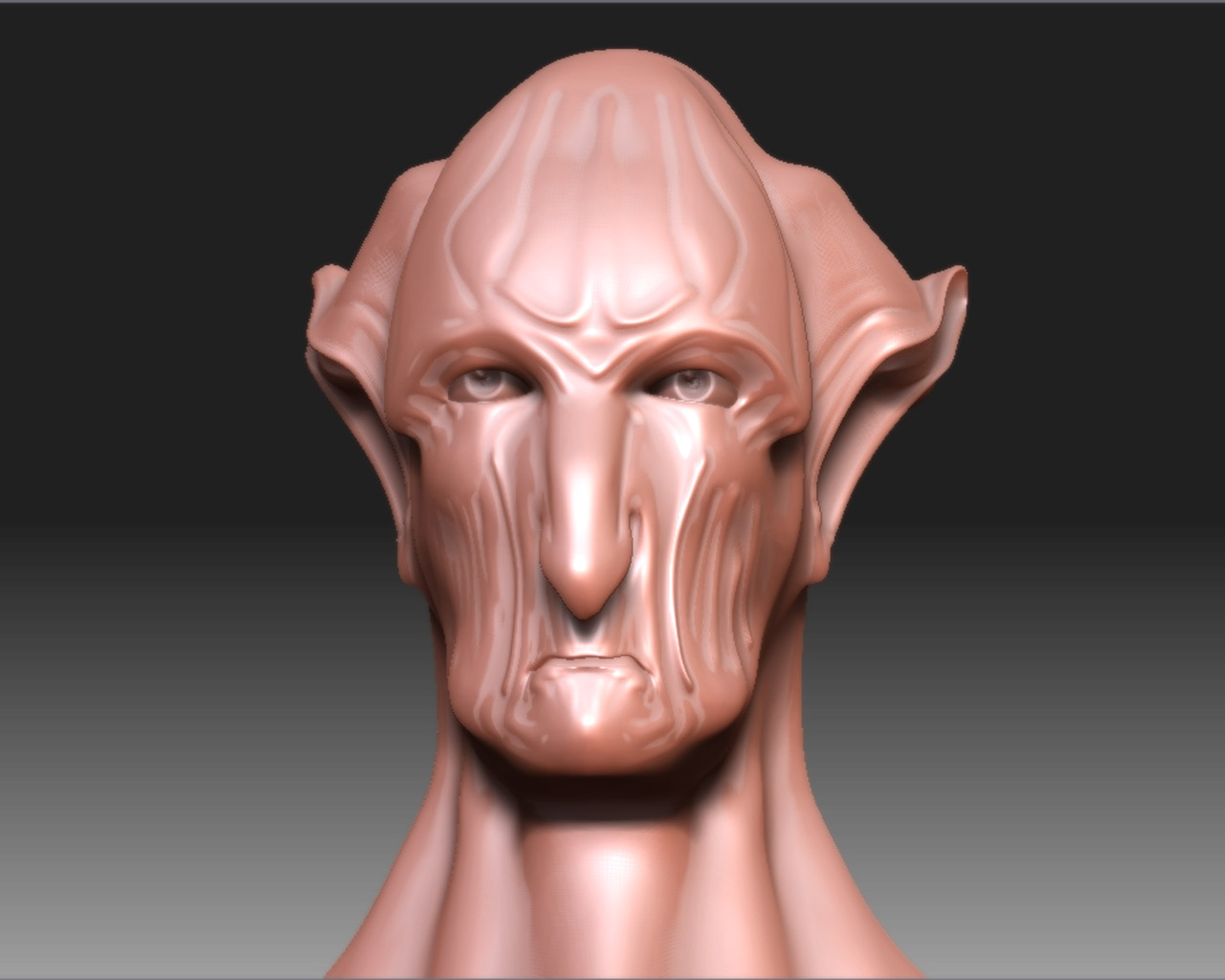

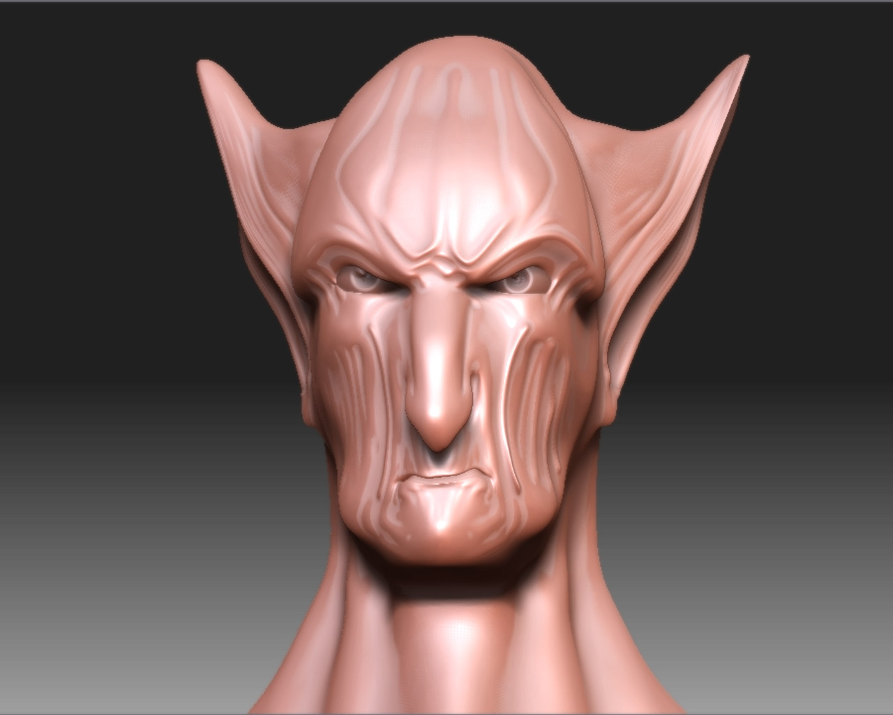

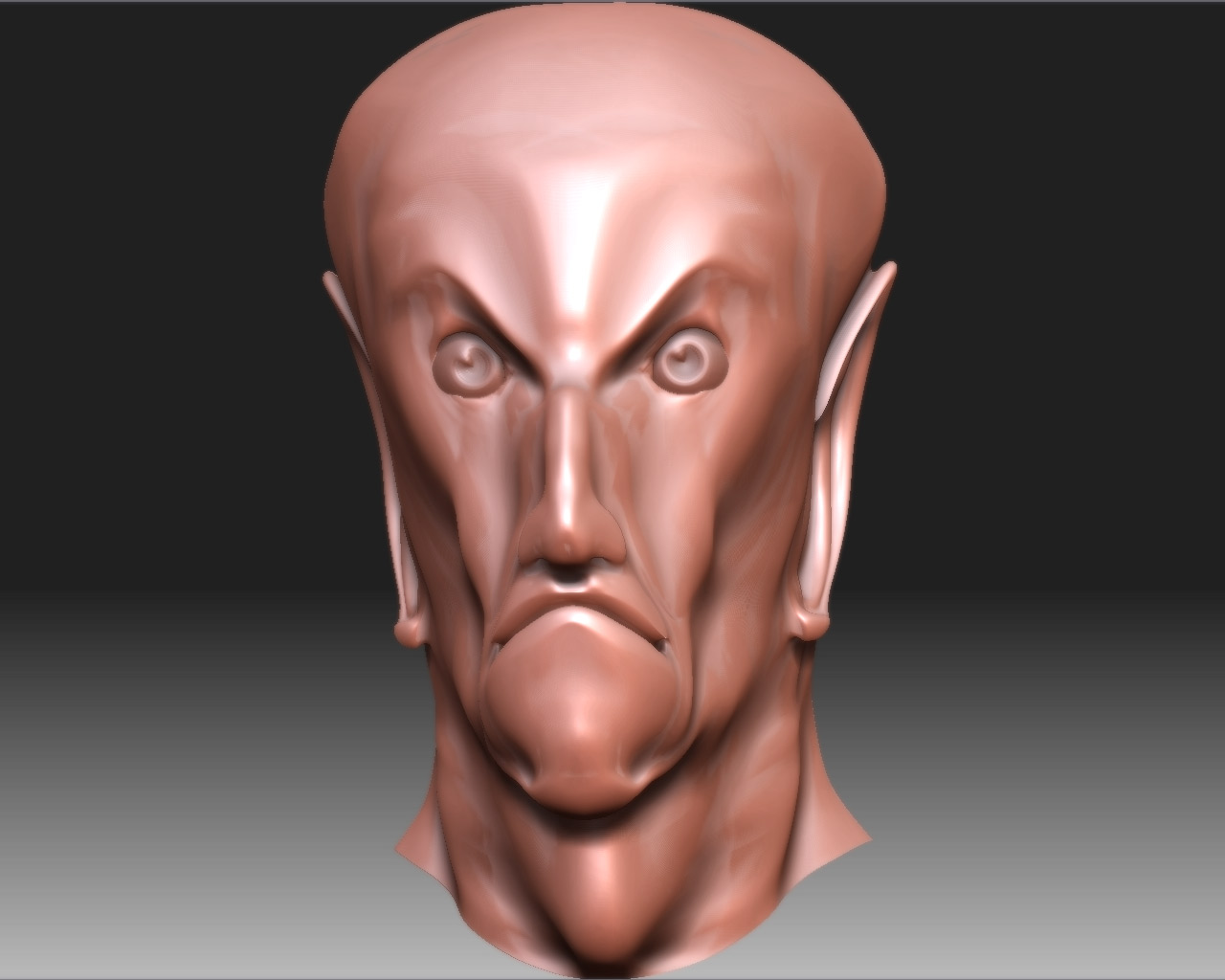

Hey Guys I figured out how to add eyes to charachters using subtools and here is the result on an alien and human heads hope you like it and still this thread is getting the “terrible”(one start) voting :laughing: …please guys tell me whats terrible so i can fix it and move on with better performance and quality through C&C :slight_smile: thanks alot for ur time and attention :smiley:
Looking at the images from the beginning of your thread to your last one above I can say you’re well on your way! All beginnings are difficult. But it seems like you are ambitious which is good. :wink:
Just don’t give up.
One suggestion: Maybe ask a friend for taking photos of his head and use them as a reference.
So far. Keep it up!
The first guy is pretty hard to judge because there is no correct anatomy to refer to.
The 2nd guy looks very good:+1:

What you need to practice is facial anatomy. Find some references and draw from them. I’ve found that drawing really improved my sculpting skills.
Keep it up and you will become great :smiley:

Santis:. thanks man I m glad tht u think so of the other one , the first is just an alien with no refrences at all :wink:

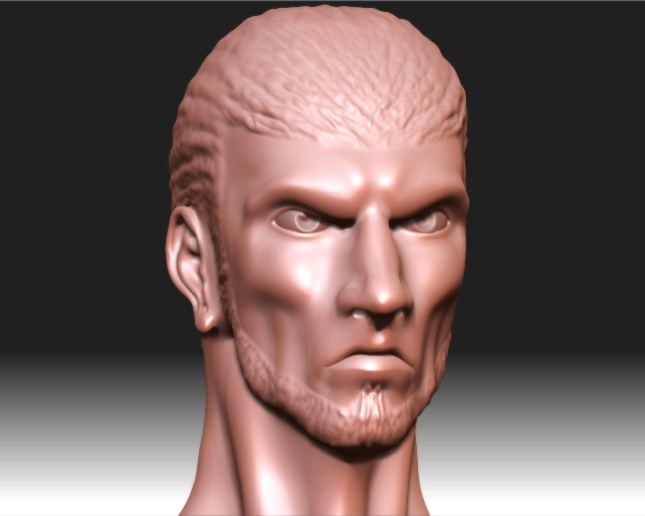

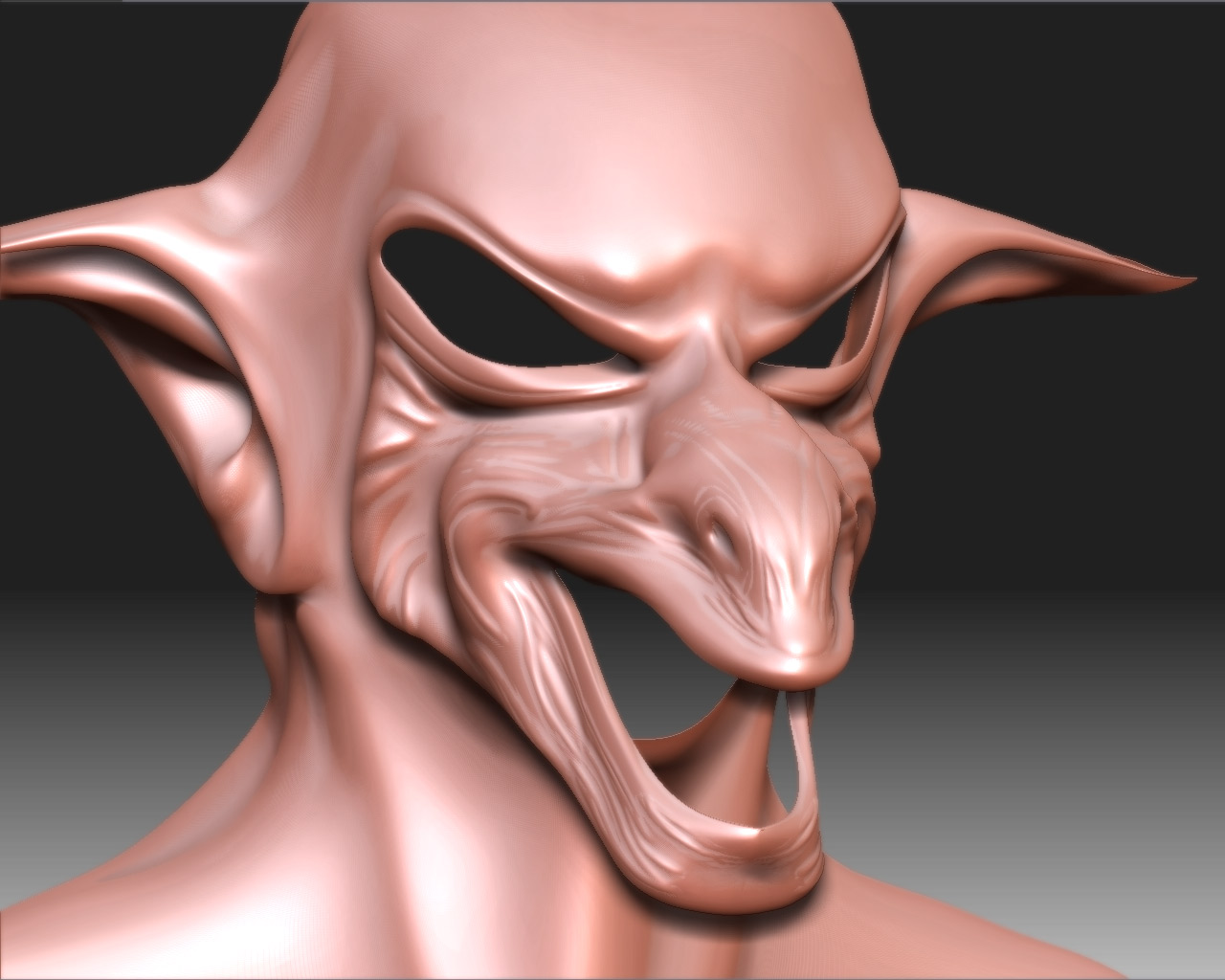

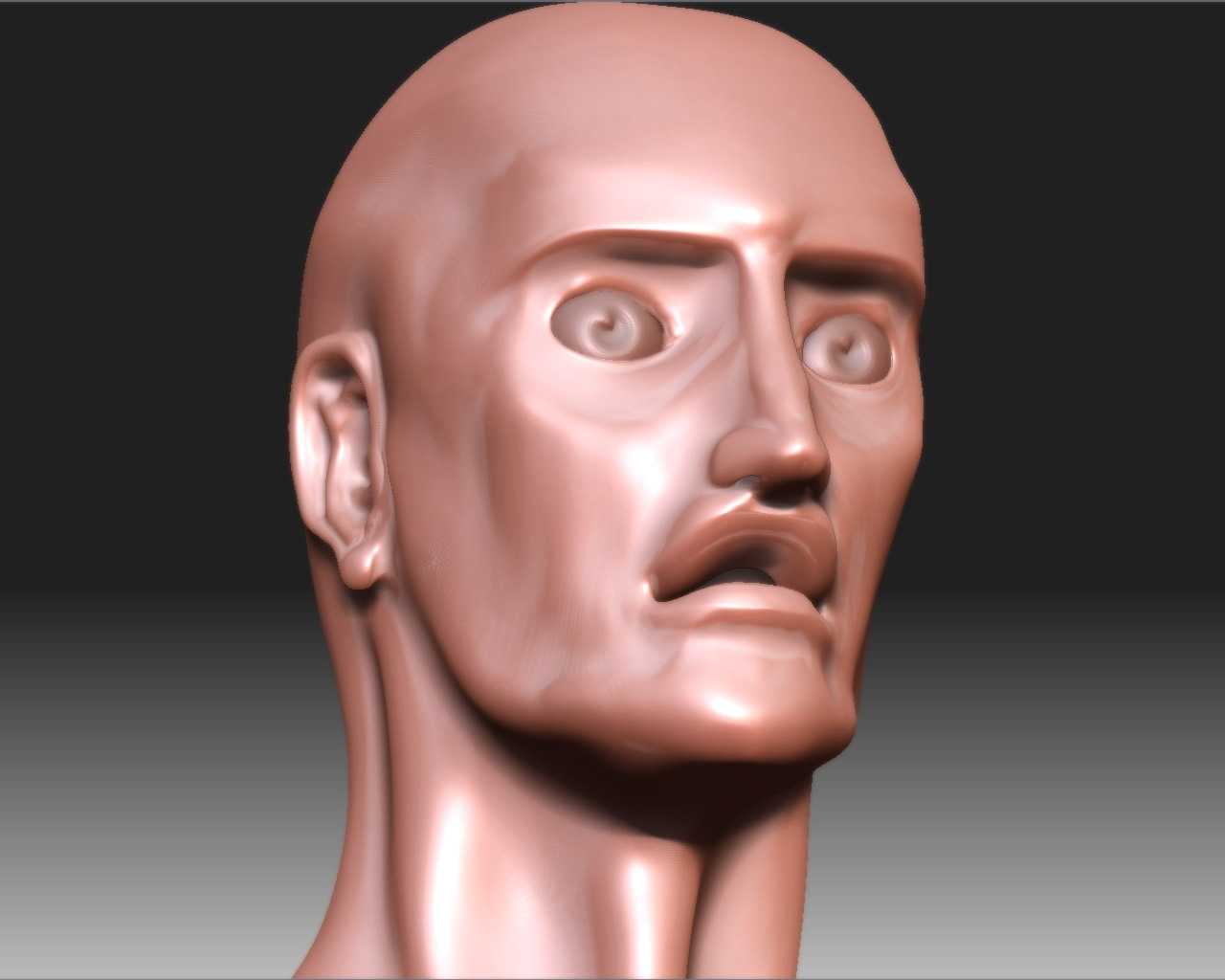

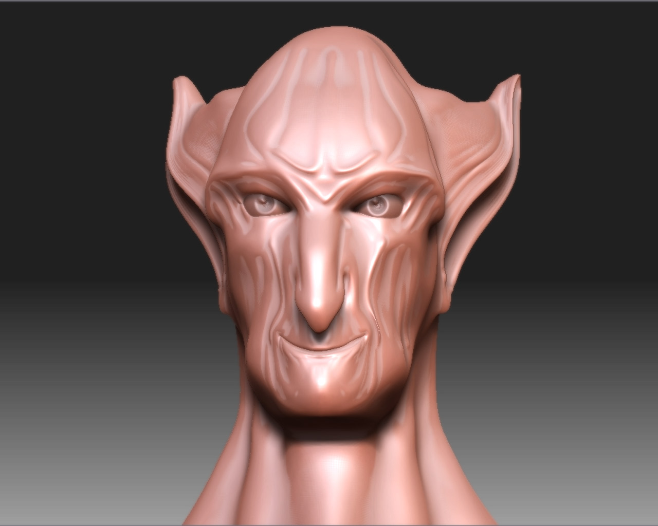

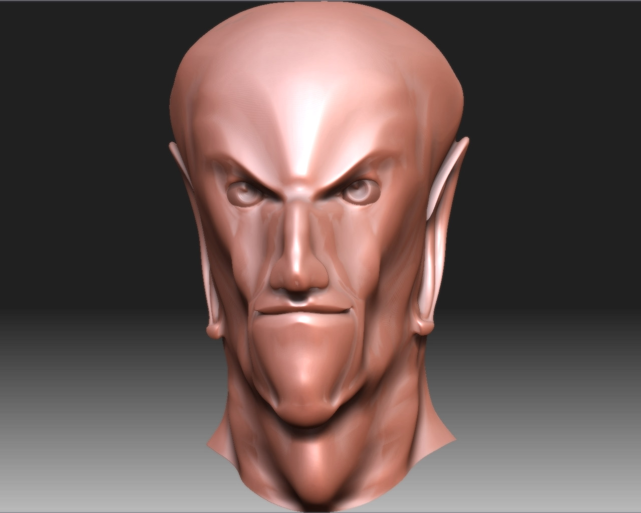

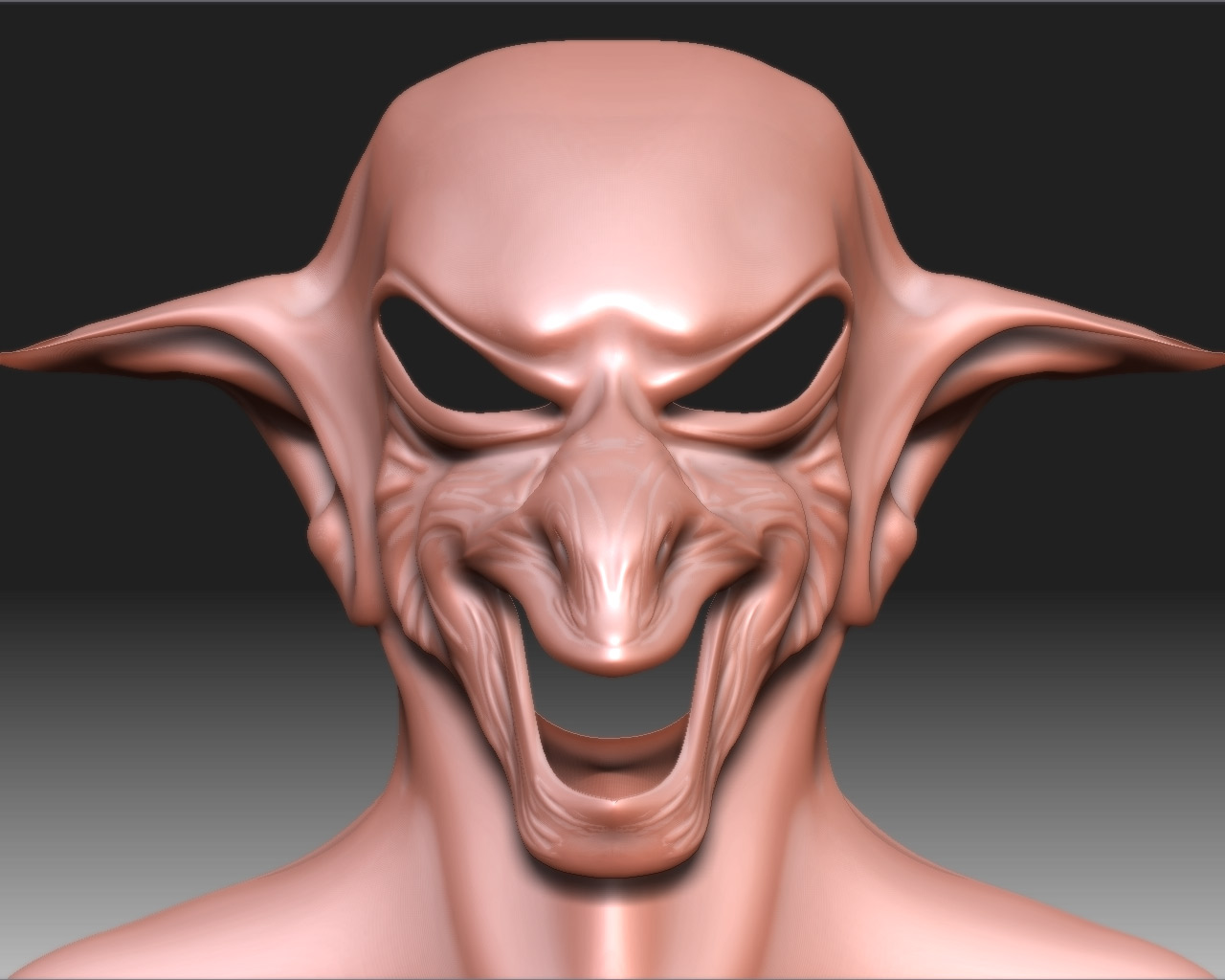

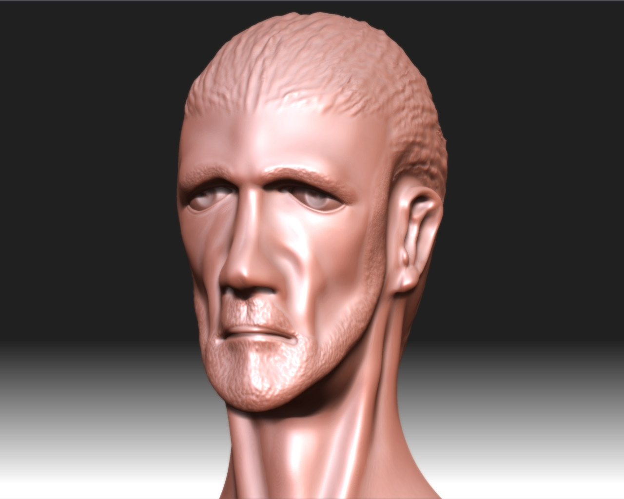

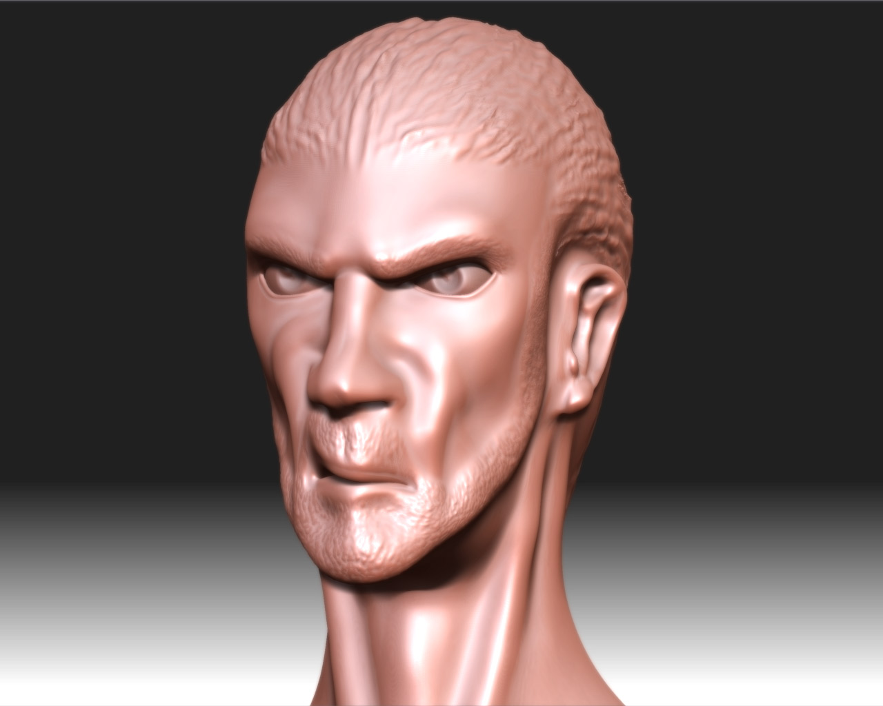

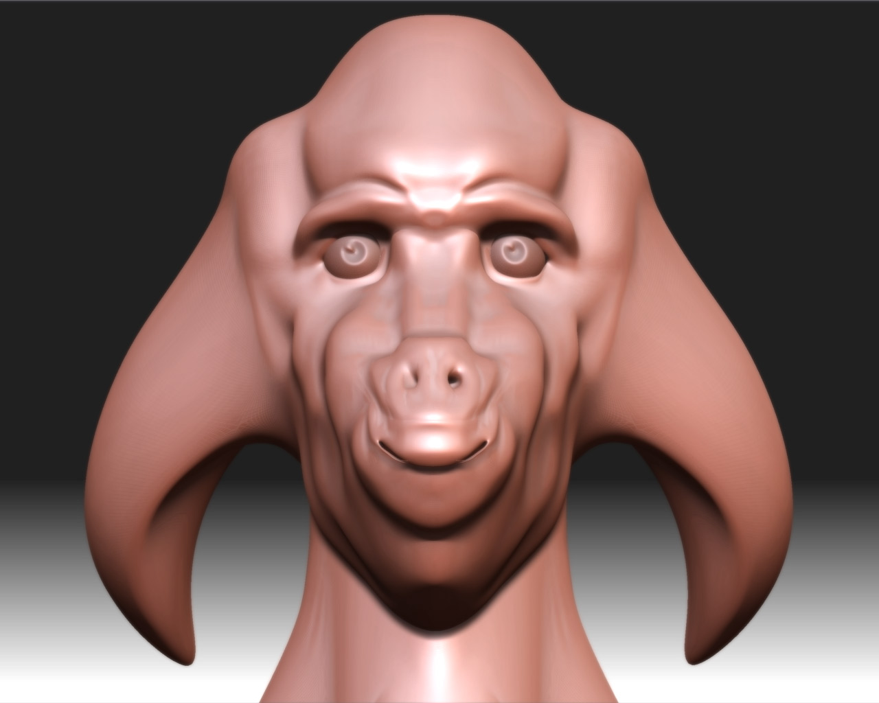

Hey guys on the new head I tried to add on some hair and beard but its not as good as other hair sculpted here in the forum so can anyone tell me about alphas that can be utilized for this purpose or anyother technique thanks alot:D and Made another wierd creature I hope you like it and C&C
Like both of them, the human is the best one in this thread so far:+1:

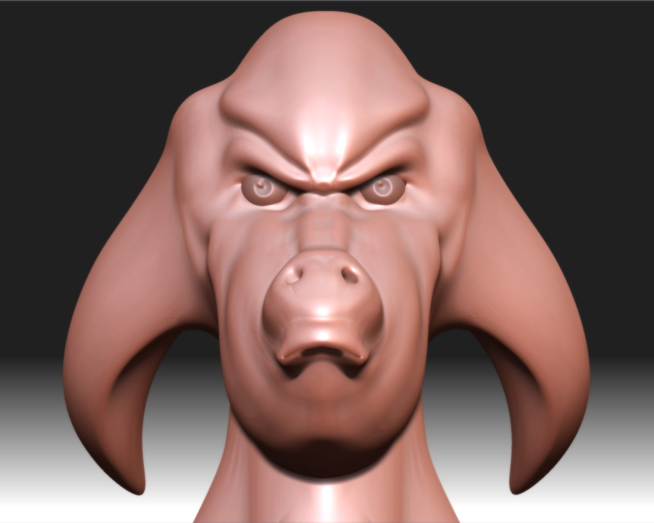

Santis:. Glad that you liked them, and I did another human and creature I hope that its not a set back but a move forward so tell me what you think?

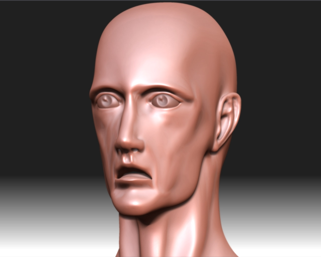

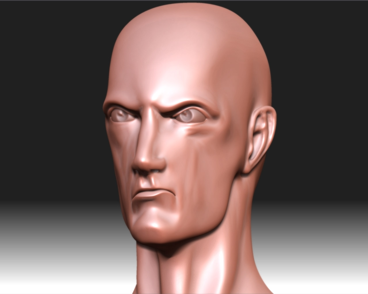

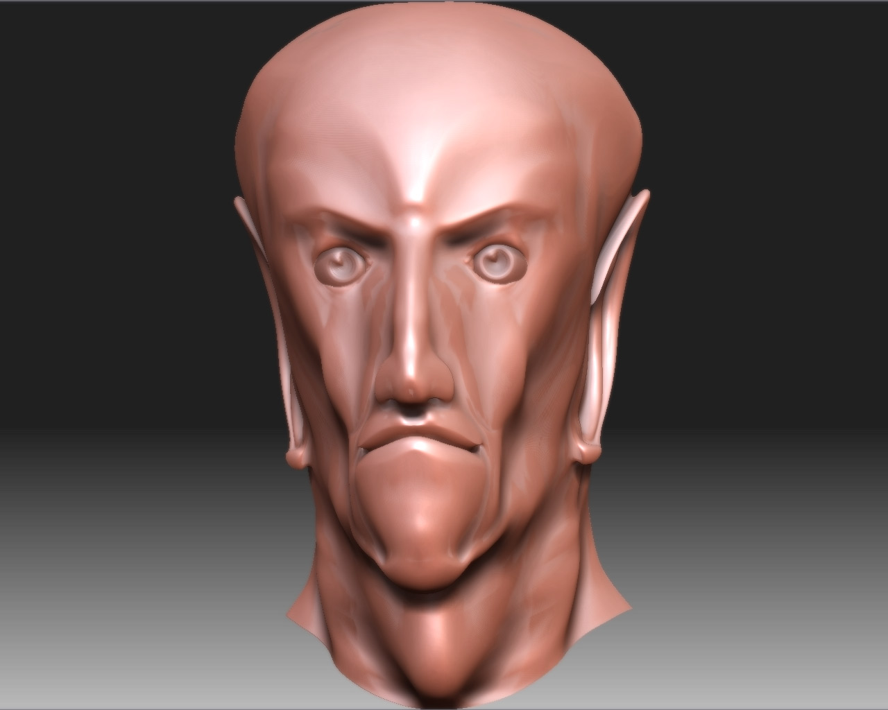

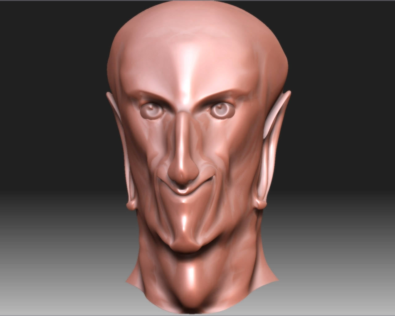

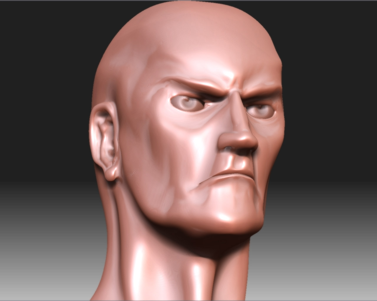

Hey everyone I took yesterday off and came back with those new heads I hope you like it and the precious C&C is always welcomed and needed
The human looks really nice, but the emotional faces feels a little bit exaggerated, try to use some refrences when you pose the :slight_smile:
Cool beast :wink:

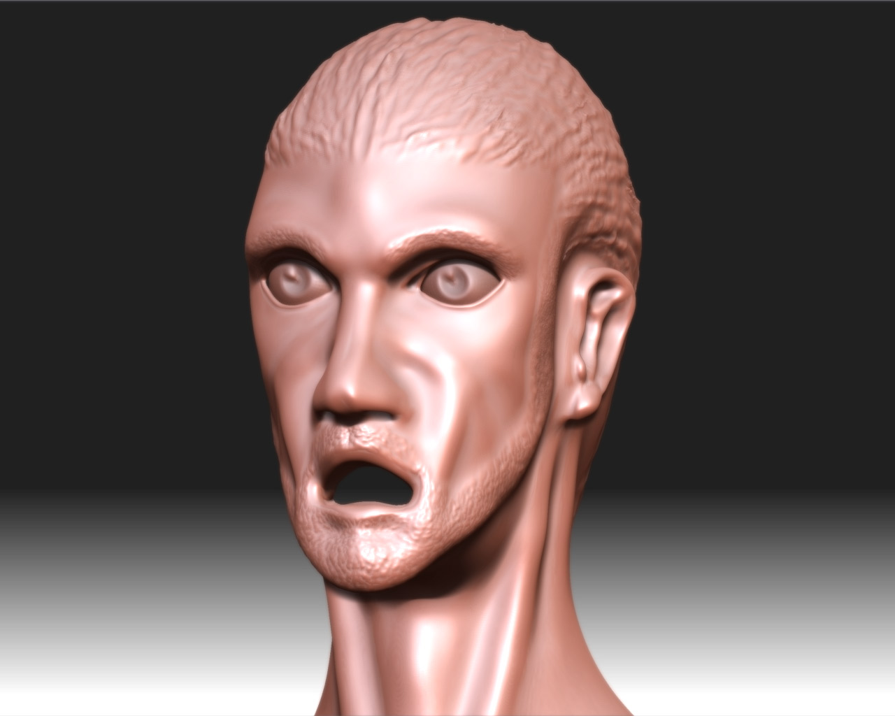

I hope you guys like this one
okay. well if you really want to get better. I would focus on 1 head and work the hell out of it until it gets really detailed and awesome. Only then should you go ahead and start a new one. I think you’re taking on too much right now. Especially for a beginner.
Also the best way to get proportions right in Zbrush it to adjust them a the lowest sub-d level. That way you may only have to move 4 polys rather than 50,000 polys depending on your mesh.
great starts. i find the facial anatomy to be a bit lacking. maybe study more facial muscles groups and i think alot more of the life will come out of these faces. great way to study and get used to the program.
Looks nice, like the seriouse one :slight_smile:
Try Jesse´s idea, detail one head, and try to get all the proportions rigth and so on.
