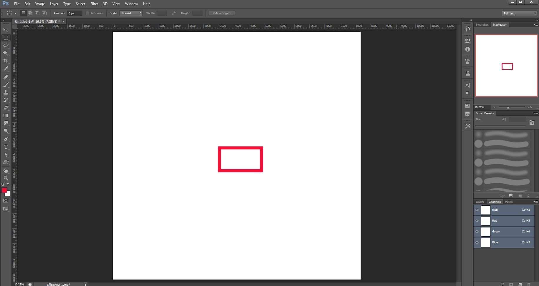

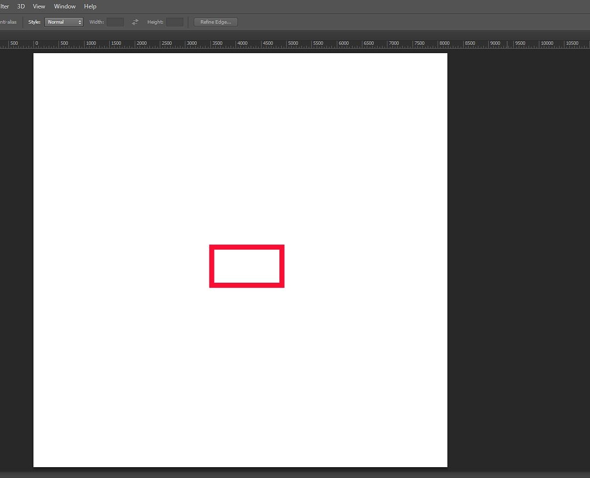

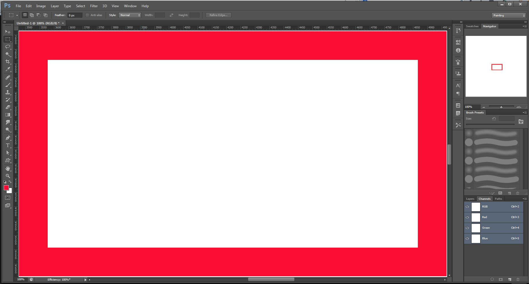

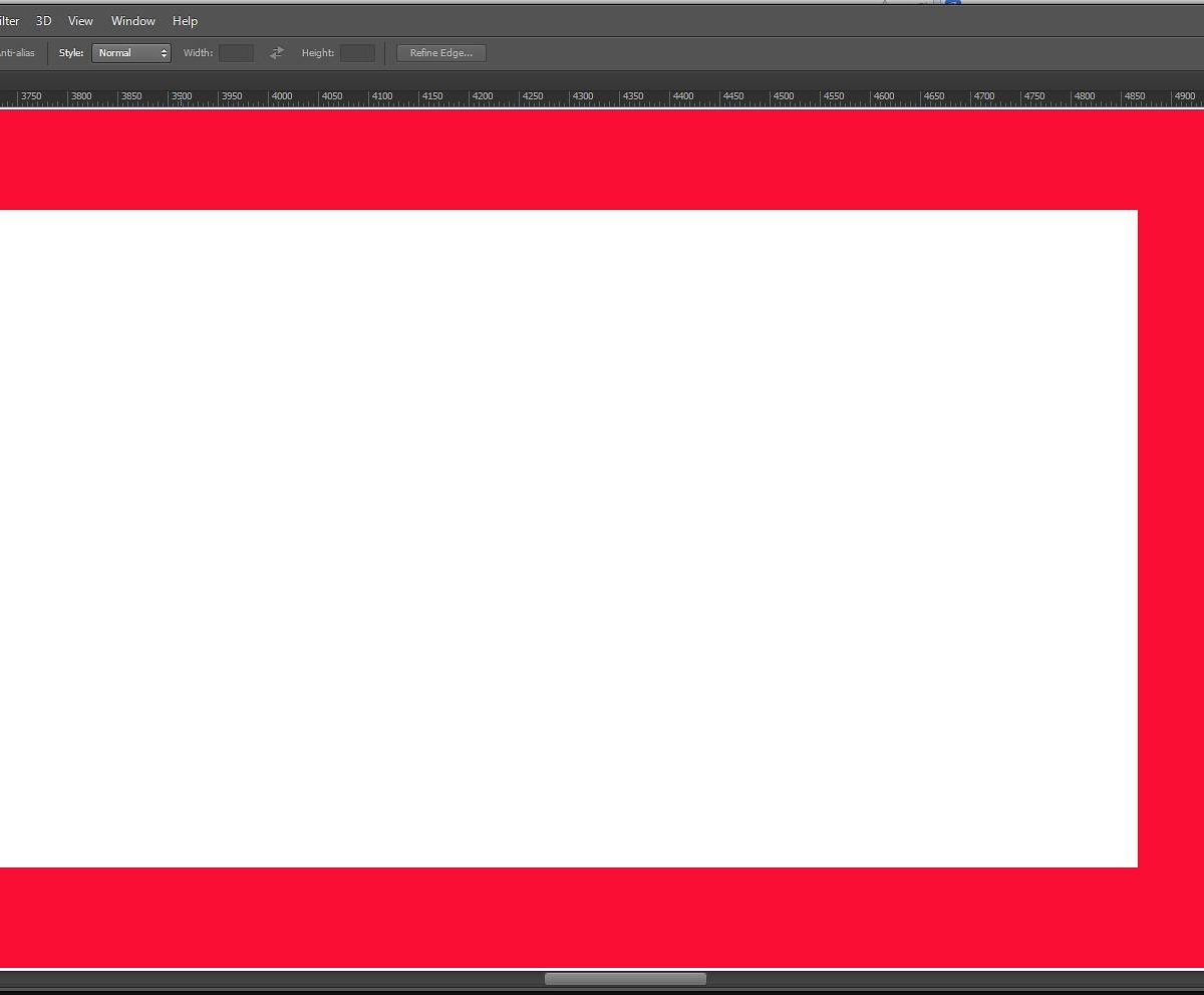

Are you absolutely sure you are outputting 8K maps from ZBrush? The attached images show an 8K map at 100% with a 100 pixel red border around what is visible on my screen, then a view showing the whole of the map (at 10.3%). There is no way I would describe an 8K map at 100% as small in size.

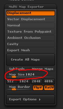

What is the map size slider in MME set to? Can you show a screengrab?
8162 is exactly where that slider you show is at. I would do a screen grab but zbrush is chewing on a test at the moment : )
