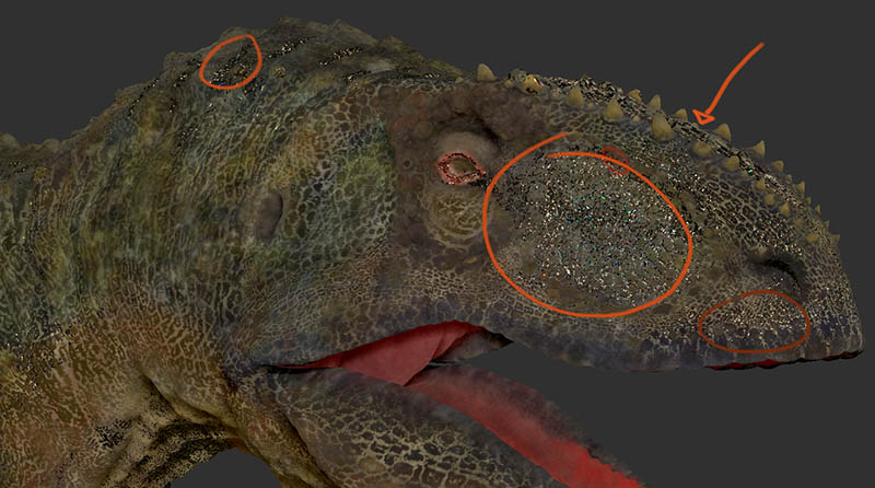

Hi, I sculpted and painted a Dinosaur, I used layers for both. Everything was going well until I tried to bake all layers. This is what happens with polypaint when I try to bake all layers:
Can anyone help me? Thanks
Pd: I don’t have any active mask, also I try erase all polygroups but doesn’t works
I’m afraid that this can sometimes happen with polypaint on layers. What you can do instead is:
  1. Turn on all your layers so that the polypaint looks as it should.
  2. Export the model as a GoZ Complete Binary format through the Tool>Export button (select the format from the dropdown list).
  3. Turn off all your layers and then delete them all.
  4. Import the GoZ version of your model that you exported at (1).
