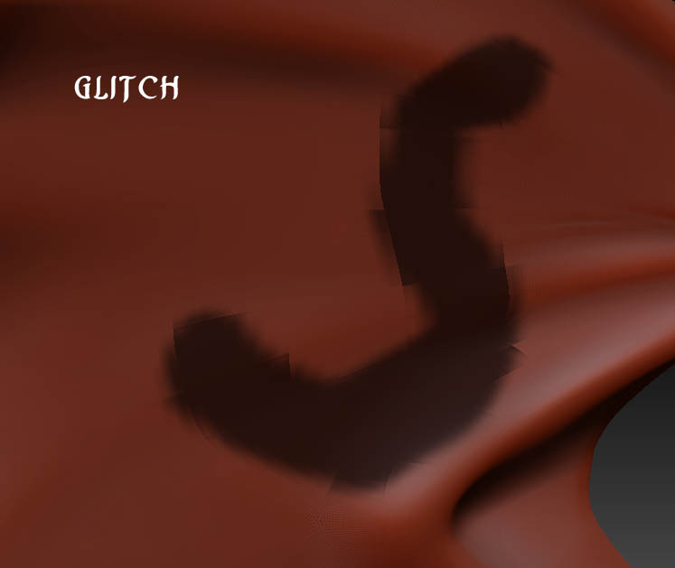

Ok …so heres my prob
Firstly this is not a problem that is just on one model and i havent noticed it preveiously …its only started happening so maybe ive changed a setting …but i have tried initializing zbrush …multiple restarts …my own uvs …guv tiles and also auv tiles and the same thing happens

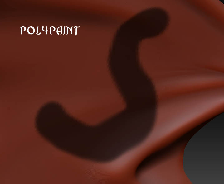

Basicly when i try to convert my polypaint details to a texture i get this
This mesh is at 7 million pollys btw
[polypaint copy.jpg](javascript:zb_insimg(‘140913’,‘glitch%20copy.jpg’,1,0))
Now this is regardless of what size texture map i have created.
Any ideas
Thanks in advance

The update is that after messing with it for 2 days i rechecked my UVS and discovered they wernt in the 1 -1 ratio box.
The thing i found strange though is that even when i used AUV or GUV instead of my laid out UVS the problem still occoured.
I guess it had some memory of the UVS i laid out or something.
Anyway …ive happily repaired the problem and can now move on to sculpting.
