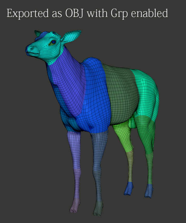

Haven’t done this in a while, but I was under the impression I could create polygroups, then export a single mesh as an OBJ with GRP turned on and when I import that same OBJ into Maya it would separate into separate meshes. This isn’t working though with the latest version of ZBrush 2021.7.1 (and Maya 2018.5).

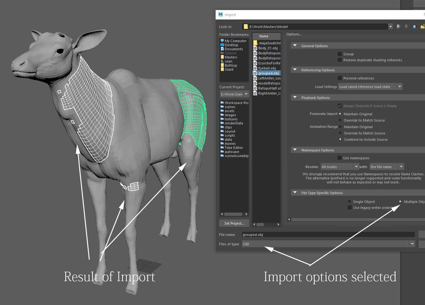

When importing an OBJ into Maya there is an option in the file dialog (when OBJ type is selected in the dropdown) under “File Type Specific Options” to import Multiple Objects. I think that will do what you want, though note that if a single polygroup is made up of separate bits in ZBrush it will be imported as separate objects.

Hi Marcus, and thanks for getting back to me, much appreciated. I have done that, but it brings in many more groups than are in the original object.
Here you can see what I’m talking about. If you (or anyone else) could test it on your end that would be amazing, just to be sure it’s a bug, in which case I can log it.
Again, this is using Maya 2018.5. And the same thing hapens if I turn on Legacy vertex ordering. It wouls seem strange that it would be an Import bug, which is why I’m thinking it might be a ZBrush Export thing since the Grp option was moved to the Preferences. (I’m using ZBrush 2021.7.1)

hi,l also found this bug today, if you import obj format model to maya,the model won’t separate into correct group ,after try many times, l think it is a bug
