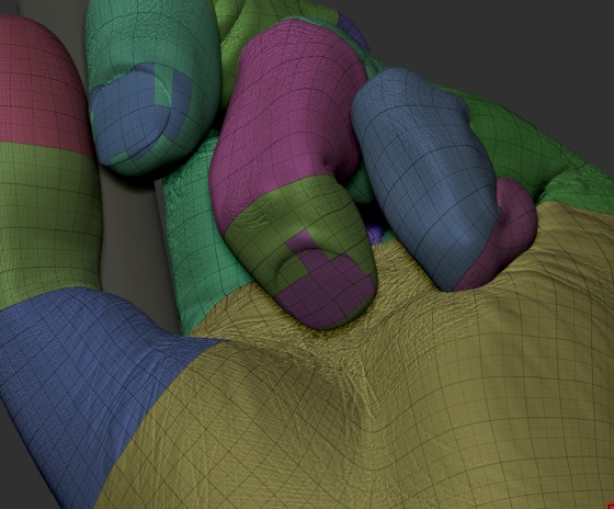

Hi everybody
I have a tool with 7 Sdiv levels, I make a new Polygroup.
But If I go down to lower levels and come back to 7, I lose my polygroups.
I do something wrong?.. it is a bug?
ZB 4r4. on Mac

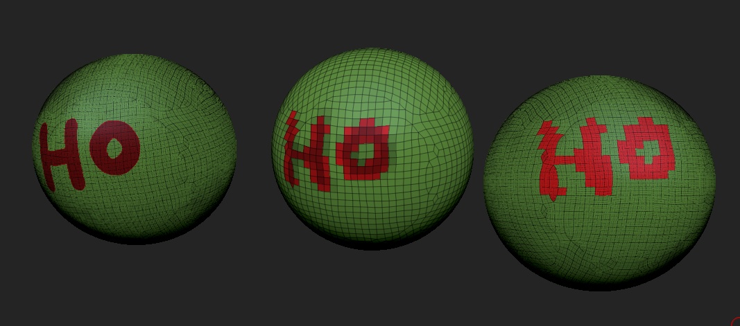

You should always be making your polygroups on the lowest subdivision level. This is what happens if you don’t.
