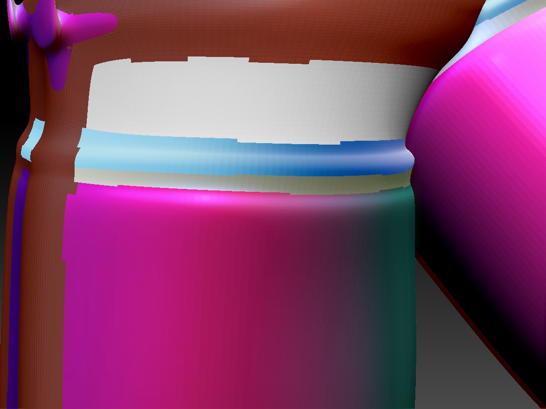

How do I prevent material and or PolyPaint from spilling from one group into the one next to it?
This happens always, in all of the versions of ZBrush I have used starting at 4.0.
Essentially what I do is hide all the PolyGroups I dont want to work on, then color, or add material to the one(s) I do, I do this by using the usual stuff, Fill Object in the Color Palette, or using PolyPaint. When I unhide the other PolyGroups this is what I get, It shows up in ZBrush renders and KeyShot like crazy.
Here’s a picture of what I mean:
Cheers, and thanks again!
Mealea

I am actually doing exactly what Zber described below as the correct way of doing this, I make my polygroups at the lowest (actualy when there are none) subdivision level. Once I am done doing that, I add as many subdivisions as I can and begin changing the materials (or polypainting, or both), I make it as high as possible because it’s such a visible problem I can’t render things without it being obvious like the example above.
At the bottom is a video, I dont know how to make it go slower, and it’s so fast it’s nearly impossible to see what’s happening…

OK, I checked further and it seems to be a problem when using MatCap materials. It doesn’t do it when using Standard Materials. I tried different things trying to get it to work with MatCaps, but no joy.

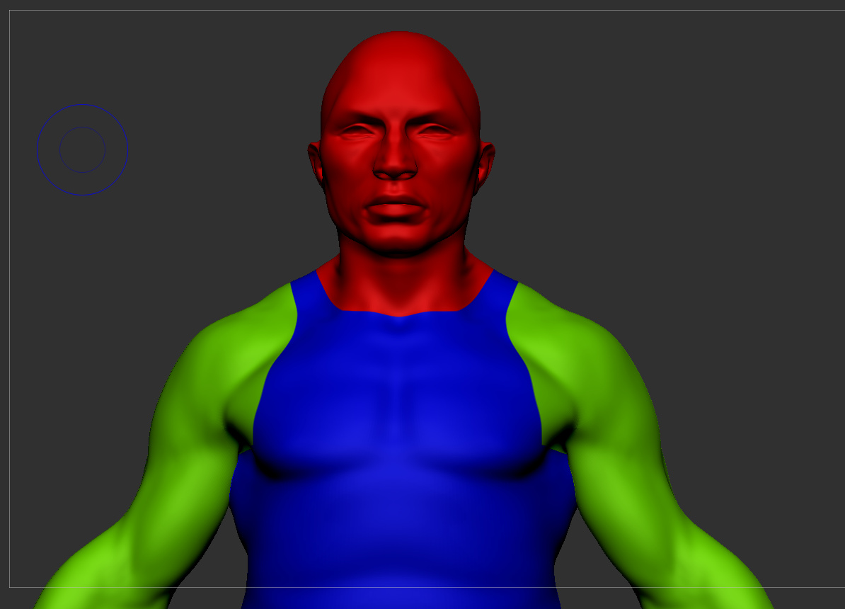

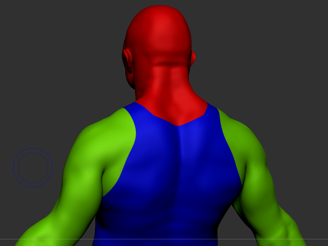

This is the result I get using Standard Materials. It’s not a 100%, but the bleeding is very minor. You will get a slight bit of bleeding across polygroups, that’s inevitable, but the higher the mesh resolution, the less noticeable it is. The image below has 6 subdivision levels. Regardless of that though, it’s still crappy when using MatCaps.

You are right, it does do it with Standard Materials as well if you use a different material for each group. I was using the same material for all groups. However, when you do a Groups Split, then fill when they are separate subtools, you can fill with different materials and you won’t get any bleeding. I don’t know how that would translate over to Keyshot because I don’t have Keyshot.
