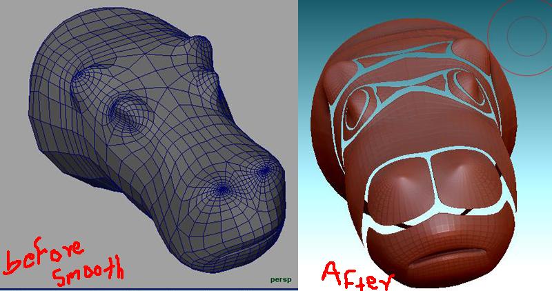

I made base with zsphere and export into maya,and after made change when sub dividing in zbrush i got this type smoothing on uv groups,i want to make it a one group mesh.please help me,tried a lot and tired.please…please anyone

This is probably due to some unmerged vertices.
Thats all i can think of.
regard
deven
when you export to Maya zsphere made with a base, the base will mesh with the parties separated, you must combine the vertices of each part separately and then return to zbrush separating the groups down menu of each party.

Cristian Rio:thanks a lot for you reply.but even after just combining the different parts,it again happened…

I’m not a Maya person but I think…
  1. Use ‘Group Visible’ to remove all groups before you export to Maya.
OR
  1. Try turning on ‘Weld’ (to some low value) in the ‘Import’ menu to keep
    the re-imported groups together.
G.
thanks a lot, i used group visible and exported and again make changes.thanks.problem is solved.
but is it possible to preserve the polygroup and make changes in maya?
as Grey32 friend said:
Clik the Use Group Visible Polygons, this will solve the problem. Just do it and nothing else!
Surely this resolves the problem, I did a test on a model and it worked!
If you have any questions, please let me know!
I think the second method will allow you to preserve the groups.
Don’t use ‘Group Visible’ but export all the groups as usual, then set
‘Weld’ under the Import menu to a small (non-zero) value before
importing back into ZBrush.
