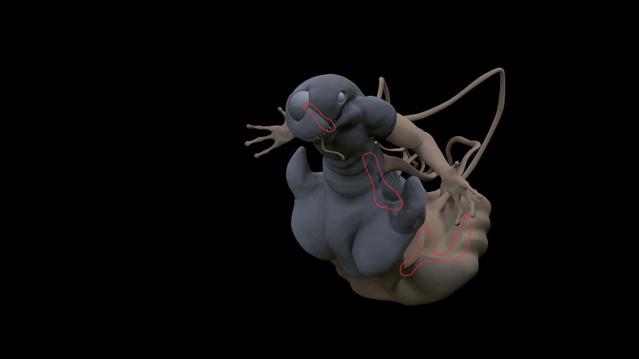

And when i assign zBrush genreated normal map to my model strange artifacts occurs. I’m not sure that it’s seams but look very alike.

here’s error screen

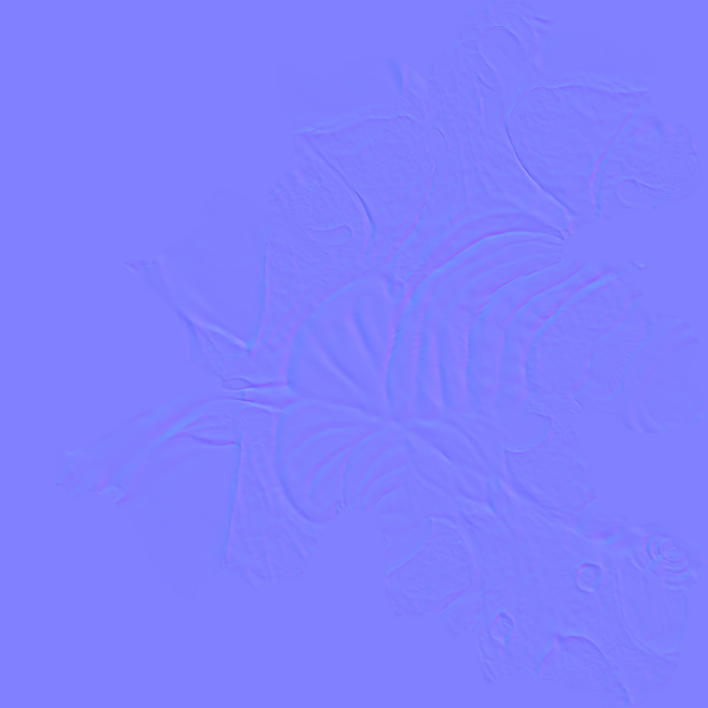

Can we see your normal map, UVs and an image showing the problem? I can’t tell what I’m looking at so I don’t see any problems in what you’re showing in your first image.

On this image i’ve marked problem zones.

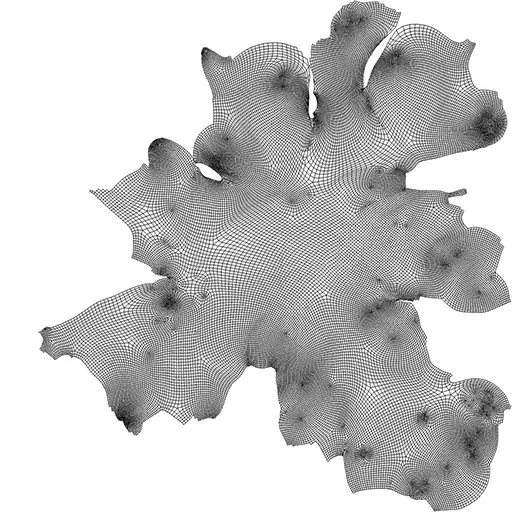

this is my normal map.
and UV snapshot.

It might boil down to how you have the model/material set up in Maya (a program I’m not familiar with); loading up your files worked in Softimage using both a realtime shader and with Mental Ray (I had to uncheck unbiased tangents for that one though)
You know. It could have been model/material problem, but i tried different materials (including standard lambert) and it gives such problems anyway.
