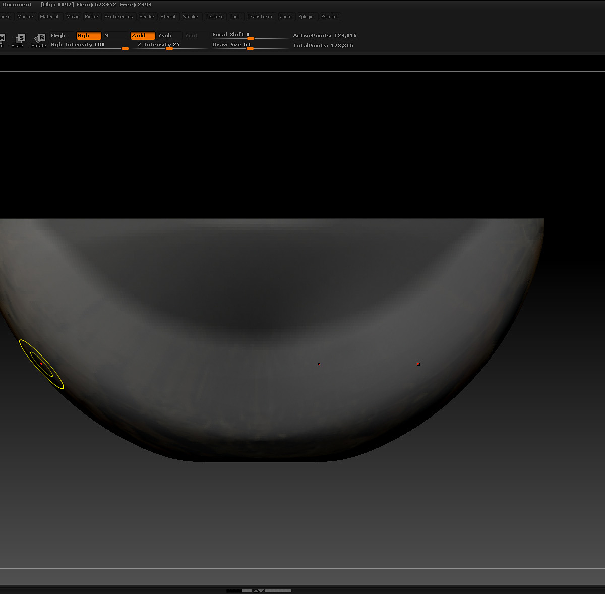

I’m trying to use an alpha to mask parts of a tool for extraction, and sometimes it works, but most of time it just masks the whole tool. I’m holding down ctrl and think I’m doing things right. Please let me know what I should do.
Try being in the standard brush, alpha on (the butterfly you have there), and make sure the stroke is “DragRect” and hold down the control key while masking and it should work.
Okay thanks veryuch - will try that.
