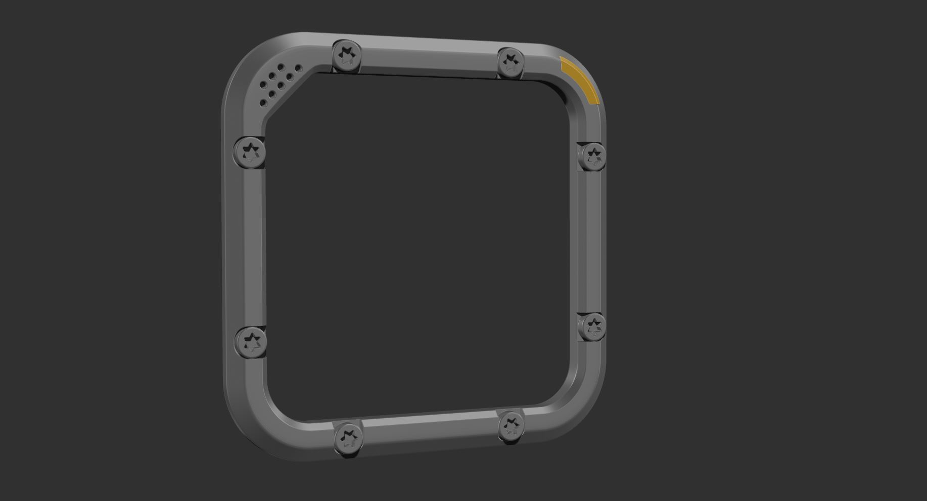

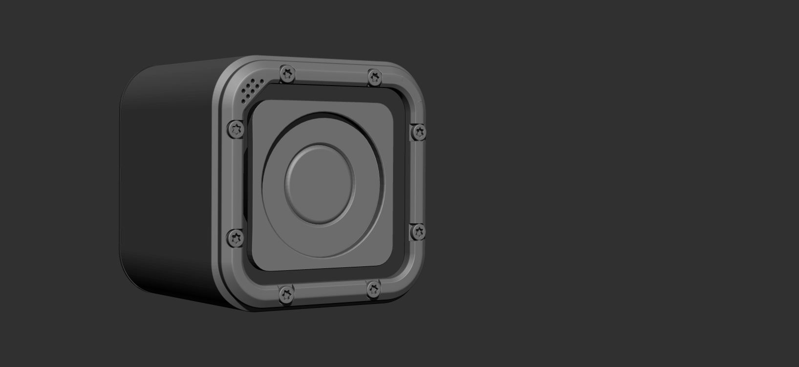

Great update on ZB. I instantly had to do some testing with the new boolean. Together with the new Gizmo and the zModeler it is quite powerful. I was really fumbling around, but that is also due to some absense lately on the ZB front :slight_smile:
I still find it strange that the split edge is unable to do the basic operation it should do. Compared to any other software it behaves really strange and I can not use it without spending 10 minutes cleaning up the mess it creates. Feel free to share some workflows on the split poly tool if you have any nice ways to do it.
Here is the result and some videos showing the play session :slight_smile:

It is a GoPro Session. Just needed to find something cool hard surface to try out all the boolean magic on.
There are some nice bended cuts on the main frame I am about to do which will utilize a lot of the new tools. Super cool. Look forward to that.
Meanwhile I have been trying to just get the main frame set up.

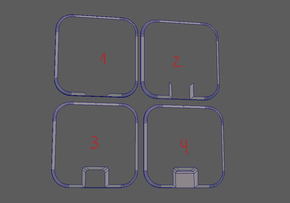

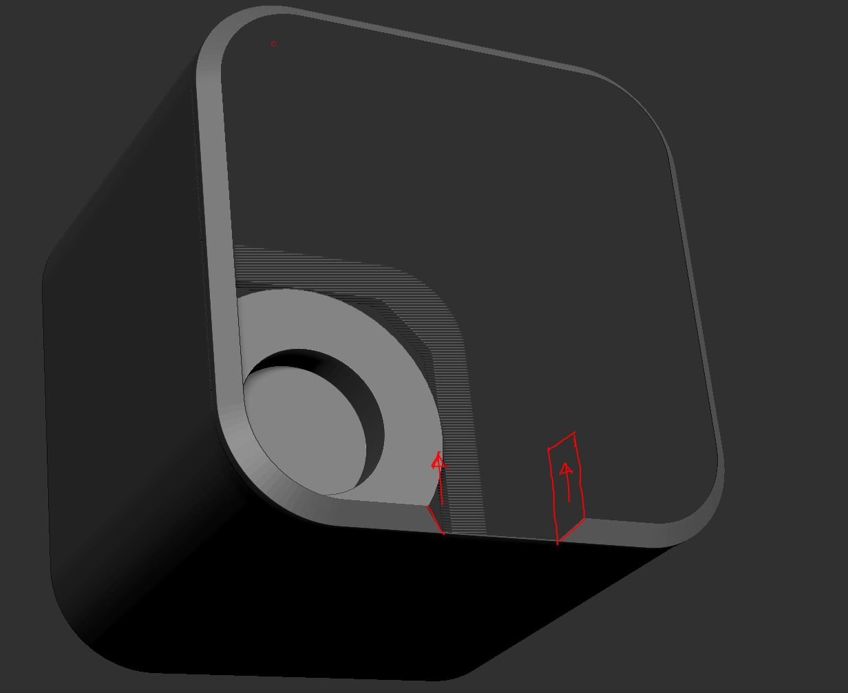

Another thing I find strange is the extrude edge. It does not work anything as expected. If you f.ex have an open hole in the center of a cylinder plane and want to
extrude a loop in towards the center you are left with some weird extrude where it builds a triangle fill under to mesh the whole thing instead of just… well
extrude the edge. this has left me stuck several times so I am about to dig up some Durst videos from r7 :slight_smile:

This is simply another limitation of Zbrush. At this time it cannot extrude 2d geometry from an edge into empty space without connecting it to something else. This doesn’t work with transpose extrusion either. I can imagine situations where this would create geometry that Zbrush wouldn’t understand. You can connect two edges along an upon hole with the Edge > Bridge command.
Remember, Zbrush ideally wants everything to be a closed volume, preferably made of quads–this is what it understands best. From a design standpoint, the developers are always working towards ways to free users from having to be overly concerned with micro geometry at the vertex level, trying to let users focus on artistry rather than technical work whenever possible. Keeping those in mind, you get a sense of when you will be using Zbrush to its strengths, and when you might want a different tool if you’ve got a lot of a specific type of work to do.

  3. extrude edge limitation can probably be bypassed by bridging it to another edge. Split it and then delete the remains. Problem is that that takes longer than it should.
    A classic example is attached. Here I just need the edge to extrude up to create the rest of the remaining flow of the ring.
    I know that I should probably use Maya for these kind of things, but I really wish for Zbrush to get these minor things in and you could in theory kill Maya completely for a lot of things.
    Combining a more developed zModeler with Live booleans would be amazing.
I can’t be certain whats going on in that pic without a polyframe, but it looks like you could just bridge the two edges on the right and left of that gap.
Just remember Zbrush is a box-modeler, and works best when dealing with closed, 3d volumes. Using it to model open 2d geometry is not using the tool to its strengths, like trying to unscrew a bolt with a pair of pliers. You might get the job done, but it’s not its intended purpose, and a wrench would be far more efficient.
I just want to extrude that single edge up to create a face…
This took me literaly 10 seconds to do in Maya :wink:
I know Zbrush is not intended to manage all polyModeling toolsets, but I find it weird that when you have awesome stuff like QMesh and other nifty things, you have none of the basics…
Well, yes, but they aren’t “basics” for zbrush. ZModeler represented a very advanced leap forward for zbrush, something that took them more than 15 years to get into the program. Zbrush has a specialist architecture, allowing it to do things no other program can, but also giving it some limitations on things that are much easier in other programs. Likewise, things that are basics in Zbrush, are beyond the reach of most other programs. We’ve already established that Zbrush is not strong at 2d surface editing, so what you’re trying to do there is not using it to its strengths.
You must adopt a box-modeling mindset with Zmodeler. That’s what it’s good at currently. If you insist on trying to model things as you might in a program that is good at drawing out 2d surfaces point by point, you’re going to keep butting up against its limitations. It would be much easier to box model what you’re trying to do there in Zbrush. I’m afraid you have to either accept that, or work with a tool that is designed to accommodate your modeling technique.
As for specific advice to your illustration, I would be modeling that object as a solid mass. It would be much easier to do what you’re doing there if that was a solid surface you could divide at will. You know that zbrush cant extrude an edge and leave it hanging in space, so it would be best to eliminate that technique from your toolbox when considering how to model something in Zbrush. From where you are now you will have to insert geometry on the opposing side letting you bridge to the other side evenly, and then divide those bridged polygons and delete what you don’t need if you’re determined to stick to that technique in Zbrush.

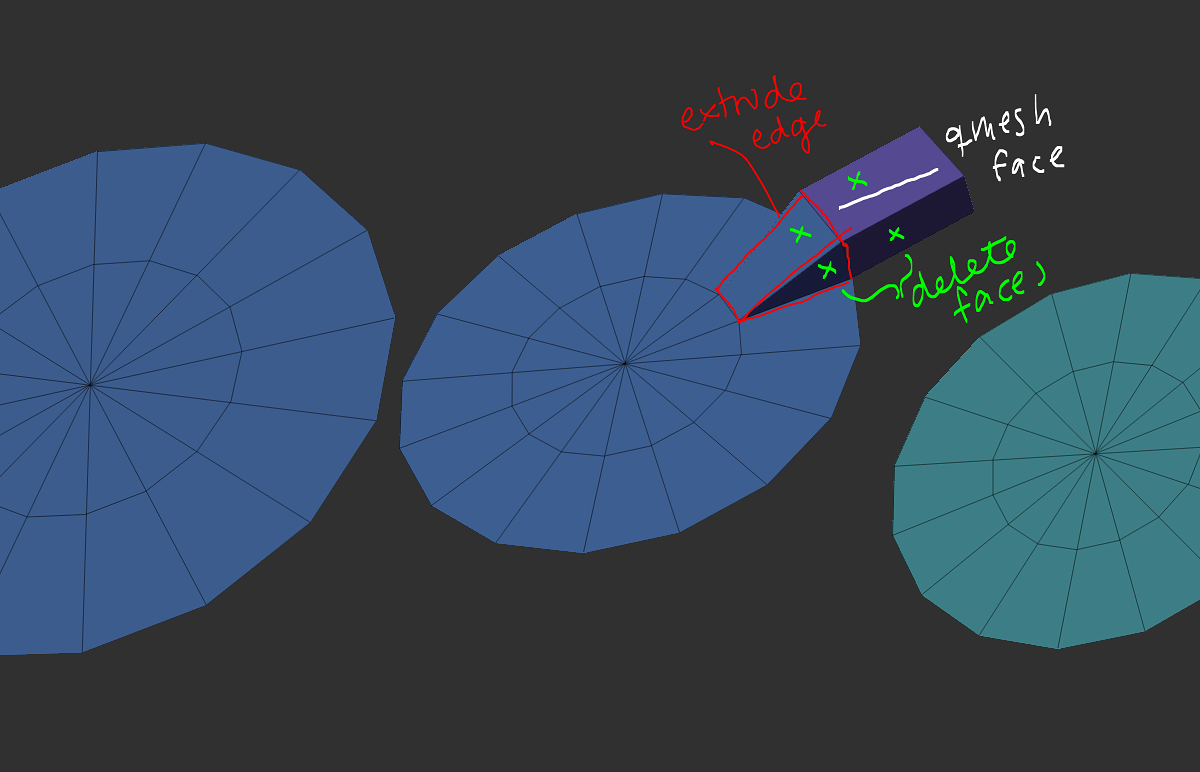

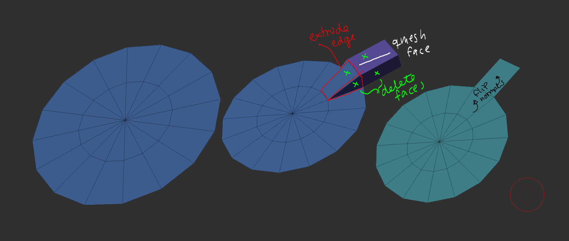

Here is a hack to extrude an edge :slight_smile:
