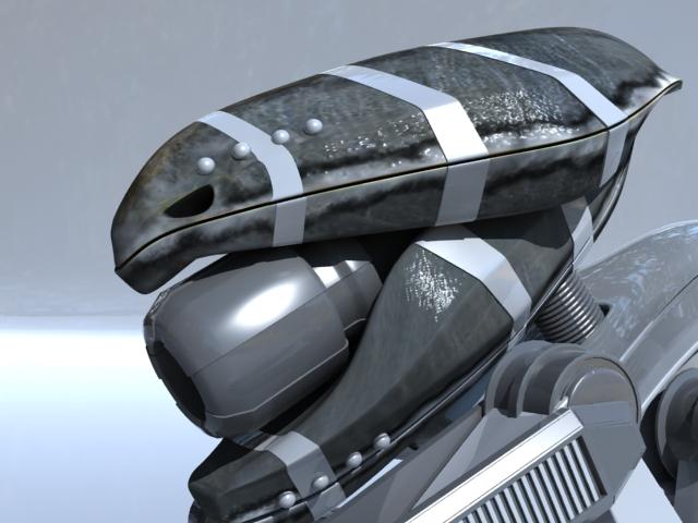

Hiii here is my first try using the pixel to pixol plugin I just wanted to know why does is it look like low res texture??? Copy of 3.jpg
Although when I applied texture it was 1024*1024 and the pics I used to texture the model are high res so why?!?the low resolution look??!?
IF you get a 1-to-1 ratio between the pixols on the screen and the pixels of the texture, then you will get a good transfer from canvas to model.
However, 1024x1024 is not a large texture for a model. It’s pretty small.
Now, let’s say that the hi-res image you used for the texturing is 2048x2048. There is no way to get 2048x2048 worth of image onto a 1024x1024 texture. The 1024x1024 texture has only 1/4 of the pixels that a 2048x2048 texture has.
