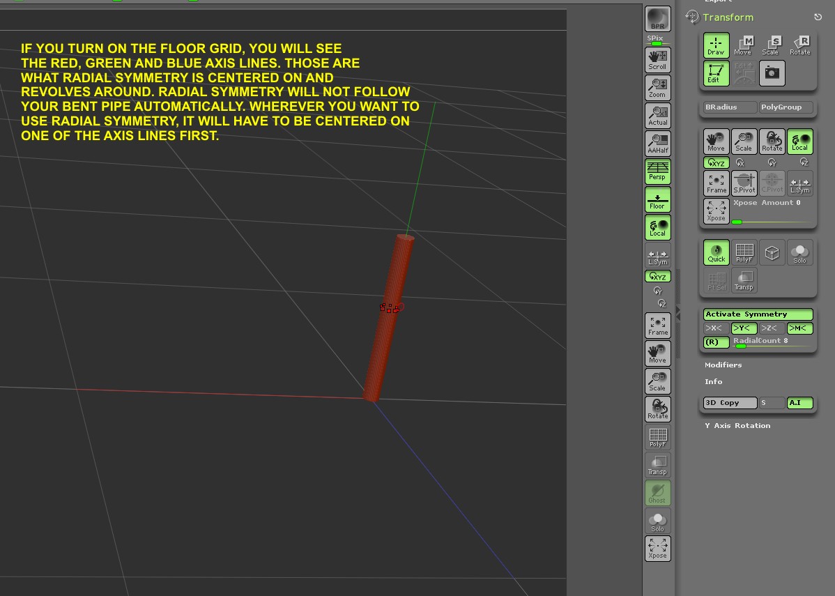

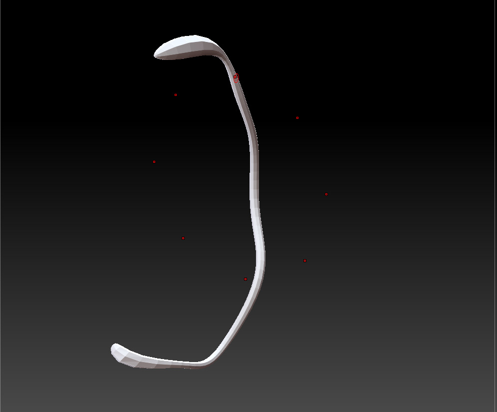

so it looks like you have to sculpt on a straight piece of pipe first then deform it to the desired shape, which is a little awkward.
i was doing a guy with lots of pipes coming out of his head and using zspheres to create the pipes (and theres alot of them) and i was conforming them to each and his head etc and i then needed to sculpt a radial design around the circumference of the pipes and of course i found that you couldnt use the radial symetery, which is a little frustrating…
