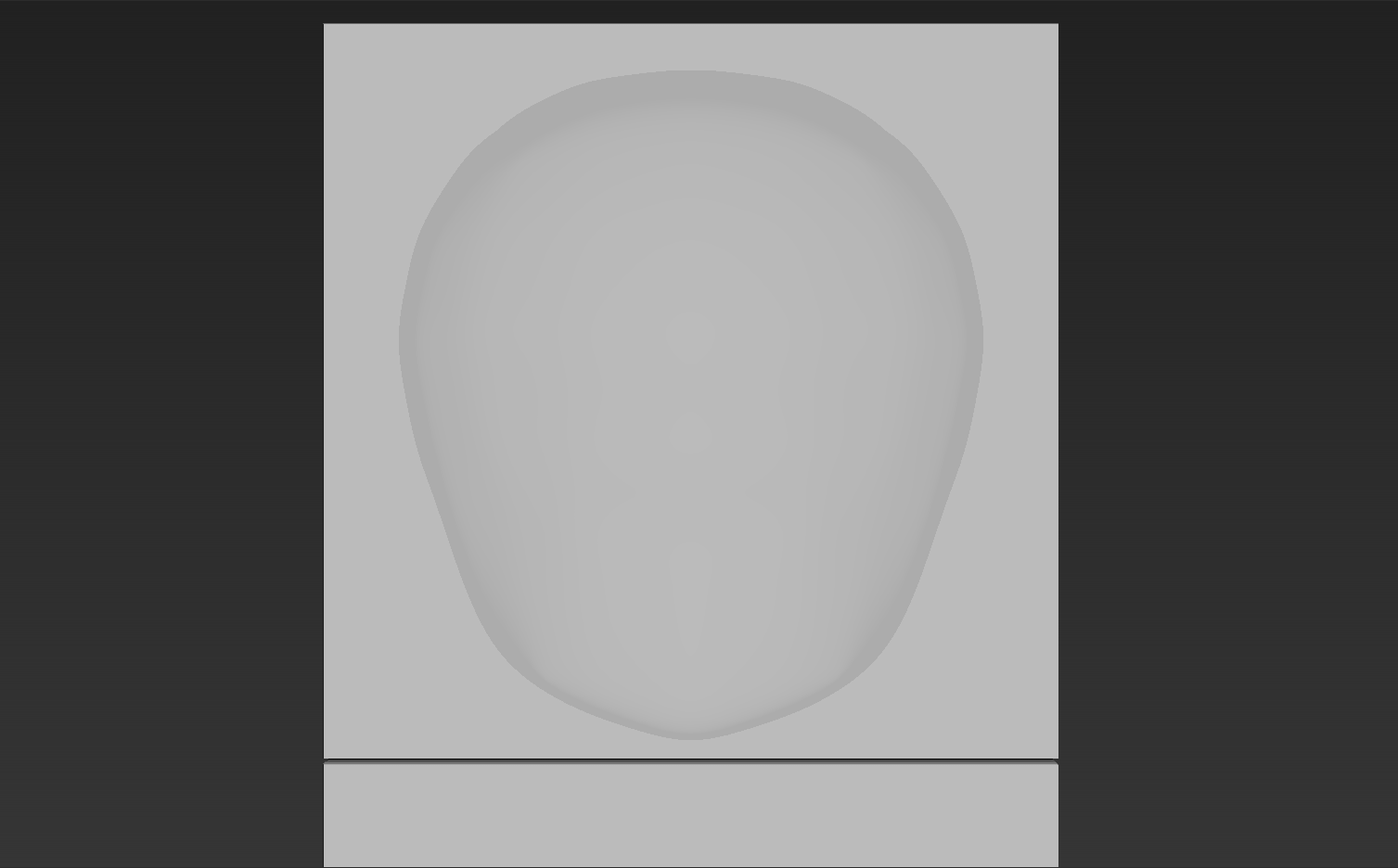

I’ve never noticed this before. When ever I import or append a certain mesh, it changes the angle of view to the point that there isn’t that much difference between perspective, and orthographic view. I provided some pics to show what I mean. The angle of view slider does relatively nothing after import. This is very frustrating because I am using precise measurements based on what I see on the previous angle of view, before import. It has happened to similar files.

I just tried appending a regular cube, and the same thing happens, only the change is almost insignificant, but there IS a change in the angle of view. On the previous post, the imported or appended ztool I am speaking of are just 4 cubes stacked on top of each other, but of course this makes that object a lot taller than that single cube I used just now. There IS an issue, and I am wondering if this has anything to do with the size of what you import or append on to the canvas.

I tried a lot of things after my last post and found that it was indeed the Dynamic Perspective button that should always be turned off, other wise, it would cause changes in the FOV / AOV if I apply something bigger onto the canvas. ( just my case ) What I was doing was applying measurement guides in the form of cubes, but it affected the fov and the face changed to the point that I couldn’t work with the face looking like that with the fear that it would look completely different than what I originally envisioned it would be, even inside zbrush. I’ll just have to do all the work I’ve done all over again, but I’m thinking it’s not such a big deal since I just started learning how to use the zmodeler brush and the circumstance gave me a good opportunity to try changing my work flow. Thank you for replying though, have a good day.
