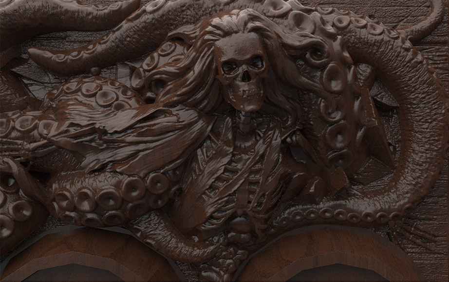

Hi All!

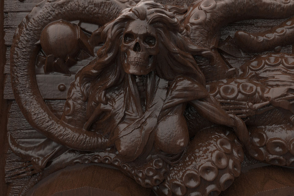

Model for CNC. Size 2300x800x370 mm.
Modeling ZBrush, rendering KeyShot.
I hope you enjoy…

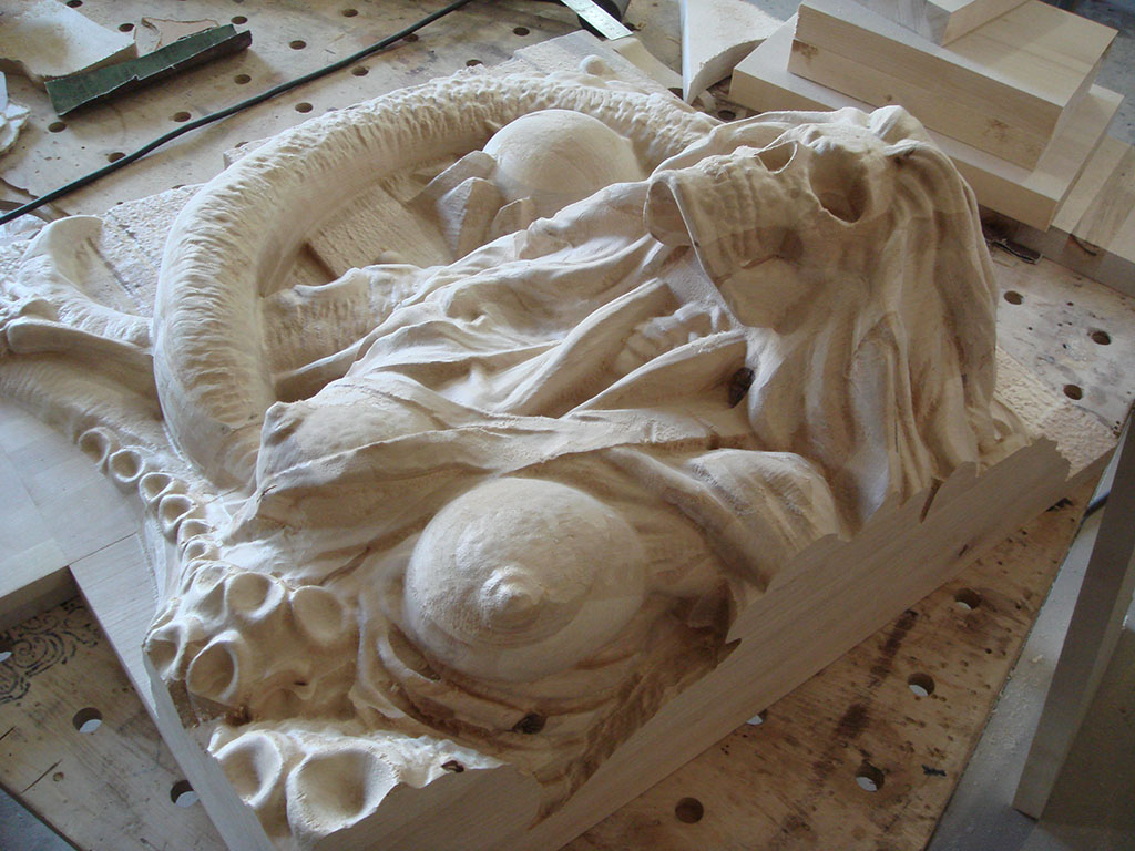

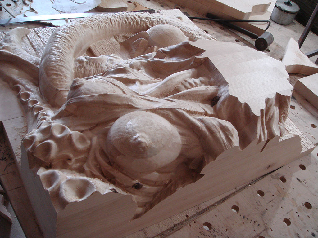

Hi All!

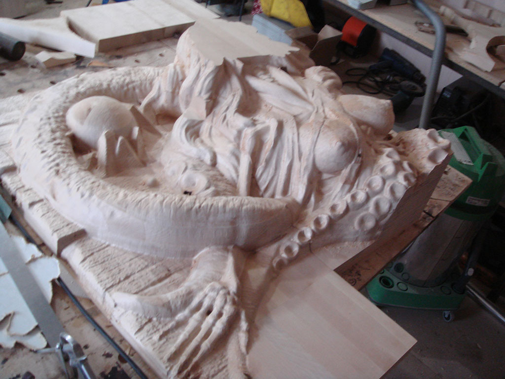

Working progress. The model is made in ZBrush for CNC.
Wood - Birch.
Thickness 360 mm.
I hope you enjoy.

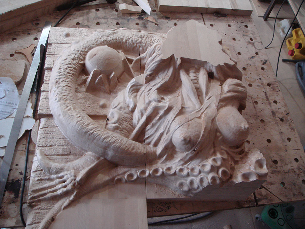

Hi All!
A small upgrade

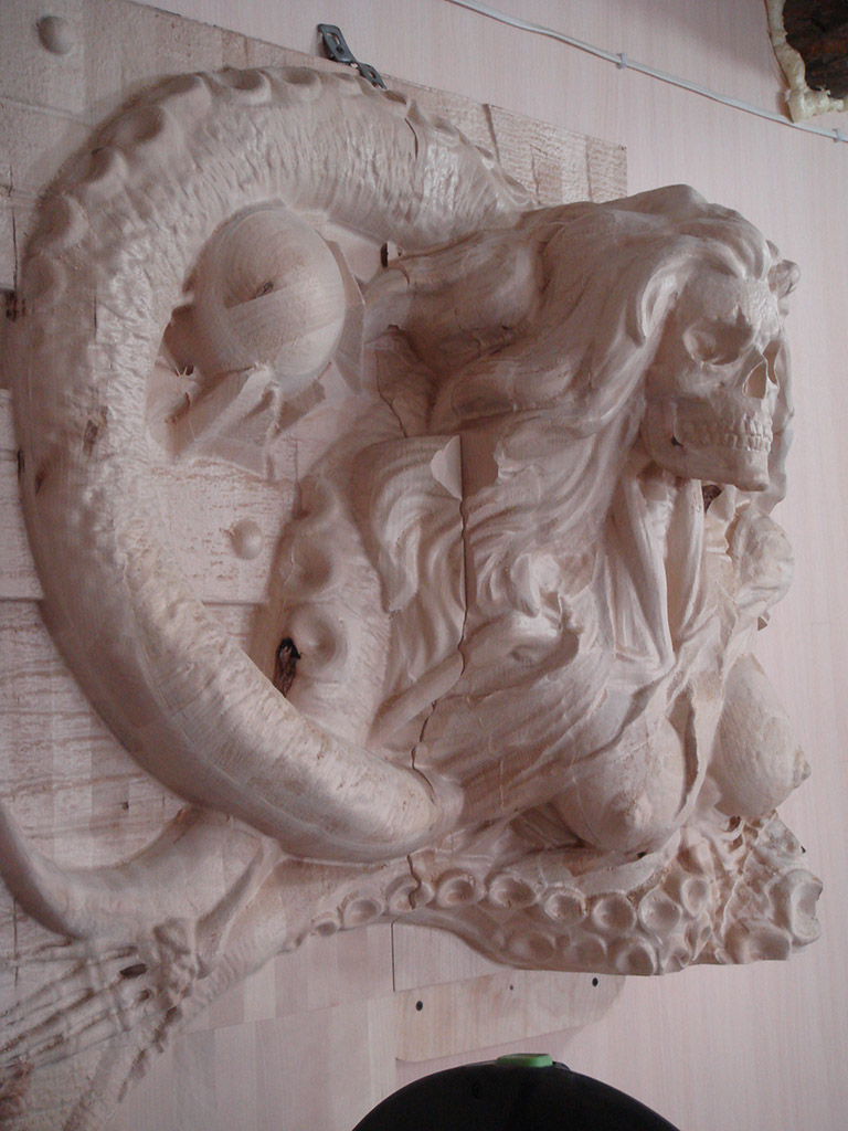

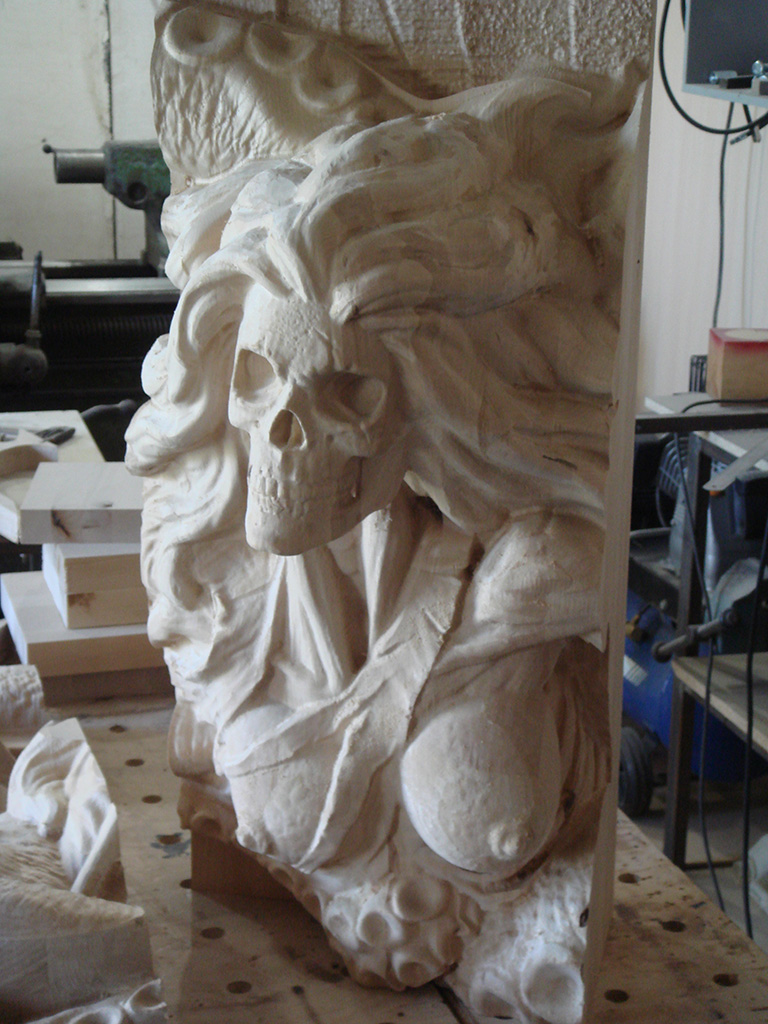

Awesome. May i ask, how did you mill the face? Do you have 5 axis CNC? Because i think, CNC’s mill only from one side of the material and the skull looks like as it was not done with a CNC.
Osiris128, thank you!
The model has been cut in ZBrush into two parts - the face and body. SliceCurve Brush.
Face mill separately. The body is mill separately. Then, the two parts are connected.

Thanks for replying Andrei. Do you have a 4 axis CNC or 5 axis CNC?
Sigmund Hentze, thank you.

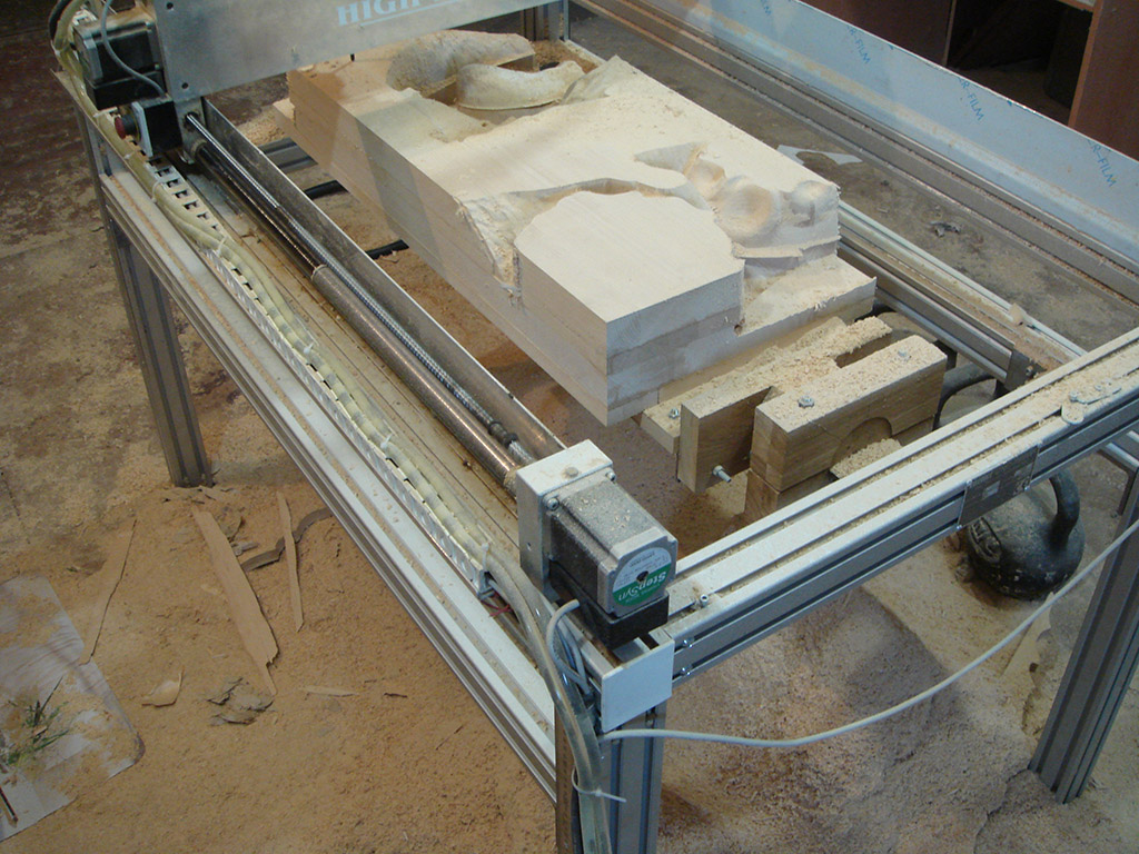

However, you can do it. The photo shows our CNC. 3-AXIS machine.
Osiris128, All this is done on a 3-axis CNC. This CNC is made in Germany.
As you can see this is a conventional CNC. Working area 1000x600 mm.
But the plane itself is not. Instead, we have collected a movable frame that moves up or down manually. This allows the dial thickness of the material. This frame is put a blank for a model that can be rotated 360 degrees. And you did it!
Of course, all this was made possible thanks to this wonderful program ZBRUSH!!!
