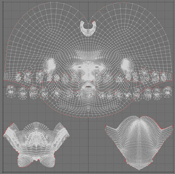

I took a head from Poser, saved it as an object file, imported it into Lightwave to remove some unwanted objects it contained, (eyelashes and eyeballs.) I brought it into Zbrush, clicked the AUVtiles button then started sculpting. I divided to the 4th subdivision level to get the detail close to what I wanted then went into projection master and started painting. Everything looked great. Then they were well not gone comepletely but very pixleated some displacement was gone too.

Hey Steve,
Sounds as if the resolution of the texture you’re creating is too small. Here is the workflow I use when applying the Adaptive UV’s…hope it helps :).
After importing your mesh, create a new texture for it by going texture menu bar & selecting new. Be sure to change the size of the texture first. Make it either 2048x2048 or 4096x4096 depending on your needs. Then go to Tools/Textures/AUVTiles. Now you can subdivide to which ever level you need and also go into PM to paint some textures.
