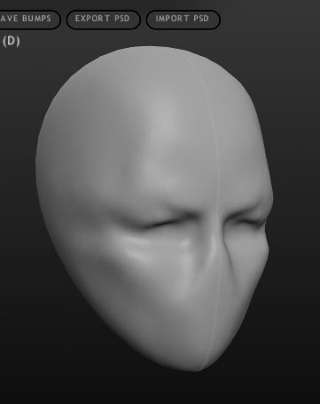

First I took a basic model into paint. Just above the model, you can see the “EXPORT PSD” button (which you can drop down by hitting the “Show advanced tools” button just below Brush and Texture boxes).

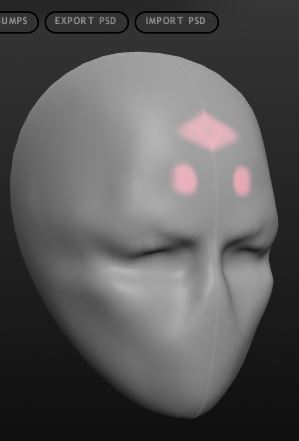

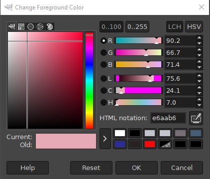

Opening that file in Gimp, I painted something a bit different on both sides to get a better idea of which side you might want to focus on just in case there was a difference on import. Just find your color and spray it on the “Paint” layer (for this example, I used the html color you had from above). Once done, export the PSD.

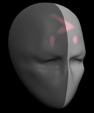

And it seems that you should focus on the lighter side to paint on, which is noticeable once you import PSD.

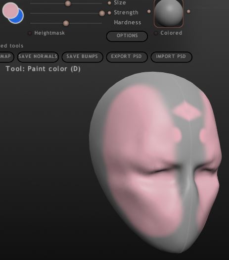

Holding the “C” button and Left clicking on the color, I then used that to airbrush onto the model. So it can work for what you were trying to do.
