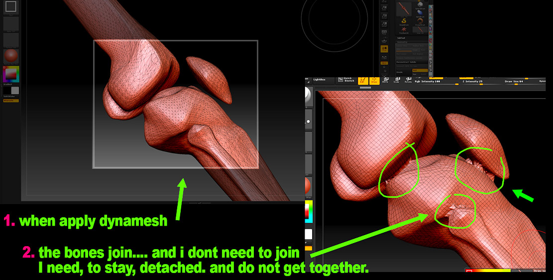

when i use dynamesh … there are very close meshes, which end up joining.
How I can avoid this ?
i attach here a picture to explain.
thansk , any help will be apreciate so mush.

assign auto groups and then make sure you have groups turned on when you use dynamesh.
More so. Why are you using dynamesh anyway? That looks like a job for Zremesher.

i use dynamesh because need to close some bone holes
then Zremesh.

is there a rule to when use dynamys inted of zremesh and viceversa please ?
i mean , when use dynamesh and when use zremesh please ?
thansk a lot !
Dynamesh is good for sculpting and playing with forms, but comes at the cost of no subD levels and is fairly dense and tends to weld things together, even at high resolutions.
Zremesher is good for just getting you new topology that’s fairly low resolution and can be great for working with tradtional subD levels
