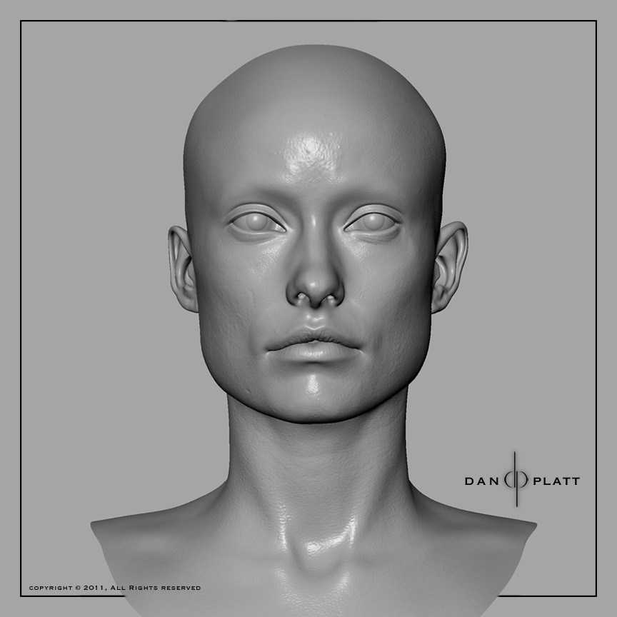

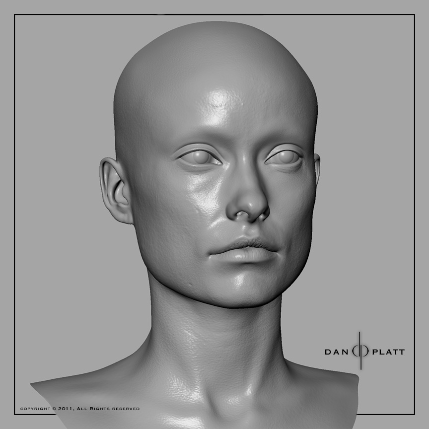

Hello Hugo - I recalled coming across these last year when seeing your work here. Hope they can be of use for your portrait.
These are by Dan Platt from working on the VFX for Tron - they are from his site. If I recall they are touched up from actual scans.
Happy sculpting! Keep it up :slight_smile:

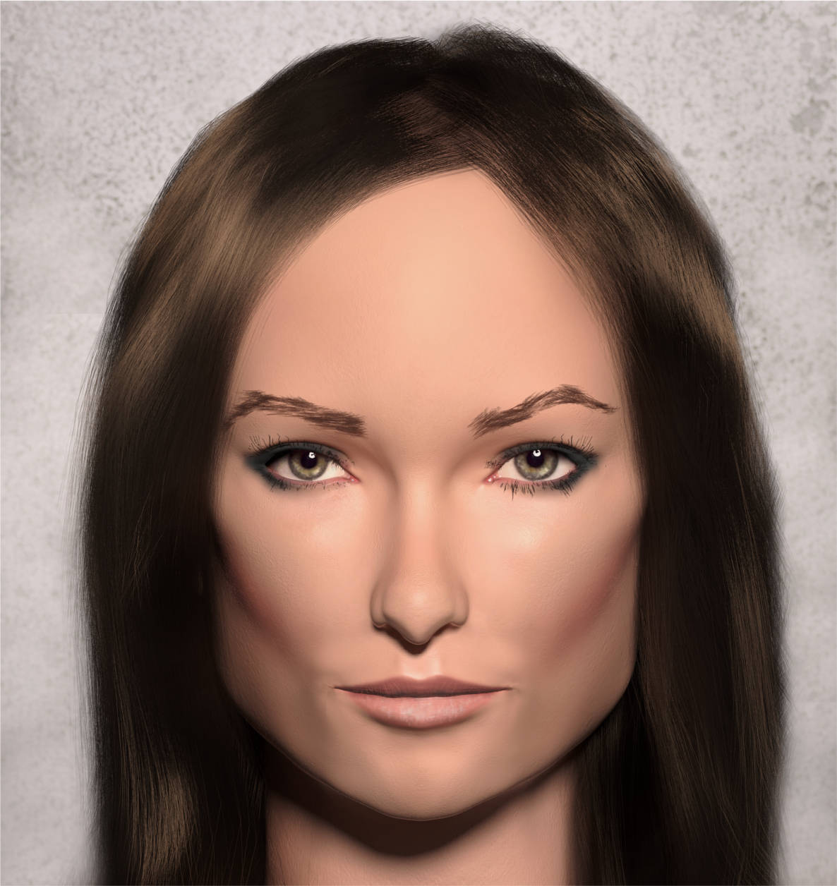

This is my last post on this thread.
Thank you for the feedback everyone and I hope you like the finish result.
Here is a high resolution render : http://i44.photobucket.com/albums/f16/hugoalcaide/ESCULTURA694_zpse7beed72.png
Well done. You should post a side-by-side comparison of your first post, and the final render you just posted. Amazing progress.
