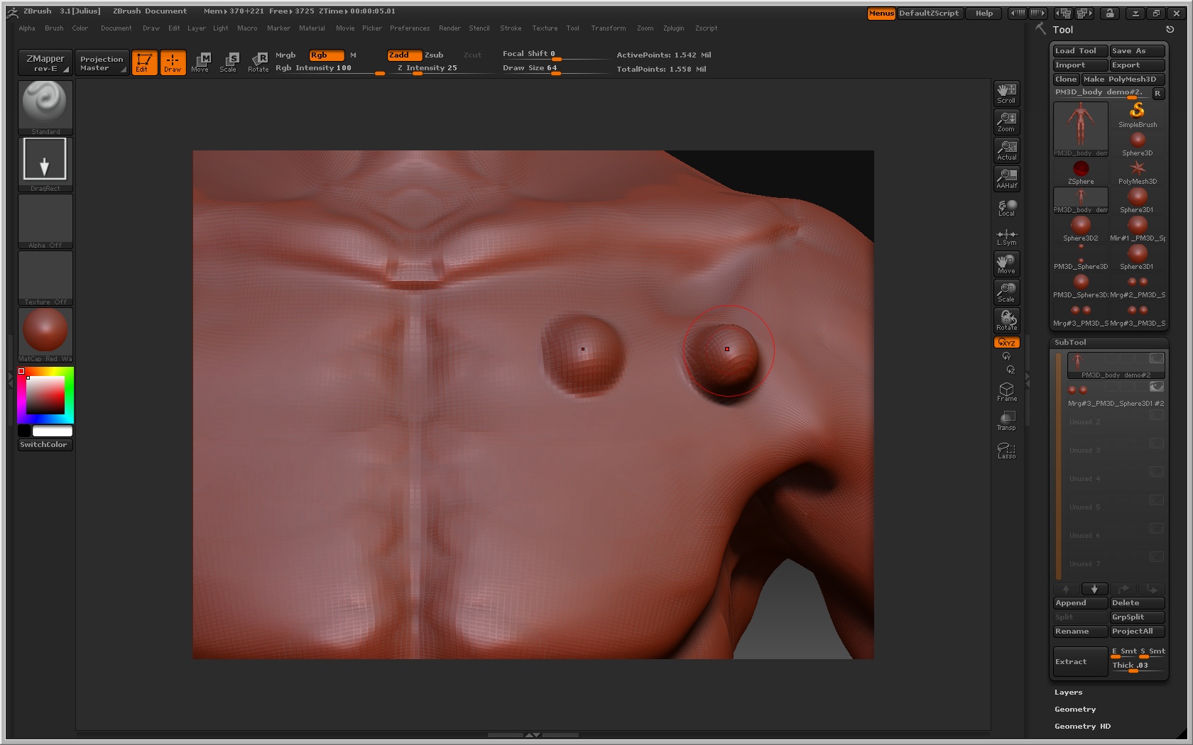

i don’t know how but every time i make eye’s model off centered so now i cant use symmetry any one know what i did wrong? please help look at the pic carefully

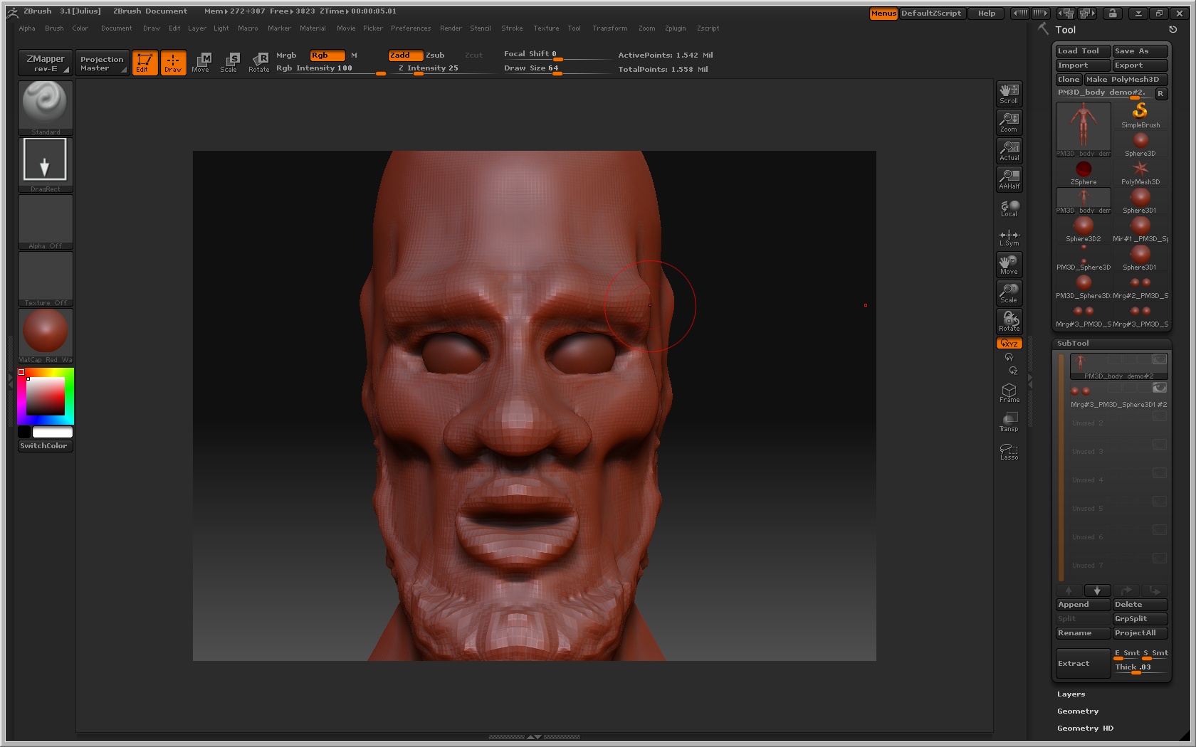

here is what happens when i try working on the face
apply a unify deformation to the body. That will center it and size it to work best within Zbrush.
You can also set the pivot point to center inside the transform palette on the top. C pivot will center it based on the geometry, S pivot will put it back when you’re done sculpting.
